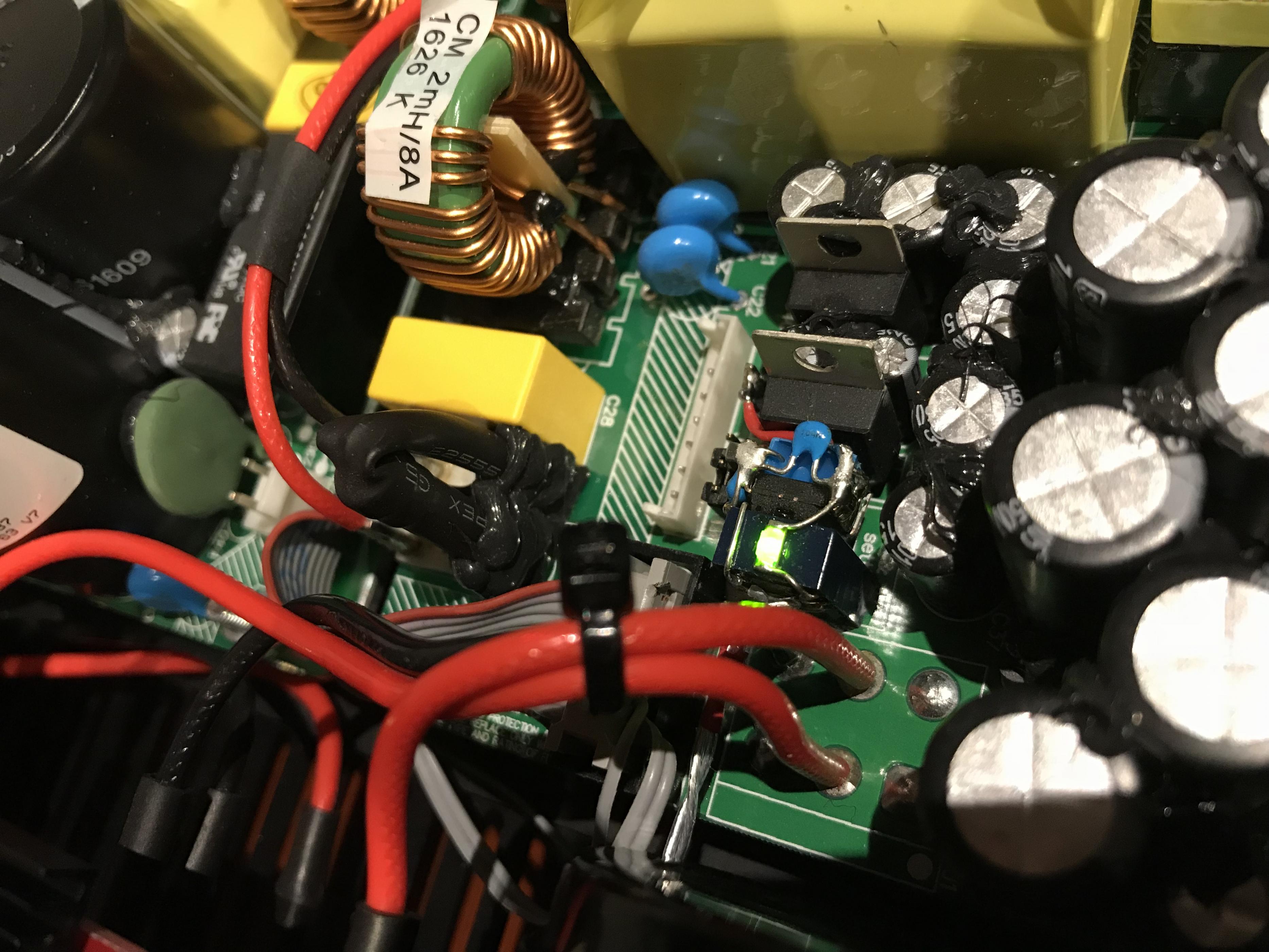

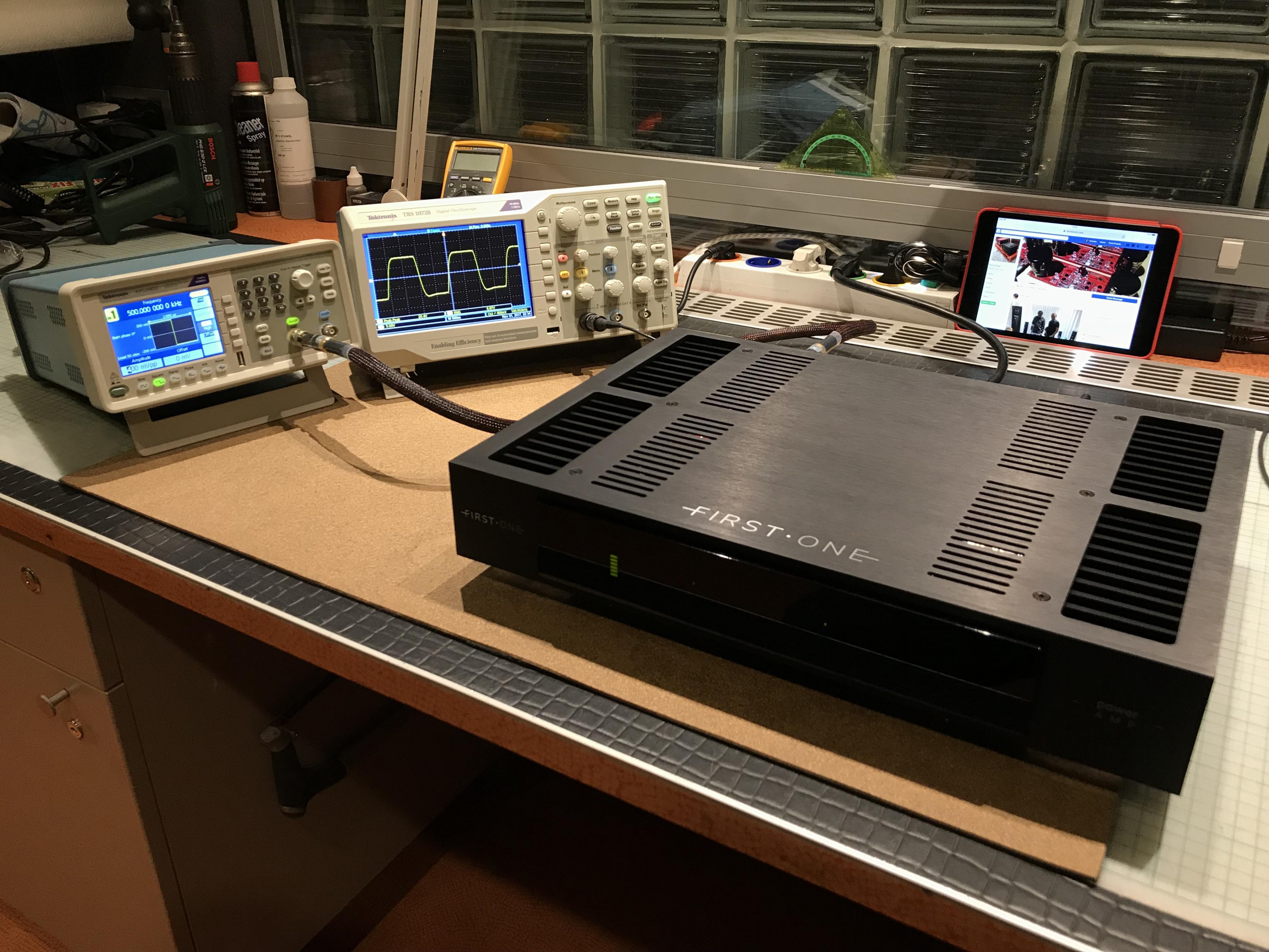

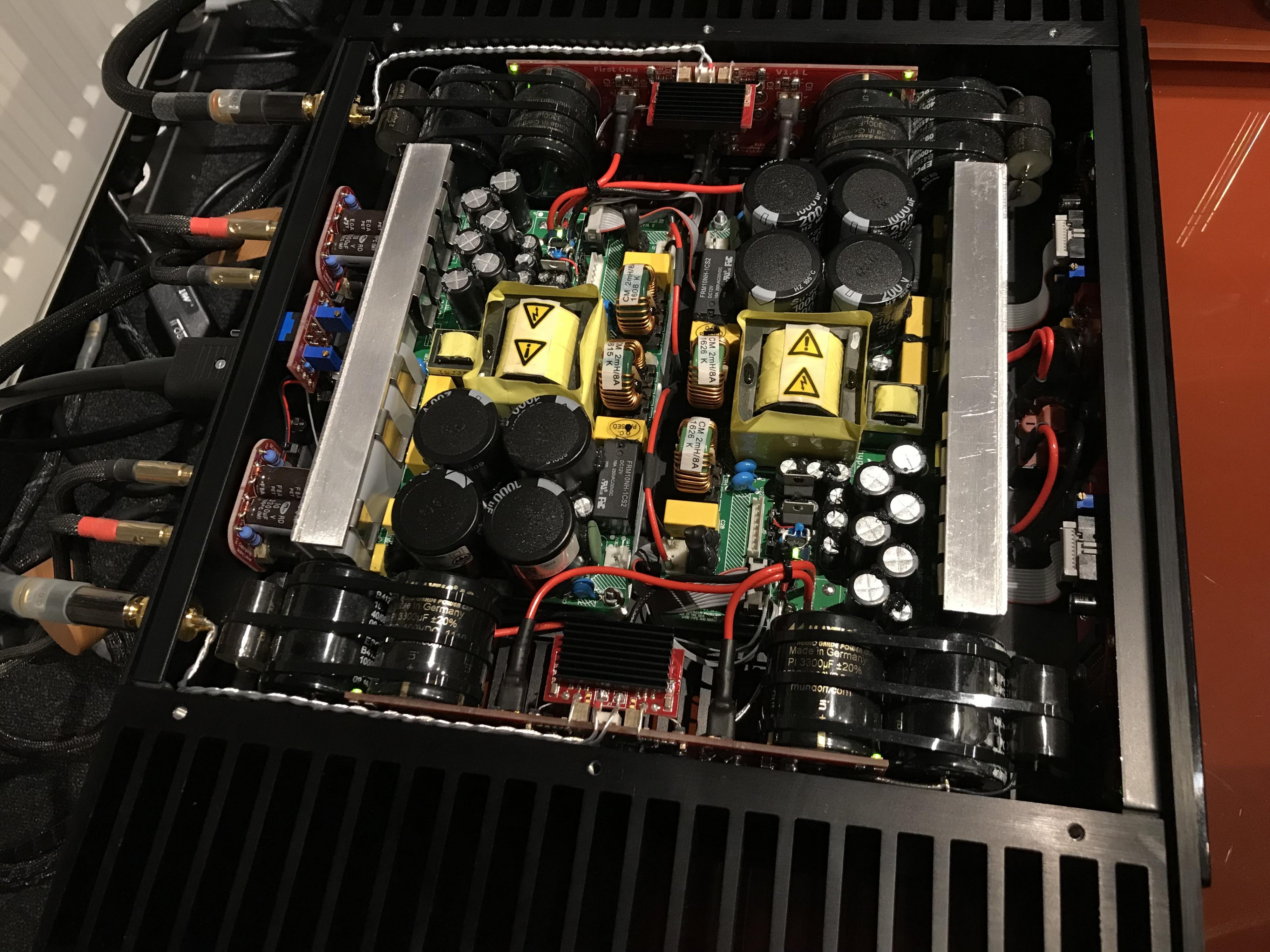

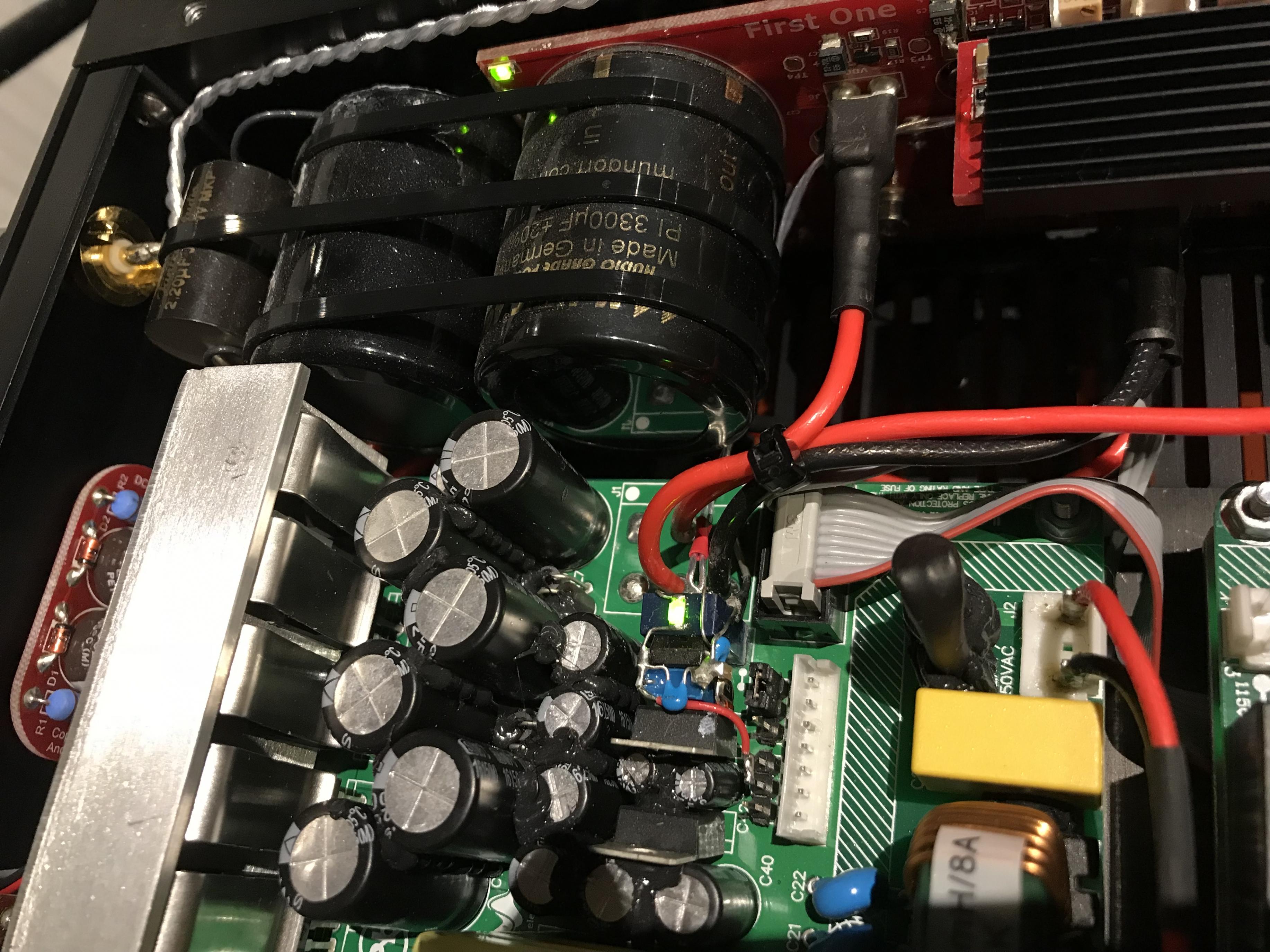

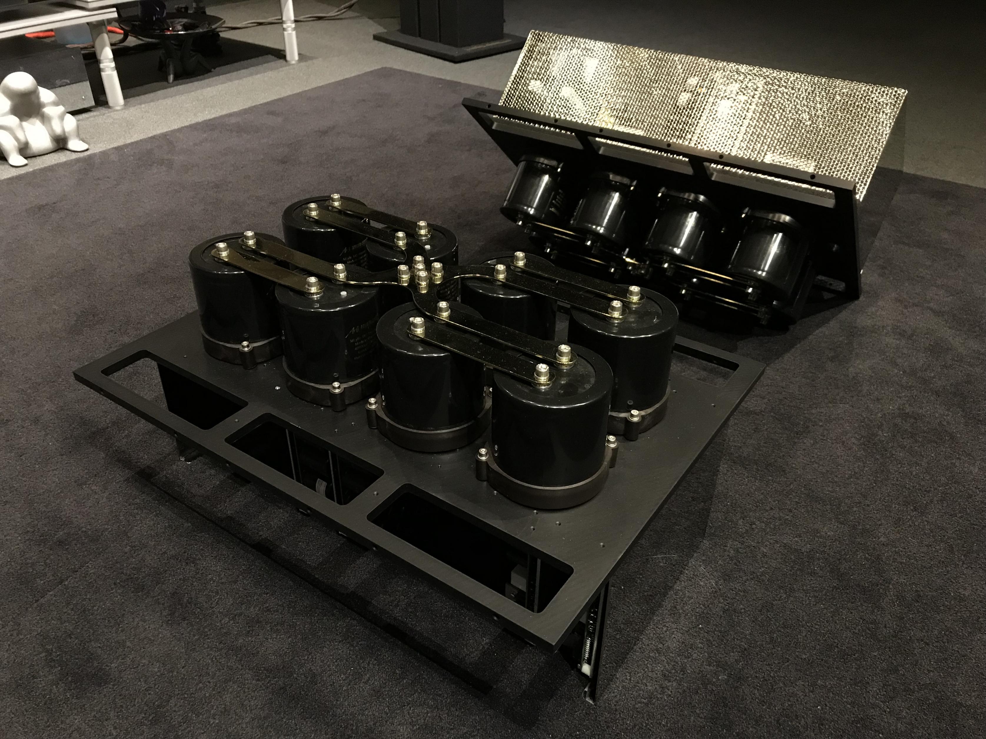

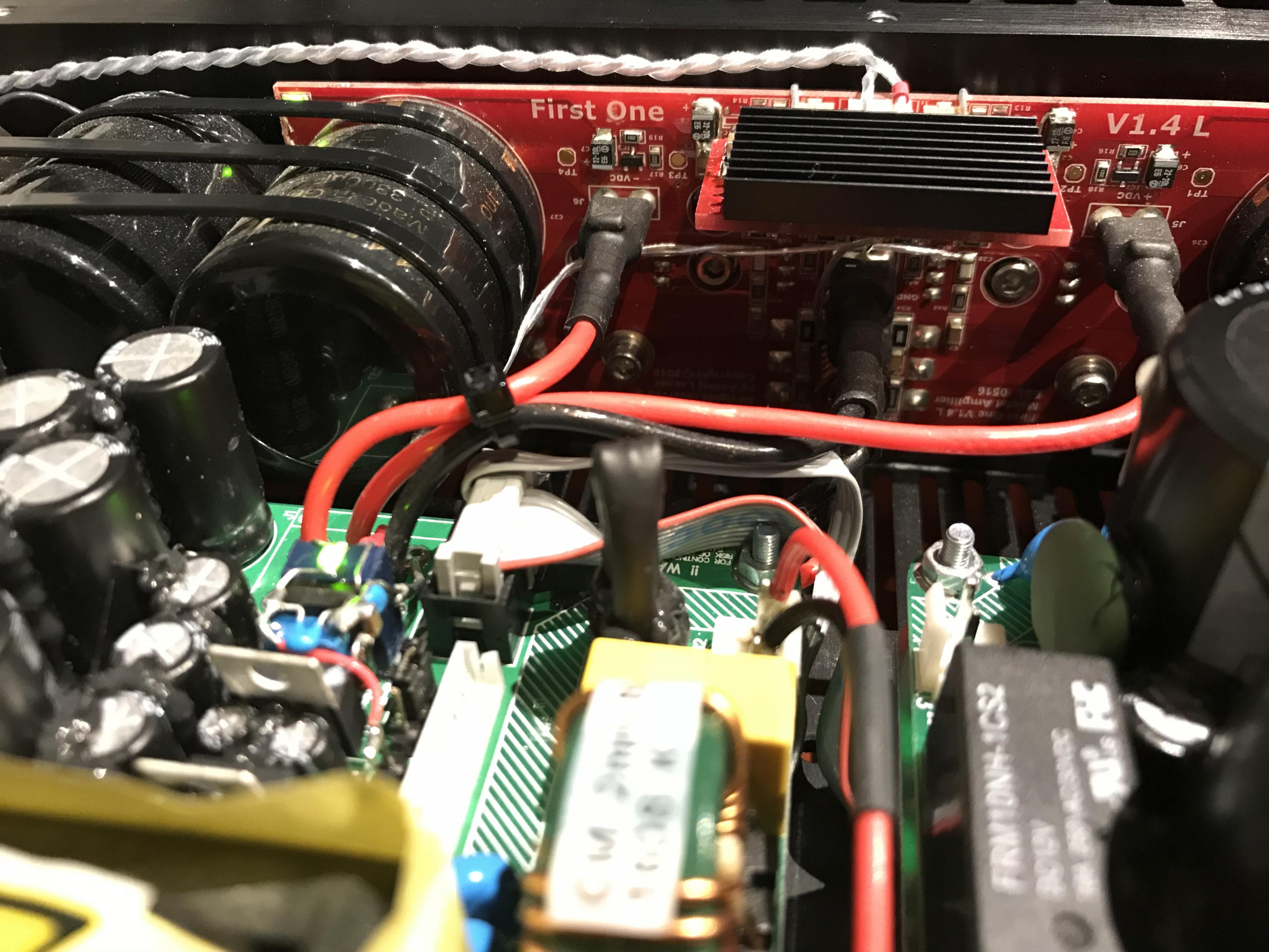

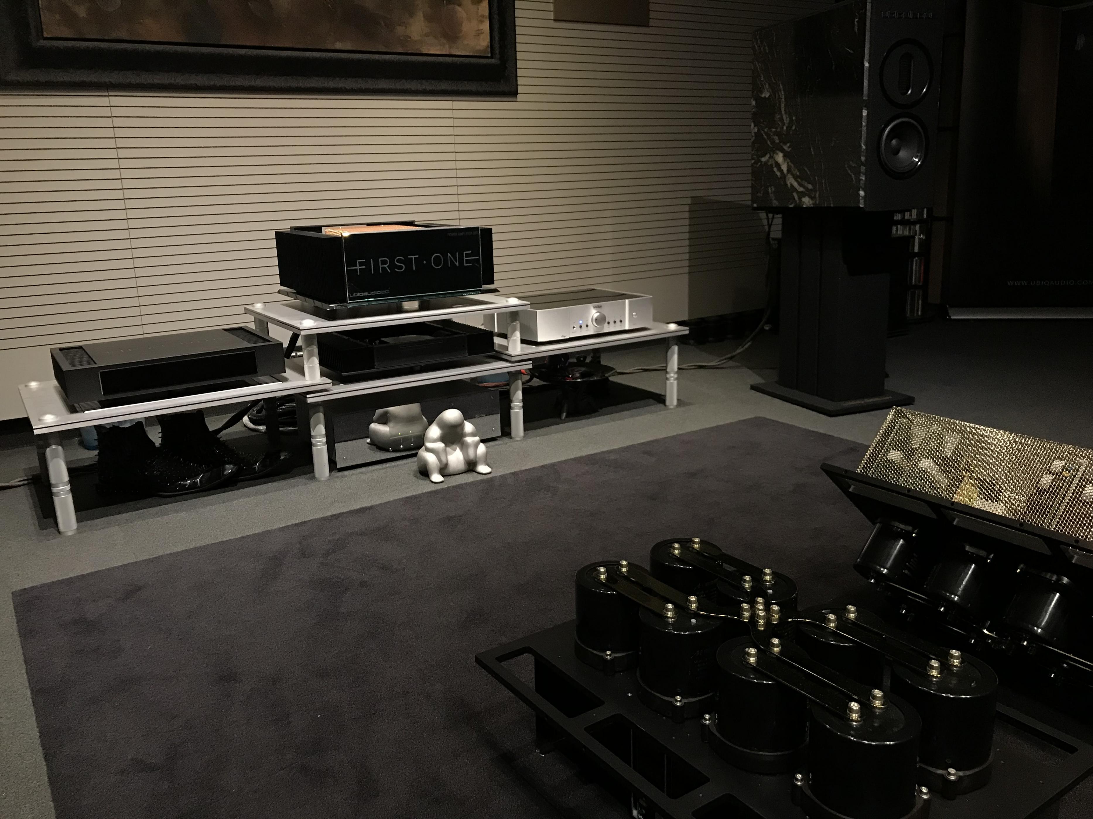

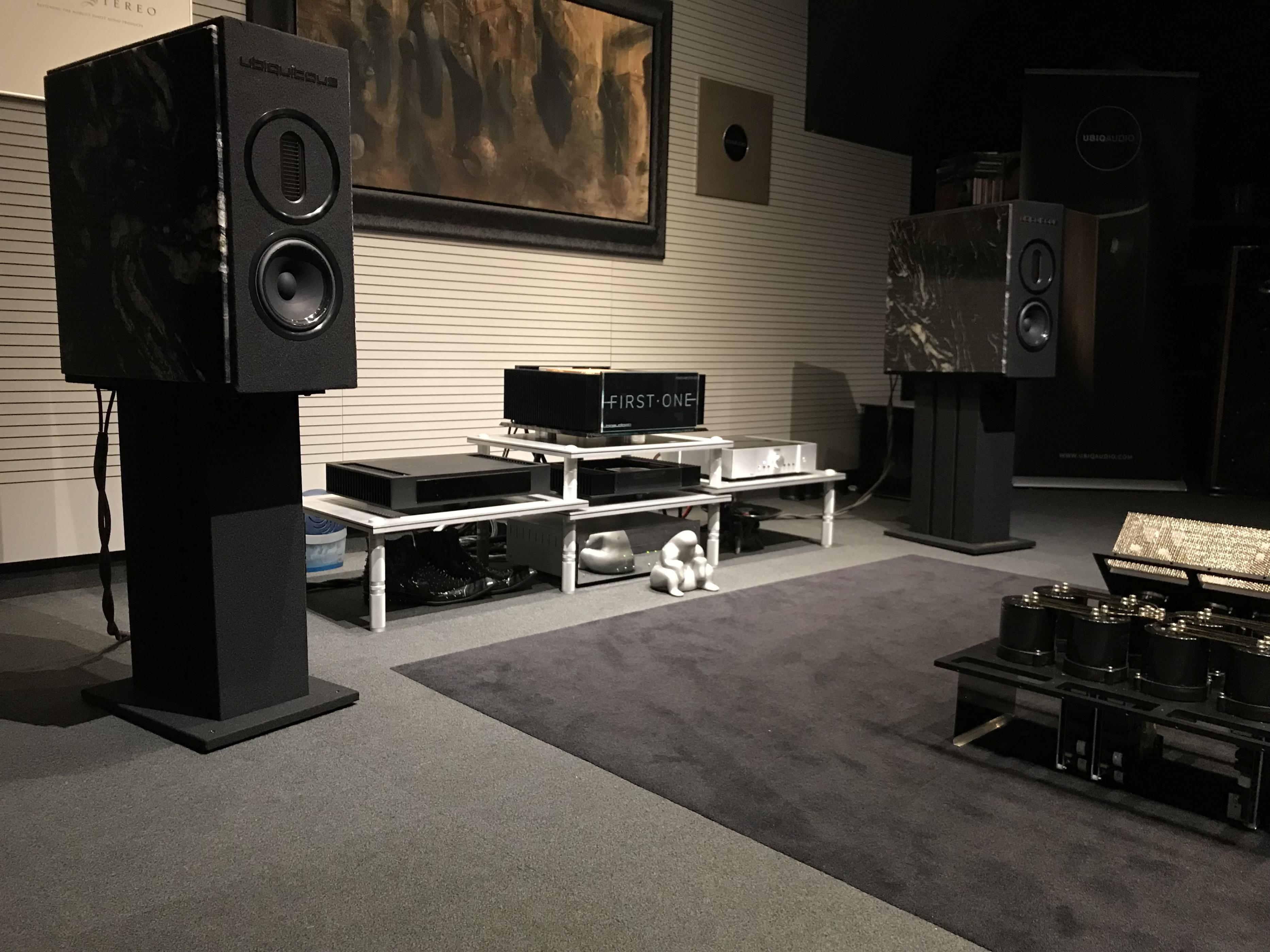

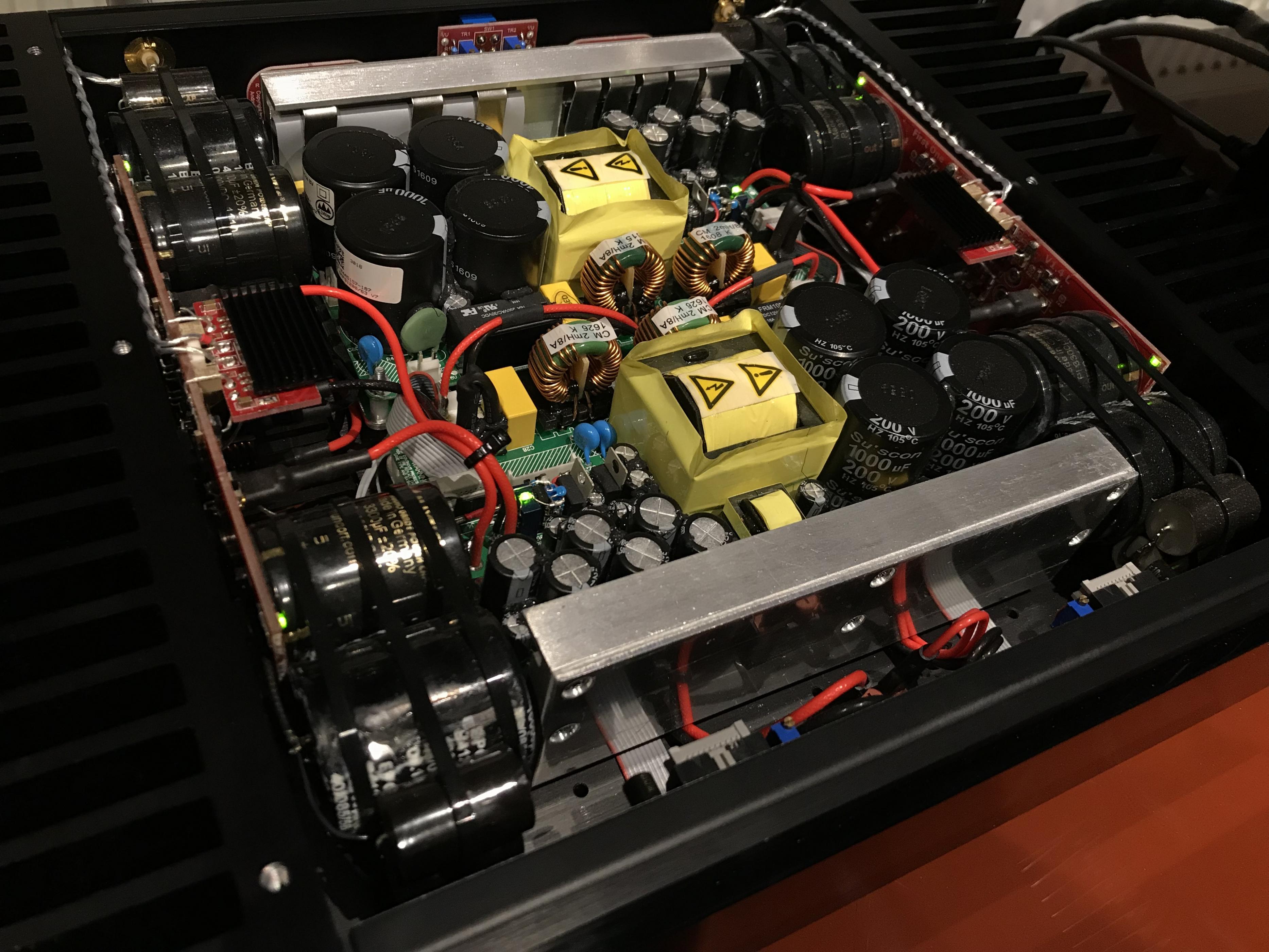

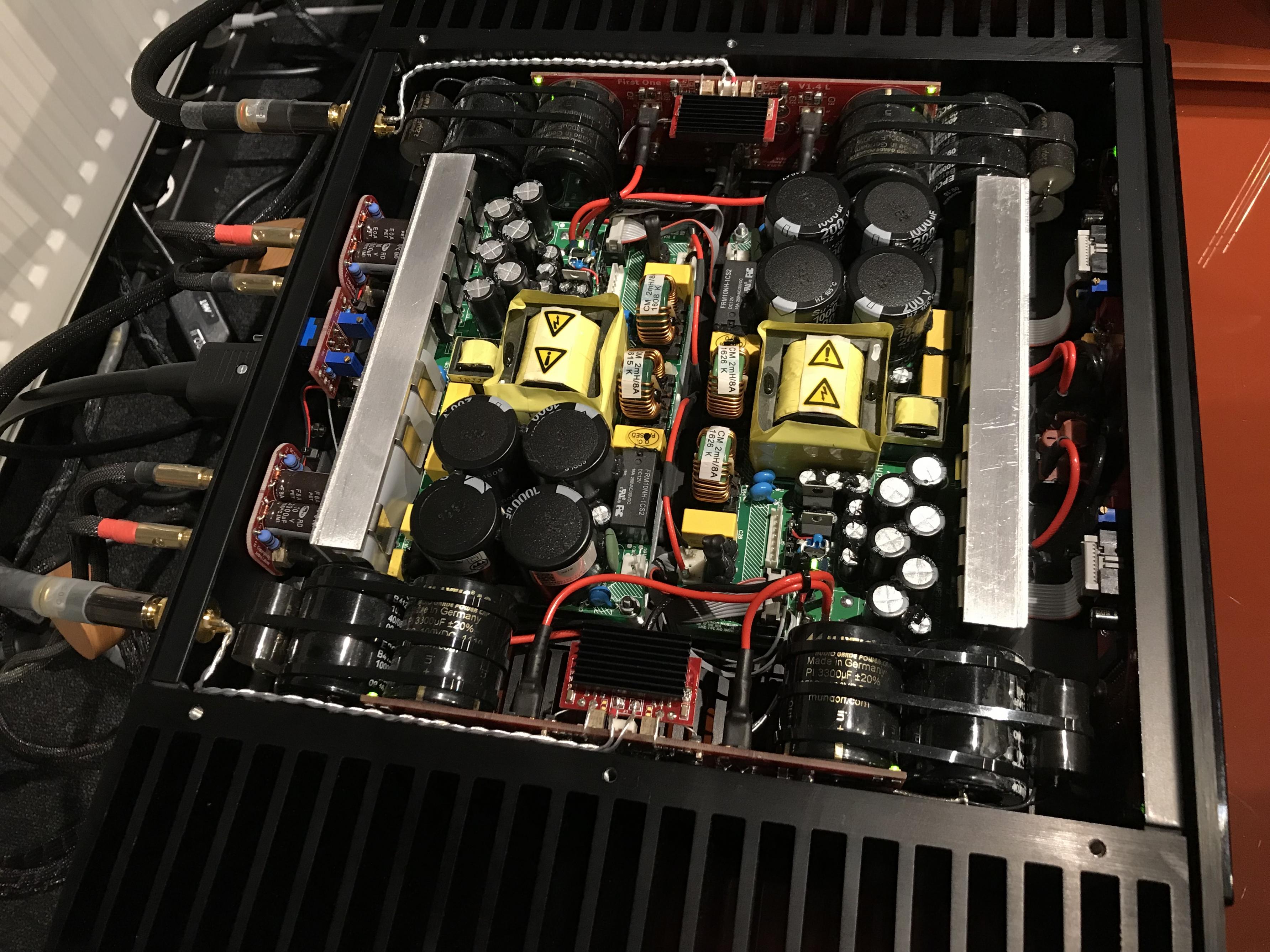

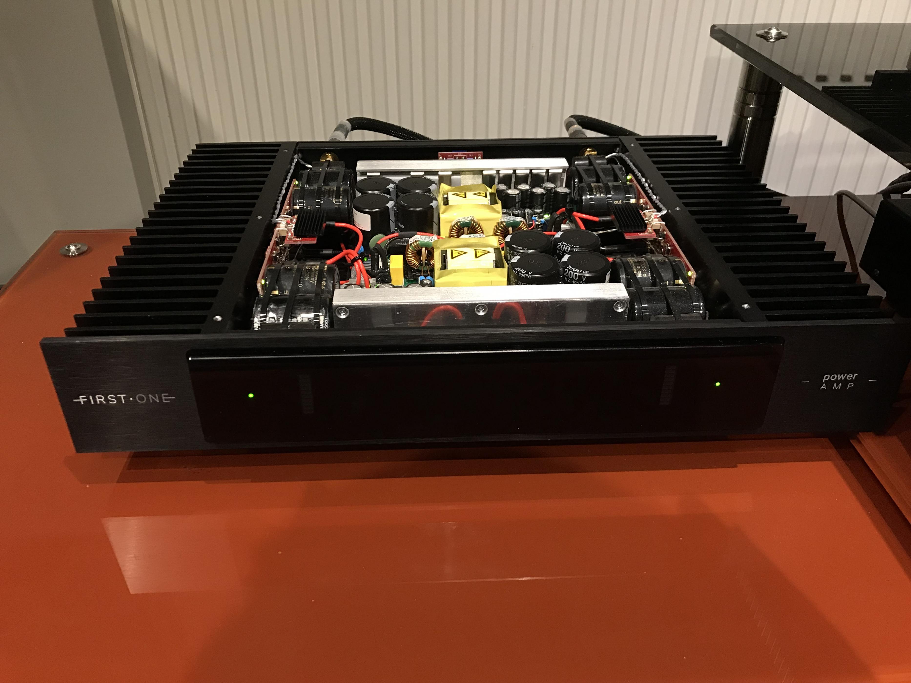

First One prototype built in 2016, upgrades performed till the end of 2017. Took few images before it left the building and went to a new home in Hungary. It serves us well, enabling us learning process and progress all the way the end of 2018 when new modules go into production. Yes, tomorrow few hundred PCB-s will start new life cycle. Thanks to the amp bellow.
First One power amplifier, preamp DAC & MAAT loudspeakers
