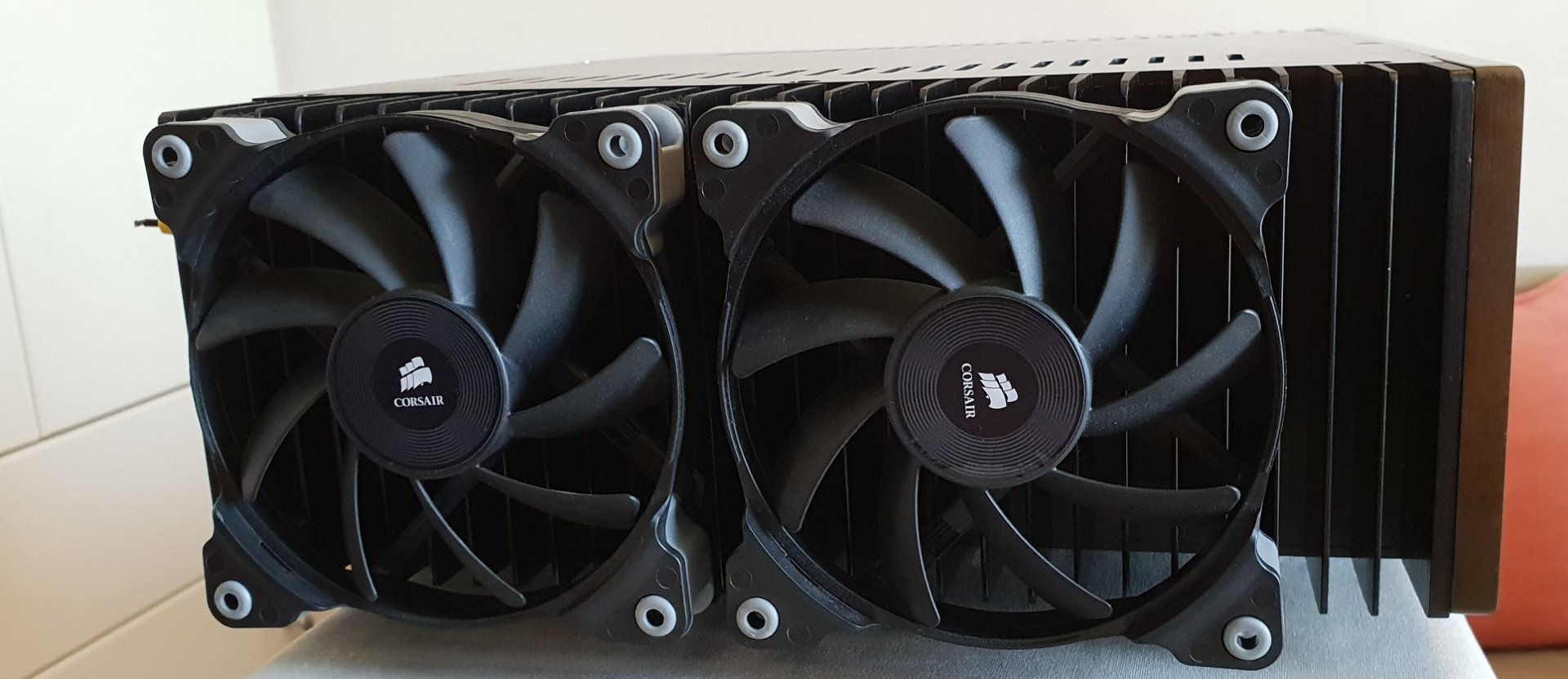

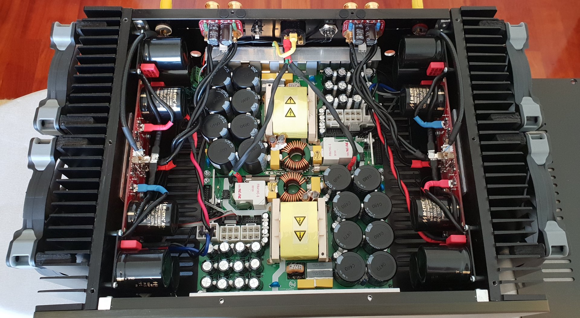

And some photos of my enclosure.
Comments please ....

May-be not a so good idea, as it will change in a brutal way the temperature inside the box, so, directly affect both quiescent current and, depending of the air flux, the offset.Looks great but I would put the fans under the box 😉 maybe halfway inside/outside,
Not so if your fan control is "intelligent", and you get the added benefit of increasing your expensive PS's life also. 😉
Because convective cooling is more efficient this way, you can set the fan output (noise) lower...
M.
You should be right, BUT...Not so if your fan control is "intelligent", and you get the added benefit of increasing your expensive PS's life also. 😉
You cannot control the air flows inside your enclosure. They can be highly different for the two input transistors, and so, increase the offset.
Concerning the quiescent current, you know how long you have to wait for your amps are temp stabilized before to adjust-it.
Concerning the PS, the only parts that wear are the Elcaps. 10-20 years, such a big deal ?
The only thing that I dislike is the cooler of the Hypex SMPS. Those far to be optimal horizontal fins.
