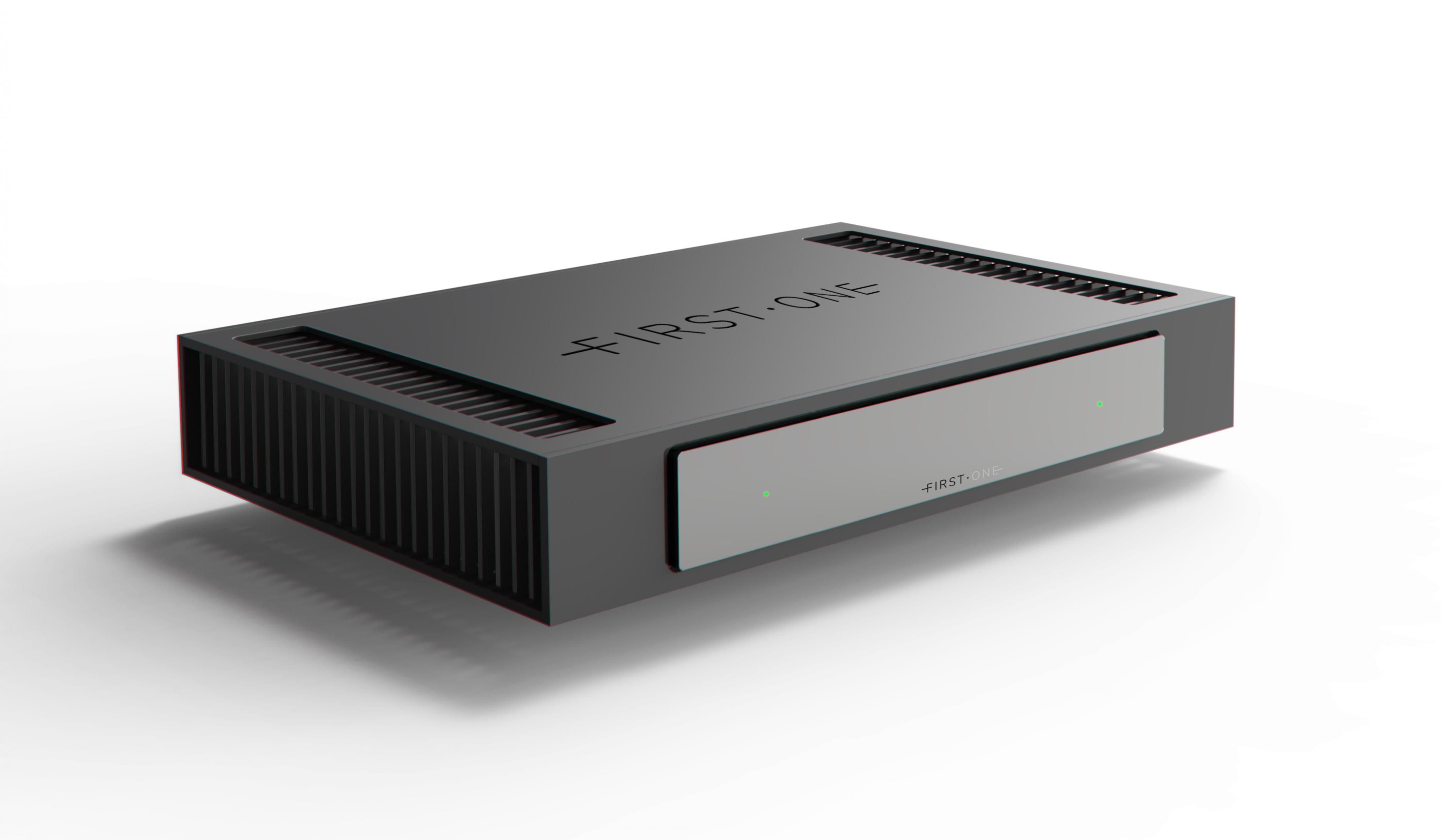

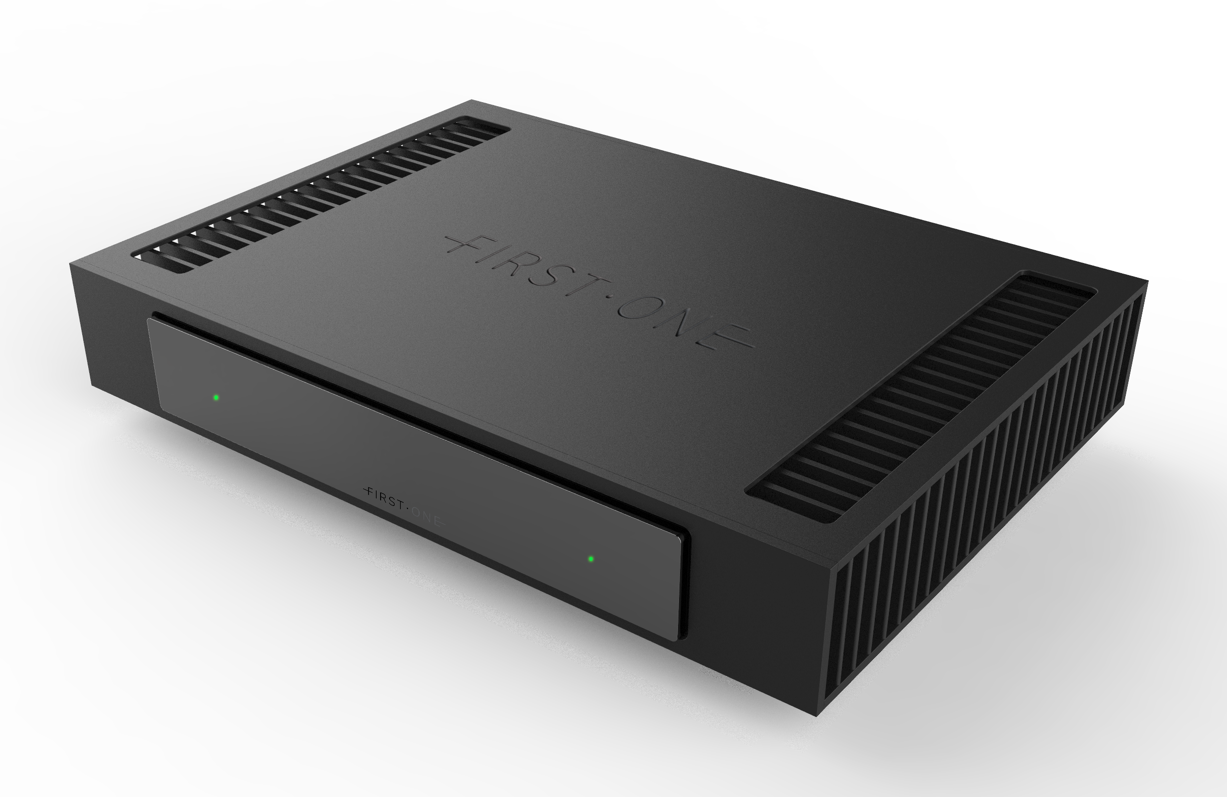

Something for your friends, not so well experienced in DIY electronics, to consider maybe. 😉
First One power amplifier by Ubiqu audio
Nice! Does this mean we are getting closer to new M modules DIY edition release?😀
PCB production already in progress, among them also the First One module intended for DIY use, which is in the former M size with one pair of output mosfets.
Setting the whole new level of quality takes time, perfection isn't easy to achieve, especially in respect to competitive designs nowadays present in high-end industry. The essence of what it will be offered to the customers in ready made product range will always be available in module form too, so anyone could get first hand impression in affordable way.

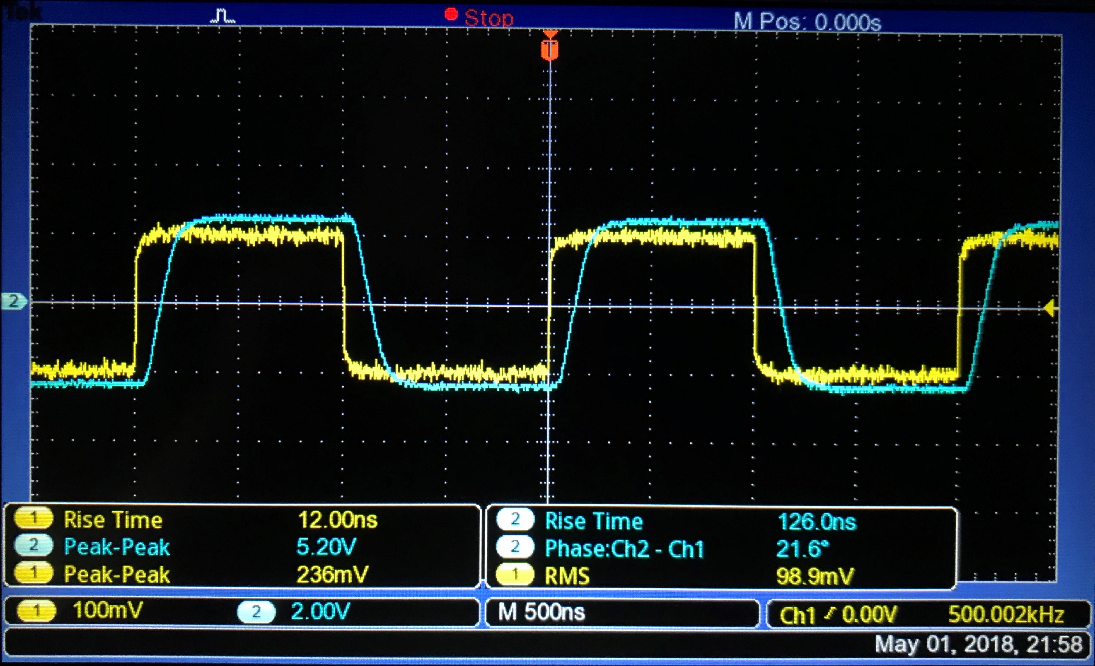

Module's measurement at 500 kHz square on 4 Ohm load attached.
