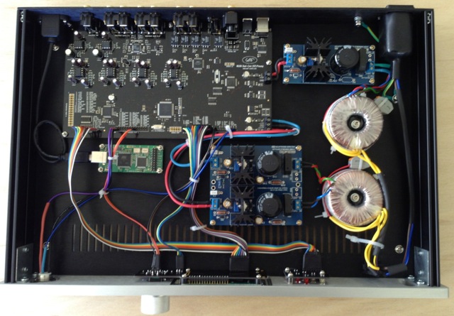

I hope this doesn't pollute the thread too much but it may help other's if they encounter similar problems with multi amp setups.
Neither would do.
I can see why they would not be the ideal solution. Can you explain why they won't do?😕
to connect output GND wire from active crossover to central SMPS GND and all +IN wires to each amp channel. No GND wire to any input pad of FO modules whatsoever to avoid GND loops.
I thought that by connecting the SMPS ground to one single cable shield I was connecting the output signal ground from the active crossover to the amps main ground point.
I would not also connect this to the input pad on the first one. There would then be one direct connection between SMPS ground in the amp and output signal ground on the active crossover. I would then make sure the interconnects only has the positive input signal as you say
If this isn't what you are describing then I think I am misunderstanding what you mean by output ground😕

1. I could leave only one signal ground connection in the interconnects instead of having four separate ones as now.
2. I could connect smps ground to the screen of one interconnect and remove the screen/ground connections from all other interconnects.
Explanation why neither would do:
1. Not a good practice since FO channels wouldn't have equal GND path/resistance. Avoid GND connections via shielding of a cable (RFI antenna, low-pass filter effect, etc.), rather use solid core wire from reference GND point of an active crossover to GND reference point of an amp's SMPS, by this way you'll form the most direct GND to GND low Z connection.
2. Again no symmetry for FO amps, different GND paths - interference curents may appear

LC thanks for the info and I see what you mean. I was hoping for a solution that would not involve having to work on the chassis but it seems that won't be possible.
I can add a connector of some sort to the back panel of each chassis so the grounds can be connected directly with a solid or thicker gauge wire.
I have attached a picture of the insides of the crossover. There is a 5V and +/-12V power supply. The 5V is mainly for the digital components and the 12V is mainly for the opamps on the output buffers. I would imagine that either of these power ground points where they attach to the main black board would be the best place to join the ground from the smps?

OK since an active crossover is in the other chassis, solution is to connect all GND points of input RCA connectors in amp chassis together and lead only one wire to central GND of amp's SMPS. Positive wires from input RCA to + IN pad of each channel. 😉
