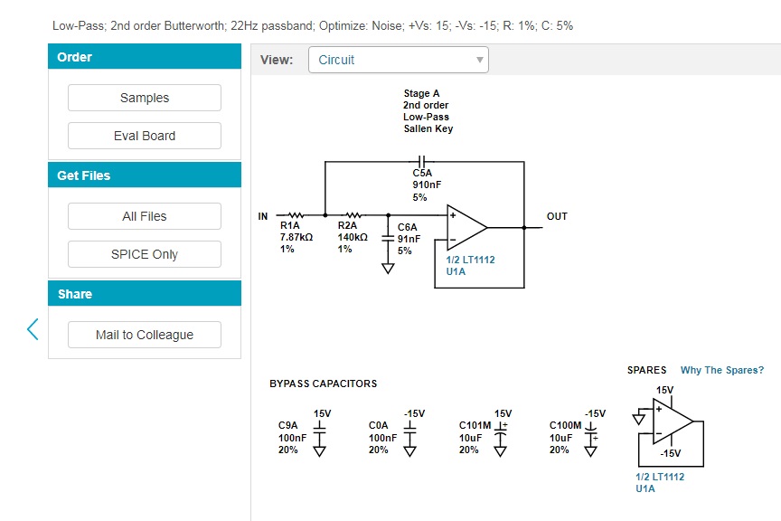

Quick filter sim! The "spare" op-amp can be used as an input buffer.

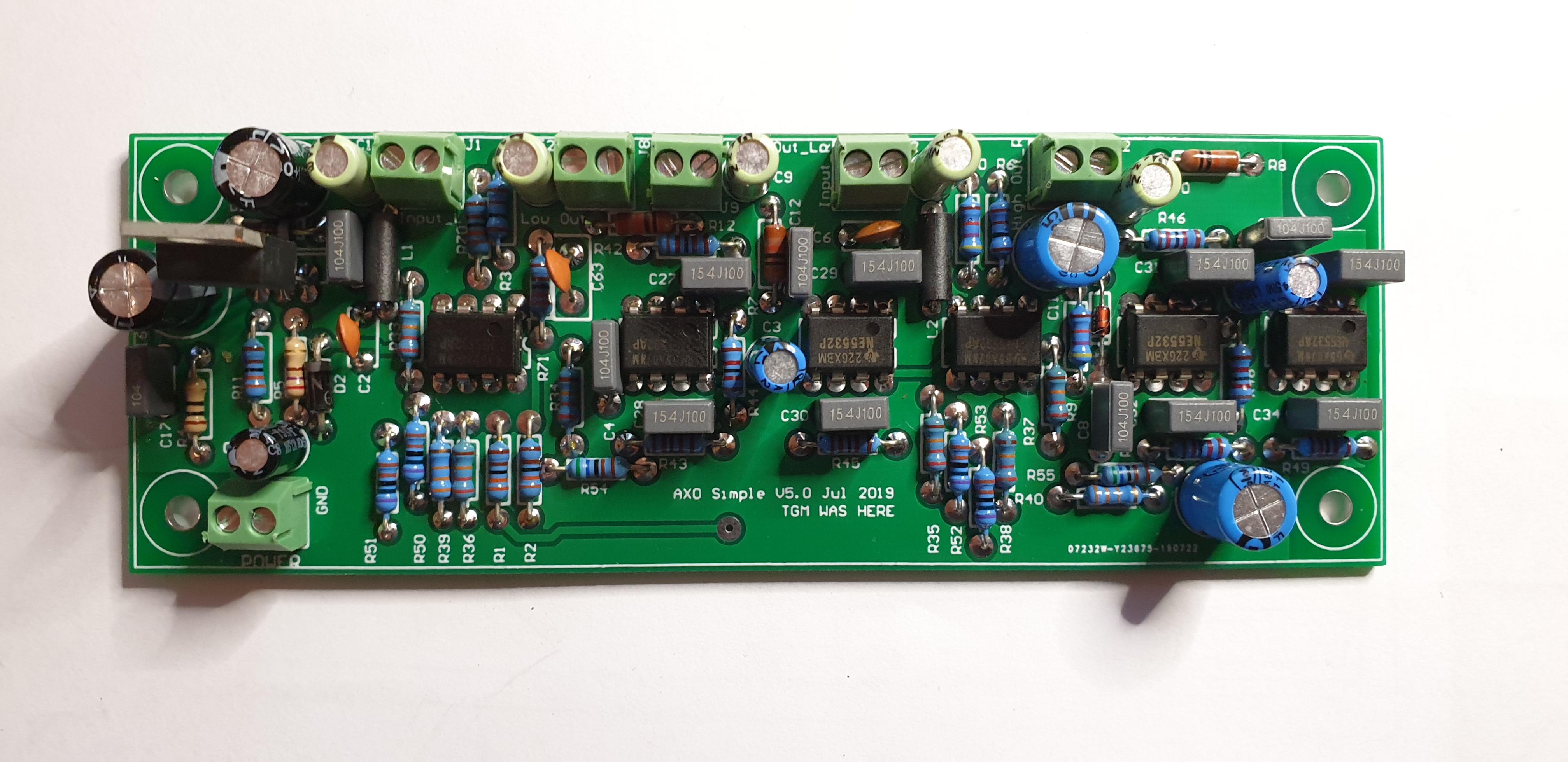

I often use a state variable filter. The one attached was done for a single rail application so uses a virtual earth - but works equally well in a dual rail application.
Sheet 1 has a stereo pair of filters.
View attachment AXO Sheet 1.pdf
The frequency is set by R42, 43, 44, 45 / C27, 28, 29 and 30
Freq = 1/(2 * pi * R * C)
20Hz would require C = 560 or 680nF and 12K resistor or similar scaling, eg 150nF and 48K (might get a little noisier due to high R). Mind you, 20Hz is unlikely to actually deliver any usable output... this will all be subsonic and much better at breaking drivers than delivering audible output. Especially with a 4th order XO.

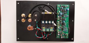

this can be implemented as:
Fascinating circuit. Thanks for sharing. I started reading up on this type of circuit after your post to make sense of it.
Some questions: Is that other board a switch mode power supply or a Class D amp?
What's the purpose of the input inductor series with capacitor? Bandwidth control?
Finally, are the 4 1st order filters better than running two x 2nd order filters with a regular filter?
Finally, what do you suggest I use to simulate circuits for free? I used to use Tina-Ti which was pretty easy but limited to their chips
The other board is a class D amp.
The inductor is just there to help reduce any RF interference. It is a bead inductor. Omitting it is no big deal, it is just "belts and braces" protection.
This is not really four first order filters as they live in a feedback loop. I would not say "better" or "worse" just different. This circuit neatly delivers high low and bandpass outputs which I find handy.

I don't often simulate. I have used LTSPICE recently, and in fact stuck this circuit in there to convince myself that the standard resistor values I have plugged in are OK and don't impact on the system performance. I am so far from a SPICE expert it isn't funny, and usually do an awful lot of swearing and cursing before I get a simulation running.
I find with things like standard filters etc, simulation will rarely tell yo much that you don't already know. (but asking "will shifting these resistor values +/-10% screw up the response IS worth simulating).
