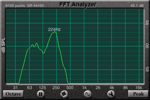

Despite that an IPhone would not be my first recommendation as for a reliable measurement device - why exactly do you want to down shift upper frequency slope of the woofer?

I want to lower the upper frequencies to minimize H-frame quarterwave.
That measurement was done 1m from the woofers, I also measured from 1.5m. Got a 3dB rise between 170-250Hz... So if I lower the crossover point I may get rid of the rising.

I'm using 2nd order filter for both woofer and FR. Just took a relook at the measurement, the woofers starts to fall at 250 and have lost 3dB at 300Hz(?)
FR: 22uF / 3.9mH (+ L-pad circuit ~2.5dB)
Woofer: 4.7mH / 150uF
According to MJK the crossover for the woofers in an H-frame would have 125Hz crosspoint. which would mean that I must double up the coil size, right?

I am not understand very well because I suppose you have made the H-FRAME in the MJK paper with the same dimension but taller ?
I understand in this paper, the response of the H Frame is obtained with an electrical crossover LR2 - 125Hz. It gets a flat response with a crossover frequency near 350Hz -6dB. Acoustically it's a LR4 slope.
This means electrically LR2 125Hz for 4ohms speaker L=10mH C=160uF~150uF
Yes you are far from the good value for the inductance.
I think you need the MJK worksheet or good measurements to make the precise calculations because the online calculator doesn't take into account the actual impedance and the actual response.

Yes I done the H-frame according to MJK worksheet, but the double height.
(40x40x80cm inner size).
I missed what crossover he recommended for H-frame when I read the document, so I just made an 4ohm version of his Dipole crossover. But, I later read the H/U-frame document again saw that he recommended 125Hz instead when building H-frame.
