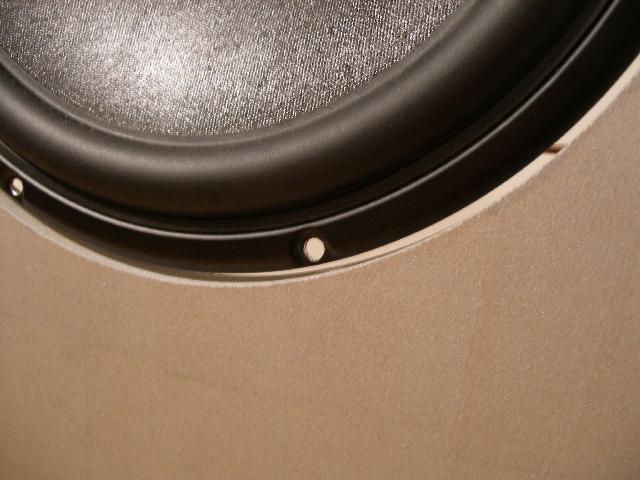

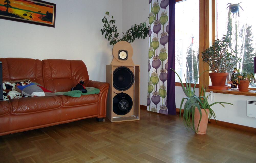

Hi all,
I've just put together a 2-way OB speaker with 2xAlpha15a + Fostex FR166En per side with some help from this thread: What fullrange for OB?

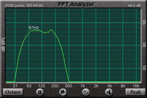

I've done a measurement on the woofers, they play up to about 250Hz (12dB/oct filter), when I measured from 1m I got a 3dB resonance between ~200-250Hz. But since I only have iPhone to measure the speakers the response aren't to accurate.
I've tried to burn/play in the woofers with 20Hz sinus tones with the woofer out of phase and I already here some improvements. So now I only has to burn in the FR aswell...
The crossover for the speaker are:
Alpha 15a: 4.7mH and 150uF (12dB/oct)
Fostex: 68uF and 3.9mH with L-pad -2.5dB
Must say it sound awesome! Even thou I going to tweak the crossover, the cabinet and much it looks really promising! My main task now is to lower the frame-vibrations, the FR vibrates to much at the moment. When I placed a "hifi mouse" (to suck up all vibrations) the sound improved alot.
what do you fellas think of the build so far? Any suggestions how to eliminate the vibrations?

looks nice
"Free" edges always vibrate
regarding your FR baffle vibrations, you could try with one or two wooden sticks
connecting the free vibrating top to top of woofer frame
and I might try with foam inside the H-frame
and I might fill inside corners with wood
and ditto between woofers
wood would be triangles
ra7
Joined 2009
Good work man.
Magnet mount the FR driver and keep that section independent of the woofers. The other way would be to just separate the baffle of the FR from the woofers. Keeping them independent of each other would rid you of the vibrations.
looks nice
I got some foam so I might try that, and i'll check if I got wood enough to place in the corners! thanks!
Good work man.
yeah, maybe it's best to separate the FR from the woofers as you says. thanks!
Yes, you must separate bass- and fullrange baffles. That is mandatory to get the very best results. See my thread: The BlindStone OB . I would rather make a triangle of the upper baffle instead of circular because of response adversities. No doubt it sounds good already, but it will be bettered.
/Erling
yeah I'd looked at it a few times, looks really effective! The circular shape was most only made because I have limited MDF board and had to use what I got. thanks!
I'll check out all this suggestions soon!

Have anyone tried to use foam to separate the top from the H-frame? think a layer on top of the H-frame and place the FR-baffle-driver on top of the foam. That would prevent the vibrations to reach the FR. Maybe not the most effective way but one of the simpler :)
Will try to use wire to mount the FR-driver to the baffle but I doesn't have time to buy the equipment for some days. And I'll search for some wood sticks too...
Decoupling the FR baffle from the H frame would be one strategy. But that can't be done by just placing the FR baffle on top of the H frame.
An alternative strategy: Keep the H frame from rocking forth and back by putting a massive concrete slab (terrace tile, paving stone) on top of the frame.
Rudolf
1. I'll first try and stable the Frame with an mdf-board between the sides (and maybe top-bottom)
2. Then I'll probably going to place wool/foam inside the Frame and place triangle woods pieces in the corners.
3. There after I'll try to separate the FR from woofers.
does it sound like a great step-by-step plan?
You could place a tube under the H-frame as Stig Erick did, and "float" the fullranger on top of that with the same trick.
The wings of the H-frame will always "flap around" - make it stiffer as good as it gets - or swing the bass chassis inside the H-frame, if you feel for something crazy ...

I've just figure put that the crossover point for Alphas are to high, I'm using 4.7mH now... which gives -3dB at ~250Hz. Thinking about ordering a pair of 8.2mH coiles instead... sound it reasonable?
Others my better reply to your passive XO questions, but anyway you will have to describe more detailed how your current network looks like.
A single coil / capacitor most certainly will not work very well - except in very rare cases where people *exactly* know why and how to use (for H-baffle a no-go IMO).
Michael
No because 250Hz -3dB is a good point of crossover, it is my opinion.
Unless you want to improve bass extension ?
Buy a tweeter instead ? :D
I'm using 2nd order filter for both woofer and FR. Just took a relook at the measurement, the woofers starts to fall at 250 and have lost 3dB at 300Hz(?)
FR: 22uF / 3.9mH (+ L-pad circuit ~2.5dB)
Woofer: 4.7mH / 150uF
According to MJK the crossover for the woofers in an H-frame would have 125Hz crosspoint. which would mean that I must double up the coil size, right?
sorry for the bad measurement, done with my half broken iPhone 3G
