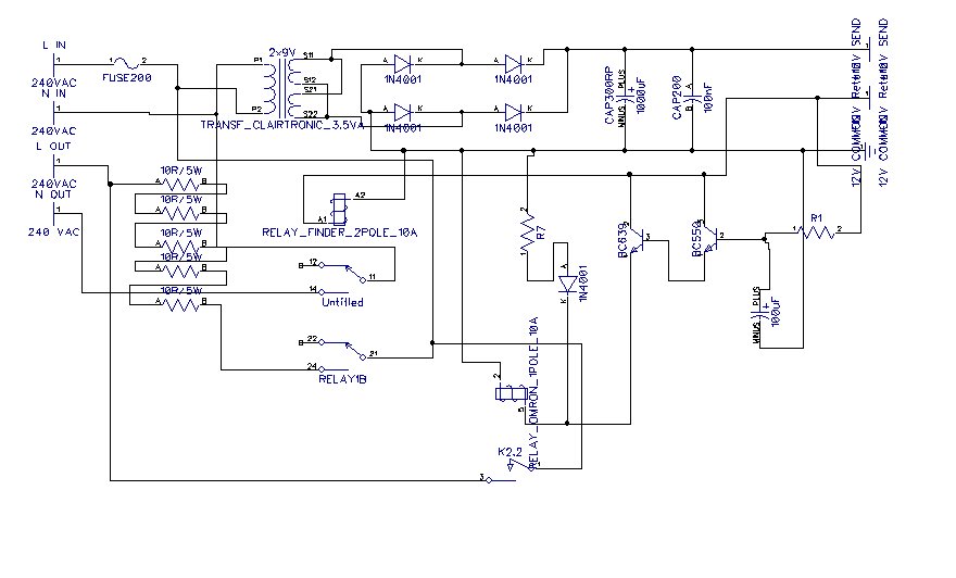

Regrding the slow start circuit, would you like to be a guinea pig ? 🙂 I have designed one and amabout to build it, the PCB should be arriving soon, it looks like this (I am sure I have posted this before somewhere here). What it does is provides a 12 V on-off switch, so you do not run 240V wires inside the enclosure and onto the front panel (imagine spilling your pint of beer) and additionally a slow start by the means of two relays.
If I hadn't already bought all the boards, etc, then I'd take you up on your offer. Moreover, I tend to take my time......
