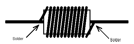

infinia, do you happen to know what the L1 component is which ESP is using to filtering on the output?
Ted205[/i] [B]L1 is an inductor. Have alook at the lm3886 datasheet under reactive loading [/B][/QUOTE] [QUOTE][i]Originally posted by PJPro said:
I've had a look for inductors. Can anyone have a recommend a particular type? Has anyone used one in their build? The data sheet seems to suggest the inductor is used to counter capacitance due to long speaker cable runs (mine will be short). Will they also serve a RF filtering function? Grateful for any views on inductors.
The datasheet can be found here, with the reference to inductors on page 20.
Hopefully the above quotes will give you a quick way to understand where I am coming from. Thanks for any advice you are able to provide.
1) L1 construction is in the ESP link I provided (handwound air coil around resistor body). Hang it off the PWB to the output jack or a standoff.
2) search DIYA -solid state forum for individual posts using terms like "inductor+zobel+RFI" if confused after reading go to step 3).😉
3) It's included in National Semis test circuits and it's the right output circuit/network to use consisting of 4 parts.
4) It looks pretty cool too.😎

OK. Gotcha. Yeah, I like the idea of fabricating my own inductor. The chipamp has the 2R7 resistor and 0.1uF cap already...so I just need the 10R resistor with the copper coil.
