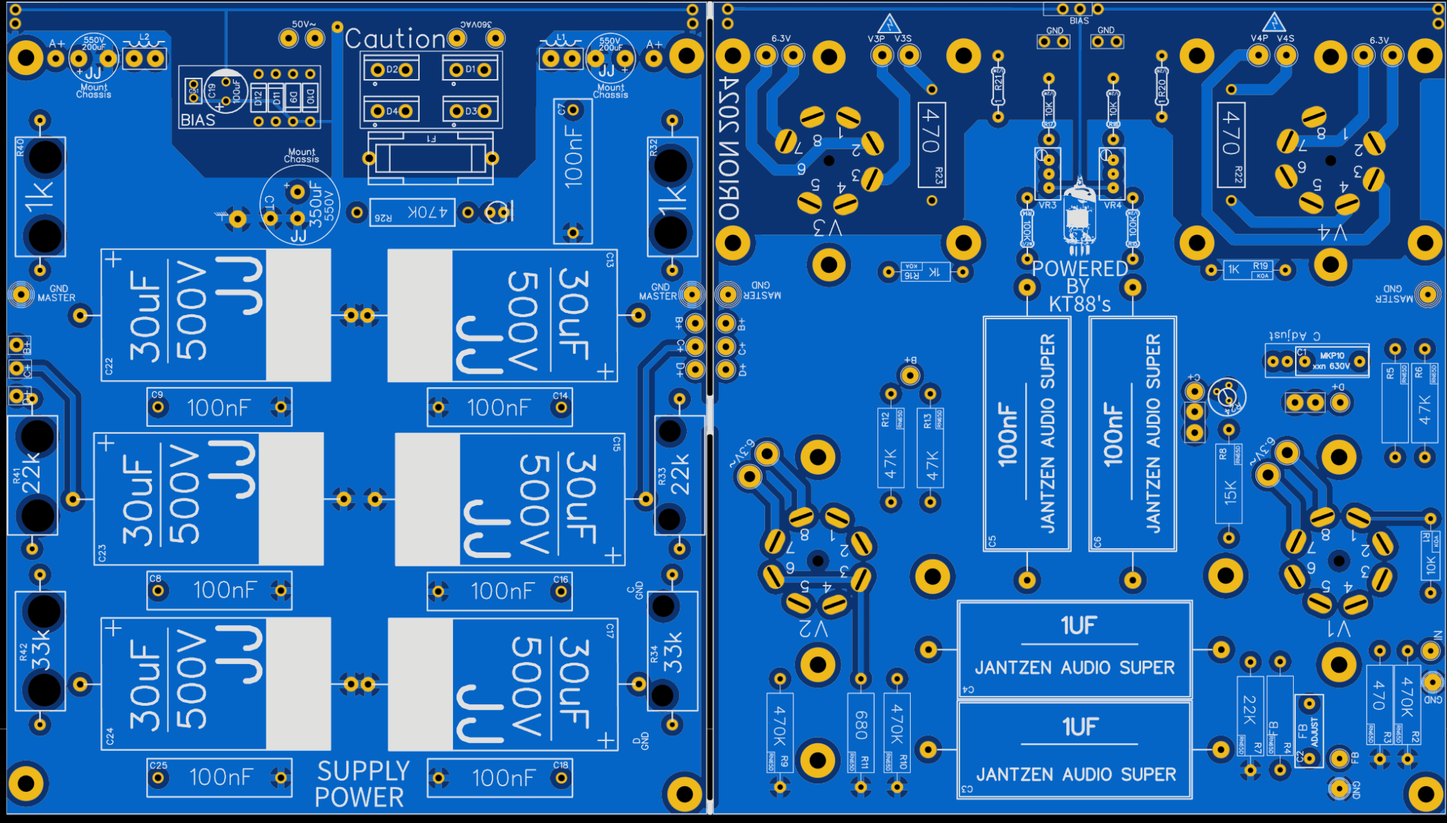

Concerning the PCB no review tonight but these are the change I'm gonna do:
- Moving back the Bias Supply and keep the big lines on top to have a good distribution and no ground loop
@KDMAudio
- Follow Mircea advices and do a GND top copper plane it'll be easier, for preamp only but in this case what space do you put between pads and copper ? at least 1.5 2mm nope ?
Again and again thanks a lot for your help 😊
Regards
Alexis

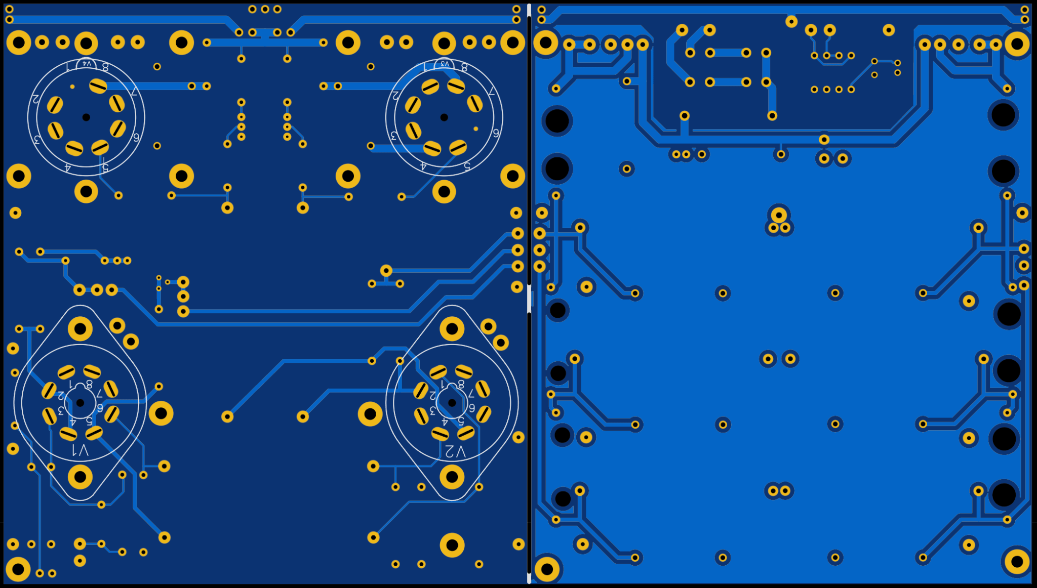

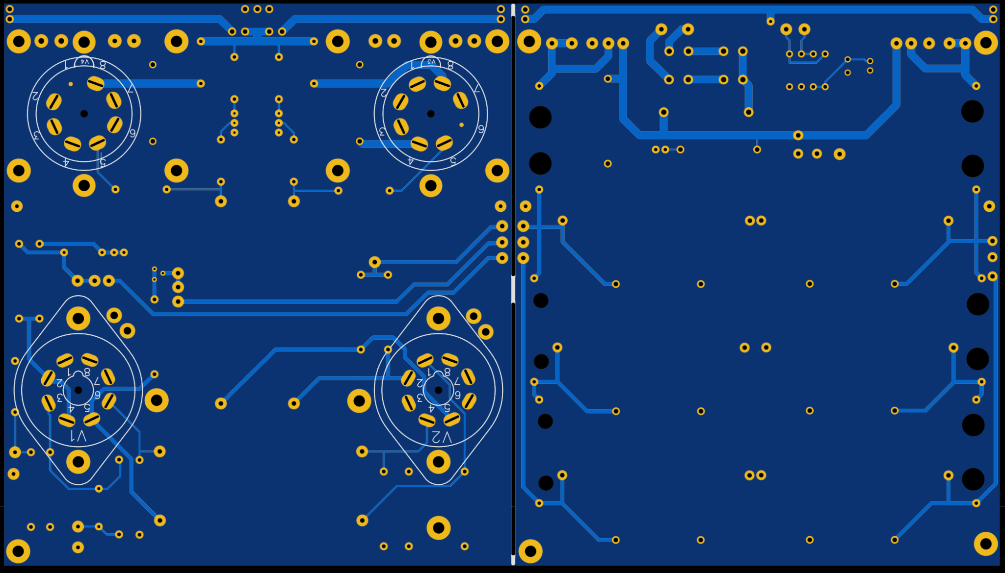

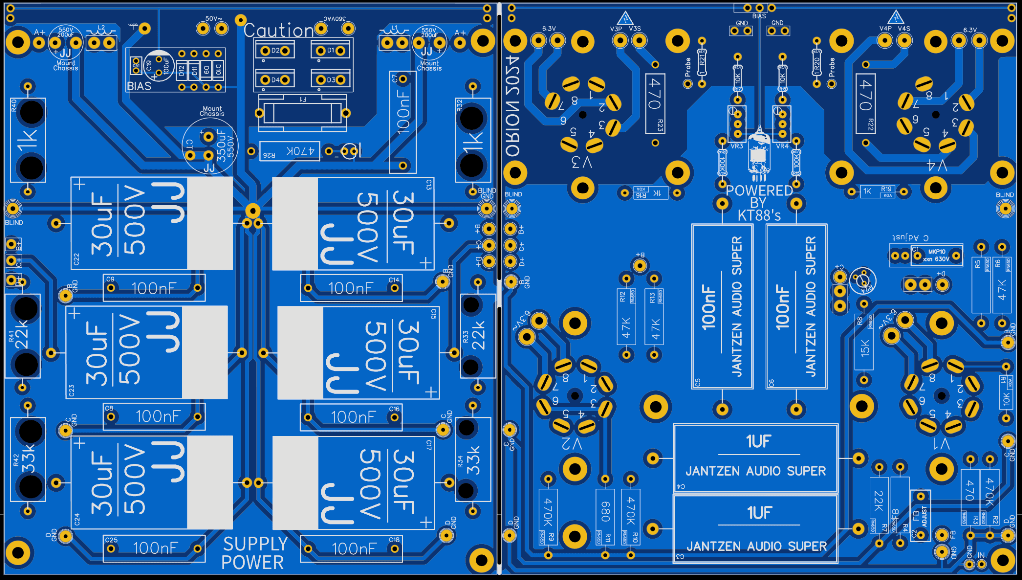

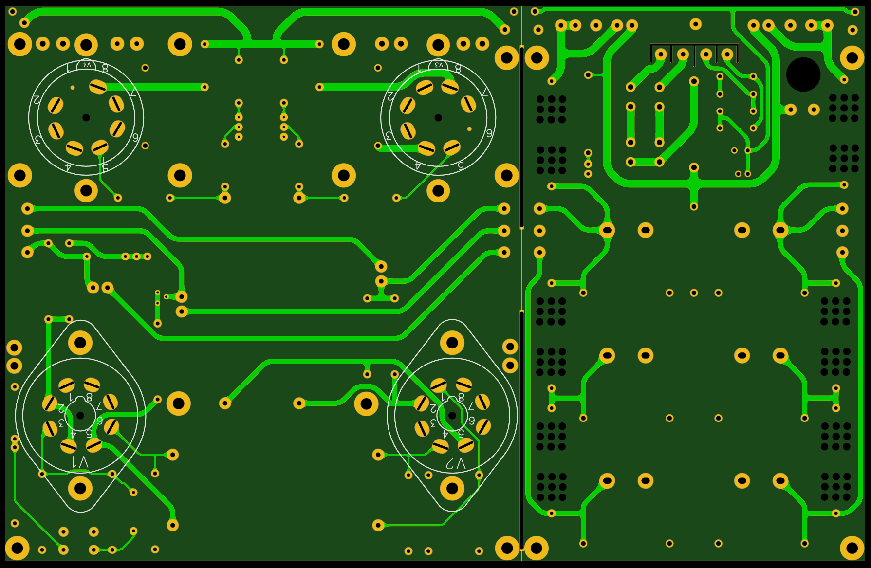

So I made two version, they are not finalized they need few more things adjusted but the main things are here 🤓
The first version is inspired by Mircea with all the GND in the top copper but as the PCB is gonna be cut, is a big bridge in the middle of the pcb to the another one is gonna be ok the a correct current flowing ?
And a second version inspired by my guitar amps PCB, every triode GND is link directly to its own main capacitor to allow the current flow to be focused correctly:

Maybe my understanding is bad, but why don’t you make 2 different boards? One will be the amp, and the other one will do the PSU.
The left card is gonna go for the Right chan the center one the PSU for both R+L, and I'll cut one card to use it as Right Chan. The minimal production of JLCPCB is 5 card and I'm gonna build only one amp.
I can make a full card but the PCB is gonna cost way more especially with 2mm 2OZ and ENGI 😵

I do really like the shape of the copper traces - I'm talking about the radius on the corners. Reminds me of vintage one-side copper traces.
By looking at the PSU board, may I recommend something. You can add some more GND connections, just in case you need them later. It is not a functional matter. Is just that in case you need an extra GND connection when assembling the amp, you have provisions for that.

Did you mean to neck-down the separation of the PT HT incoming traces before they reached the diode pads, and to use that pad separation to gnd? Many software products have a keep clear mechanism for restraining minimum separation of circuit nodes, so as to comply with creepage and clearance requirements. Somewhat similar concern between KT88 pin 3 to anything nearby it, as that pin has largest signal voltage on it, and is not uncommonly seen arcing to pin 2 in guitar amps. The external connections to anode/screen and heater on one side of V4 KT88 may be better to swap over to minimise high voltage signal from coupling to other circuitry.
Did you also mean to increase parasitic capacitance of C3-C6 to the gnd flood ?
There is a concern with pin 1 of the KT88's. You have chosen to make them NC. Some KT88 connect pin 1 to the metal shell - and it is plausible that could be a screening and/or a safety function, where pin 1 was originally meant to be connected to gnd in the equipment. No issue for KT88 where pin 1 is NC in the valve, but can become an issue if other well-known valves are used in lieu of KT88 at some stage. Perhaps worth adding a hazard note to use KT88 only.
The input stage and PI stage grid pins need minimal capacitance coupling to gnd and other signals. There is a lot of added gnd flood aligned with those nodes. Also driver stage pin 5 has close coupling (capacitance) to pin 2 and pin 1 - perhaps don't try and squeeze traces between pads, but route them around.
