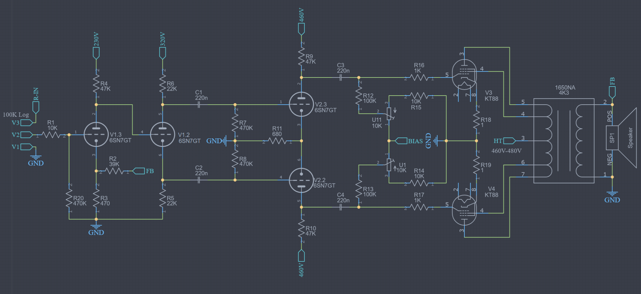

I just noticed the polarity dots on the Hammond transformer data sheet does it show the transformer is revered polarity from primary to secondary?
The blue wire on the primary has a black dot and the black wire on the secondary has a black dot.

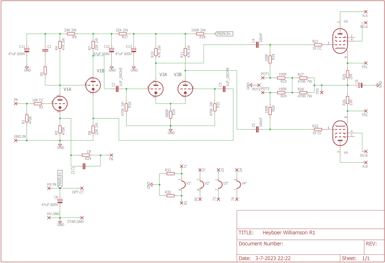

I noticed that too, but it really depends on the PCB layout. Lots of opportunities to swap the polarity in a Williamson. ;-) I had a Williamson PCB designed, too, but every time I build one I have to think really hard and consult my own schematic to make sure I have the OPT hooked up right. ;-)

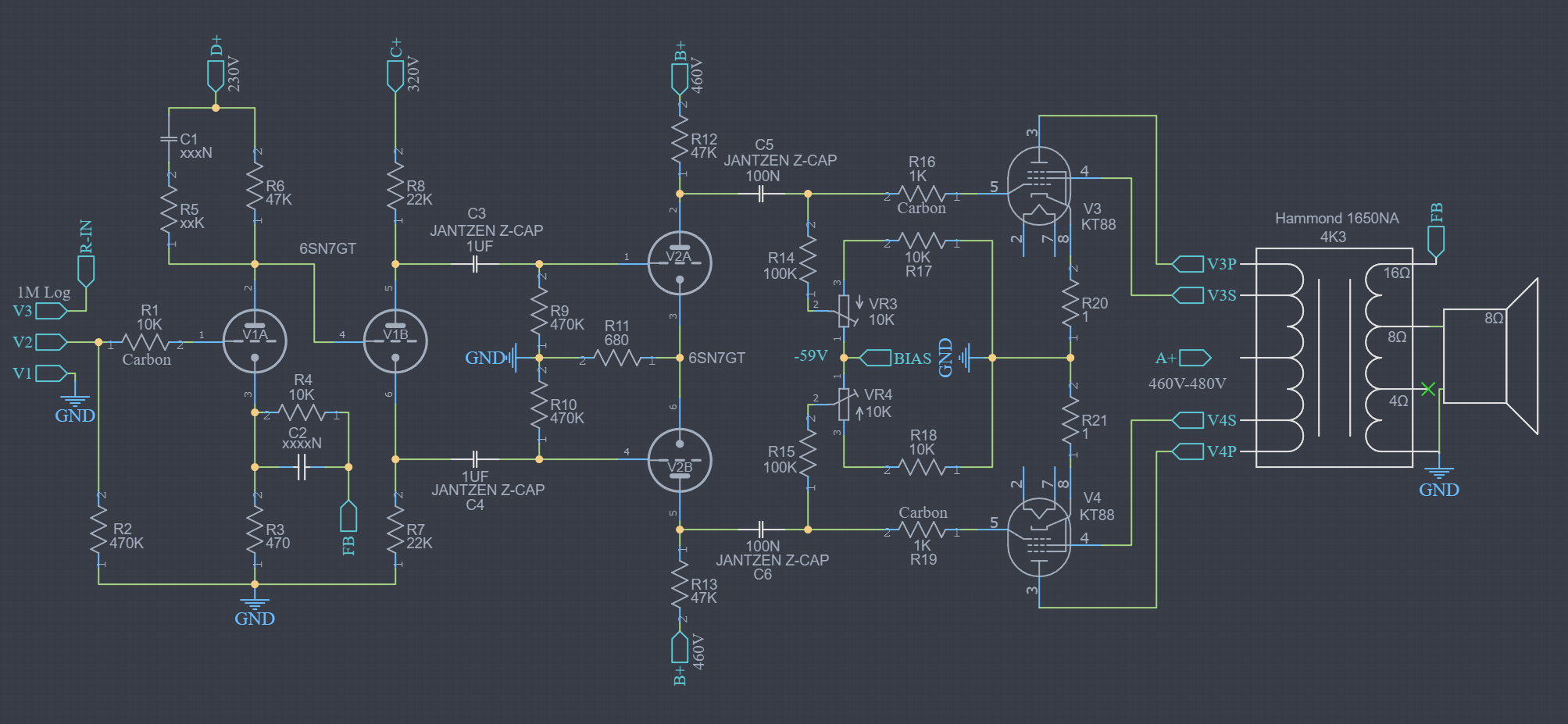

Hello, first thank you for your feedback 😊 It seem you found the issue !
If I start the amplifier the way its done on the last schematic, an horrible sound come out from the speakers, It sound like the audio test that speakers must pass on factory and it's very very loud even the volume completely off, that's what you call "an positive feedback" ? 😵
For the filter 1200pF + 1800K I'm gonna be honest i used your settings Grover but you are right I should start with the default 200p + 4K7
Bluesystems, for the PCB design I used EASY EDA and JLCPCB for the Production, they are not too expensive and work pretty well
So yes for now this is the wiring:
And yes you are right.... it seem to be reversed !! I don't know why they do this maybe to test newbies like me 🤣
This is the correct "way"
I'll try this modification this afternoon and fingers crossed haha

So good news, I swapped the plates wiring and it's wooooooorking !!!! 😀 Hammond are trolls
But I lost a hell lot of power, to have a decent volume I need to push the knob to the mid where previously I only needed 1/4 to get the same amount but all the power is after the mid and the end of the range, can I increase the FB resistor to get more power ?

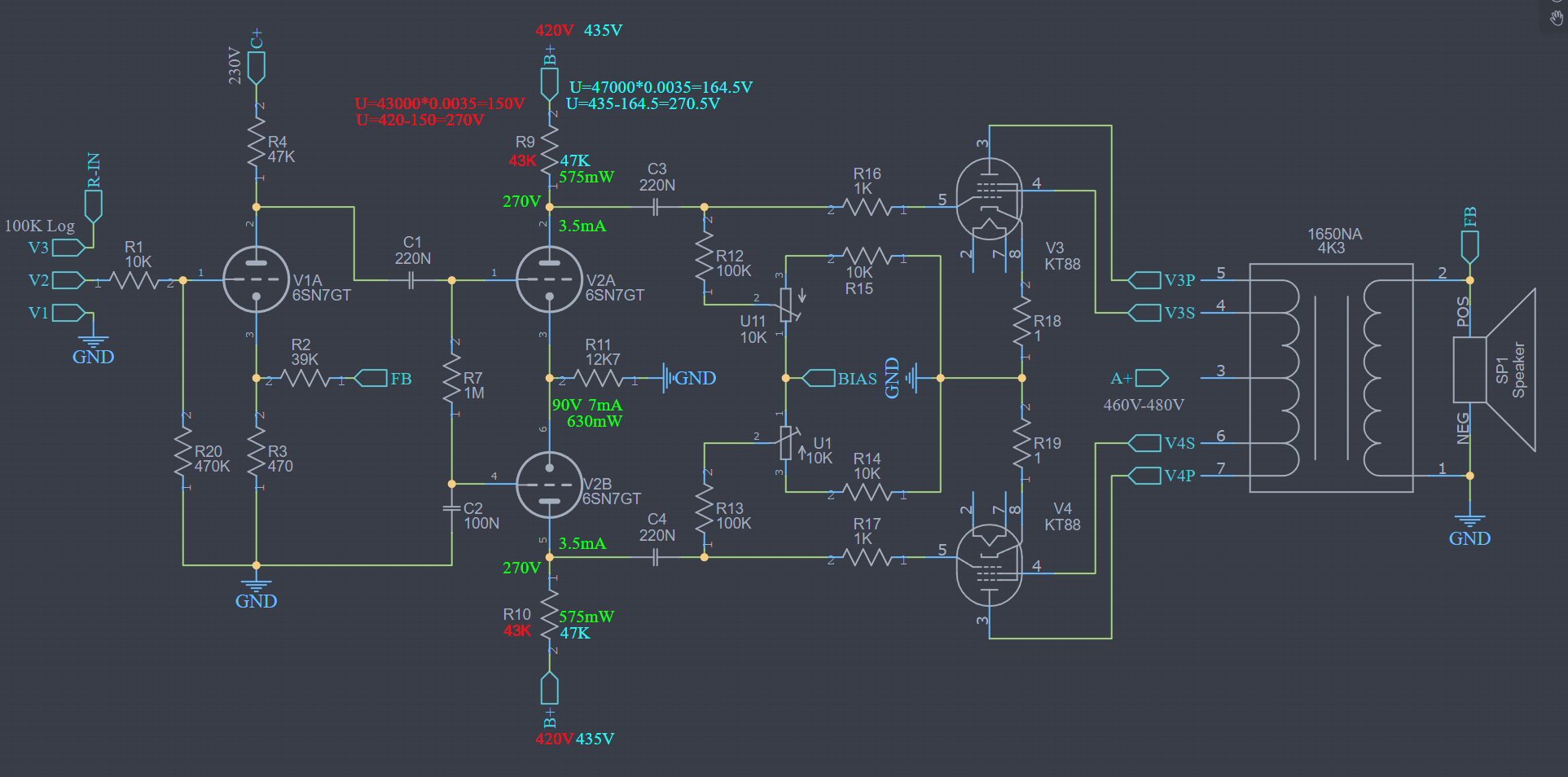

I also tweaked some resistors to get closer to the original voltages:

Excellent! But you didn't lose power, you lost gain! Feedback reduces the gain a lot. In fact, you'll actually have MORE power now, at least at the frequency extremes. Turning up the volume knob to 12 noon is not a problem. ;-) Do not change the feedback resistor from 10K, that is the correct value. Higher and it will reduce the feedback and decrease performance. Lower and it will add too much feedback and the amp might freak out. Don't worry, there's plenty of power there.
That is not an easy amp to build. You are to be congratulated for getting it right! I am thinking of ordering a1650NA and doing some fine tuning to stabilize that particular transformer. It would be great to have a high-powered Williamson project with a PCB and off-the-shelf parts that is guaranteed to be stable. For now you are probably okay. But later this week I'll probably order one and you can adjust your schematic accordingly. It would be a nice thing to have handy. I'd also be interested in a pair of your boards, did you post the gerbers?
You swapped the Plate leads on the output transformer. And that made it work, Good!
Now, you need to check if the Screens are connected to the correct Ultra Linear Taps.
The plate and screen of one tube need to connect to the Plate tap and UL tap that is on one side of the Center tap.
I am not saying those connections are wrong; just check them using an Ohmmeter or DMM.

6A3sUMMER, thank you for your input, it's not in the schematic but there is 3 bleeding resistors, when i turn off the amplifier there is nothing left after 5 seconds.
I'll do some measurement but I swapped everything correctly, not only the plates but also the UL wires. I'm quite sure if the swap was wrong I'll have already had big trouble in the speaker no ? 😵

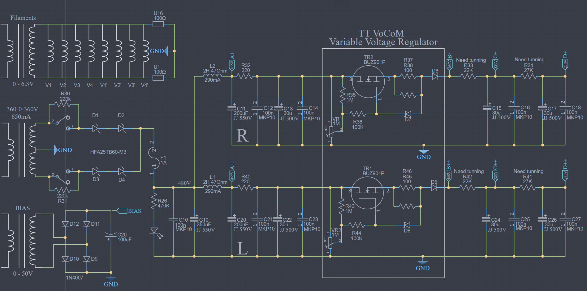

This is I think a better version, there is a lot of changes but the main core is here

Components values changed:
- PI 6SN7 PLATE from 39K to 42K to get 47K with the 10K trimmer
- PI Cathode Resistor from 390 to 680 Ohm
- Power supply resistor => 1K 15K and 8K8 (but it's in my case)
