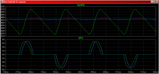

Here is a simulation of
a 36V 3A transformer with negligible leakage inductance and 10% regulation
a near-ideal bridge rectifier with 0V diode drop
an output capacitor that is stepped 1mF 5mF 20mF and finally 100mF
a load drawing 1.65A DC. The input current becomes 3.0A RMS for all four capacitor values. The capacitor ripple current is 2.5A RMS. Notice that the current waveform doesn't change much as the capacitor is stepped. This is because the voltage drop over the 1.2 ohm output resistance of the transformer is so much larger than the change in capacitor voltage.
which agrees well with the formulas from the previous post:
1.65A * 1.8 = 3.0A
1.65A * 1.5 = 2.5A.
The graph shows output voltage (top) and input current (bottom).
1.65A * 1.8 = 3.0A
1.65A * 1.5 = 2.5A.
