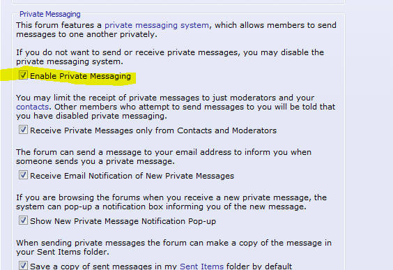

I would have preferred this reply to be by PM, but you have it switched off.
I did not comment on local decoupling and did not comment on loop area interference.
Mail is always open on my user CP, infact just to check I sent one thru myself. AT you should already have my contact info in your Email reader memory in "contacts".

using PM generates this
infinia has chosen not to receive private messages or may not be allowed to receive private messages. Therefore you may not send your message to him/her.
this is silly just post it here
