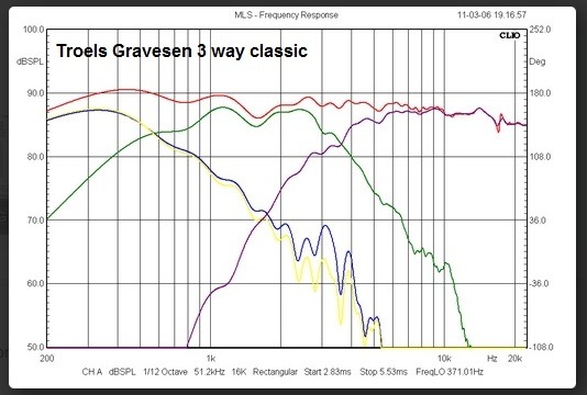

No. Study these two 3 way designs.
http://speakerdesignworks.com/Finalists_1.html
http://www.troelsgravesen.dk/3WClassic.htm
What do they have in common?

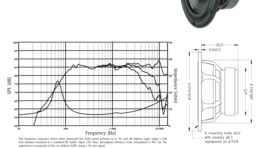

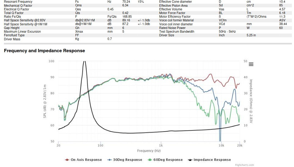

An excellent flat midrange operating from 500Hz to 3kHz. The Bass and tweeter just add a bit of Bass Boom and Tweeter Fizz.
The result is a speaker you can live with and enjoy. I enclose the Curt Campbell mid and the Troels Gravesen mid, and the usual graph of how it works.
