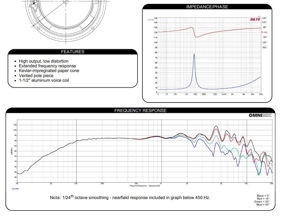

An excellent flat midrange operating from 500Hz to 3kHz. The Bass and tweeter just add a bit of Bass Boom and Tweeter Fizz.
The result is a speaker you can live with and enjoy. I enclose the Curt Campbell mid and the Troels Gravesen mid, and the usual graph of how it works.
Actually, I have ideas of how to do better. But that's just me.
