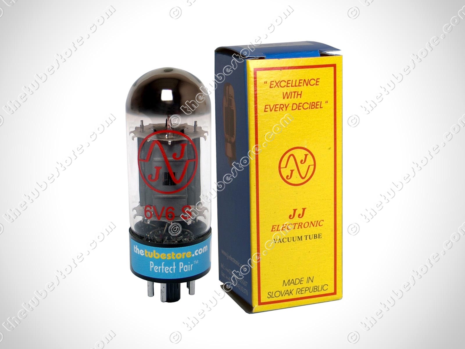

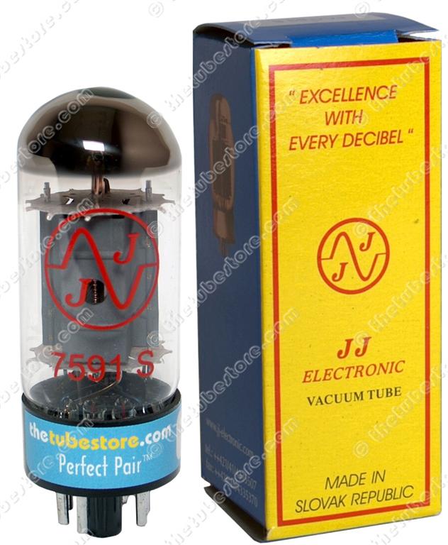

I have a reissue '65 Princeton Reverb. It has two 6V6 tubes in push-pull at the output, and the factory schematic shows a ridiculous 440 volts at the anodes.
Among currently manufactured 6V6 tubes, only the JJ 6V6S has a reputation for surviving this much abuse. That's what's in my amp, but unfortunately, the JJ 6V6S isn't really a 6V6 (more on this in a moment), doesn't really sound like a 6V6, and sounds too clean and sterile, almost as bad as a solid-state amp.
If you look at the attached images, the JJ 6V6S appears to have the identical plate structure to a JJ 7591. And who knows what the "7591" started out as - some Soviet military tube produced in the country then known as Czechoslovakia, which was dominated by the USSR at the time?
No wonder, then, that the JJ 6V6S doesn't sound like a 6V6, because it isn't one! FWIW, the old Tung Sol datasheet shows 550V and 19W max ratings for their 7591, while an old Tung Sol 6V6 datasheet shows 315 volts and 12 watts. More telling, the 7591 is spec'd at 1.5% harmonic distortion in push-pull at 400V B+, while the 6V6 is spec'd at 5% THD at 250V B+. With triple the harmonic distortion, no wonder "The 6V6 sings the blues", as Tubelab (George) puts it.
