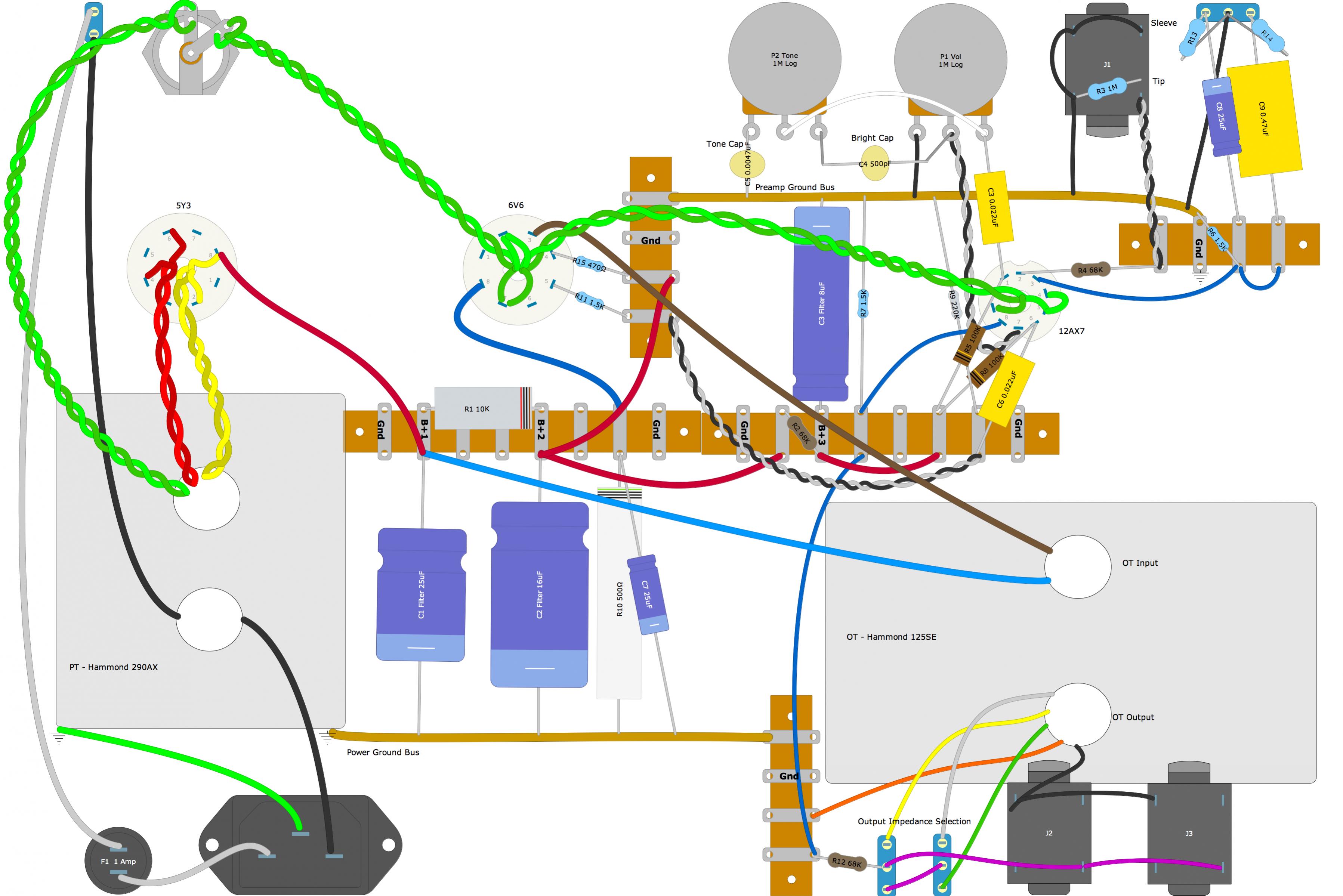

First crack at P2P layout
I am first time builder.
I am building a Two-Stroke based on Dave Hunter's book.
The Tube Amp Network hosts a copy of the layout and the schematic.

Inspired by Rob Robinette's site and using DIY Layout Creator I came up with a layout for my Two Stroke Amp Head. See the attachment.

I plan to use a 12 X 8 X 2 Hammond aluminum chassis.
Hammond 1444-22 - Aluminum Chassis 12x8x2 - Canada
The black and grey twisted pairs represent a shielded cable.
I am using a separate preamp bus and power-amp bus.

Questions:
What would you change?
The layout is roughly scaled so I think the chassis will be big enough.
How about the tube layout?
The transformers positioning?
The filament wiring?

Input and output are well separated. Nasty rectifier is kept on the dirty end near the AC inputs. AC transformer alignment is usually tried in both 90 degree alignments to pick the one for less hum before you drill the mount holes. You have the low impedance output tube near the dirty end, the high impedance 12AX7 near the input, that is good.
I don't see the speaker out jack to see if you put a 1000 ohm 3 watt resistor across it to save your transformer if the speaker gets unplugged.
I don't see a 33 pf disk cap across the input to keep RF out. Like the AM radio station in my town that gets into my raw amps.

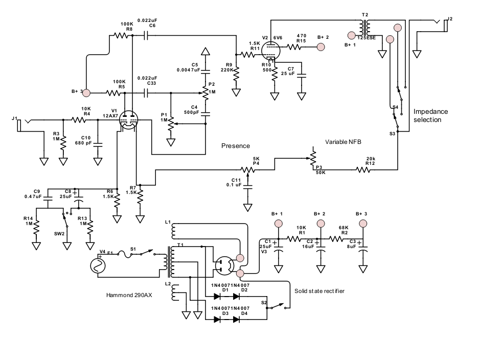

Rev 2 of schematic and layout
After lots of great feedback from the folks at the Canadian Guitar forum, diyAudio, and TDPI I have:
* a new chassis size and material consideration
* an expanded list of modifications
* new schematic
* new layout

Modifications
Mod-1. Added a 470Ω screen resistor to V2 (see forum discussion), .
Mod-2. Added some SPDT switches to pick 3 of the 4 output transformer impedances.
Mod-3. Change R4, the 68KΩ grid stopper on V1. I used the Merlin suggested 10KΩ + 680pF capacitor.
new Mod-4. Variable negative feedback
new Mod-5. Presence control.
This was suggested by @mhammer and by watching Uncle Doug: NFB and Presence.
I combined the two. If I understand correctly, the first pot controls the amount negative feedback, and the second will decide how much of the frequency gets rolled off.
new Mod-6. Switchable Solid State Rectifier.
I saw this in a post and post on the Tube Amp Network.
pending Mod-7. @mhammer also suggested a neat mod where instead of voicing switch you replace it with a W-Taper hooked up to the 2 bypass caps so you could vary the amount of bypass.
I don't have the pot now, but there should be plenty of room to replace the switch in the future.
Speaking of W-taper pots, I found an interesting page in Spanish which sounds like it allows you to simulate the pot with regular pots and resistors.
Schematic
Here's the revised schematic using SchemeIt

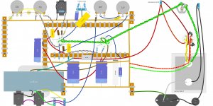

Layout
R.G. Keen's article had some great point-point tips.
Here's the next layout.
Note: I changed the orientation -- you are now looking at the amp from the bottom as opposed to looking through the top.
Why?
* This way seems to match the tube pin number order in the software
* It is what it will look like when I am building the amp
<snip>
This will not work in quite the way you expect. Both R12 and your 50k feedback adjust pot have much bigger resistances than the 5k presence pot. This means that changes to the feedback will also cause changes to the frequency response,a s though you had turned the presence pot; your adjustable negative feedback will turn into (unintentional) adjustable frequency response.
At the same time, the frequency response changes that the presence pot was supposed to cause (it boosts treble, creating more "presence") will change; at large resistance settings of the feedback pot, most of the frequency range of the guitar will get boosted, except for deep bass. A presence control normally only boosts mids and highs.
Guitar amps are weird, and it is always possible that you will end up liking this unexpected behaviour. But I wouldn't go drilling holes in the front panel for the variable NFB pot until I was sure I liked it.
Personally, I would also suggest omitting any unnecessary complexity for your first build. S3/S4 is an example - lots of extra wiring to get right, and if you don't get it right, your amp might end up with no load across the output, which kills valve amps (output transformers and sometimes output valves tend to fry if the amp is operated without a load.) I recommend wiring the amp without S3, S4, or the variable NFB, at least at first. Once that's all debugged and working, you can always add the other features.
R.G. Keen has a similar article somewhere, probably buried in his GEO website.
There is a big catch with all of these schemes: once you add the extra taper resistors, the end-to-end resistance of the pot no longer stays constant, but instead, varies drastically as you turn the pot.
For example, R.G. Keen recommends using a taper resistor that's about one-fifth of the value of the pot, to create a simulated audio taper log pot. Let's say we used a 500k pot, and a 100k taper resistor. Now, at one extreme of the pot position, those two resistors appear in parallel. Instead of looking like a 500k load to the preceding valve stage, that "500k" pot now looks like an 83.33k load. :eek:
This is okay in some solid-state circuits, when the pot is fed from an op-amp or other very low impedance source. But it can be very bad when the pot is in a valve circuit, and fed from a high impedance such as the anode of a preamp valve.
...looking at the amp from the bottom...it is what it will look like when I am building the amp
I agree, and I have been doing this with all my DIY electronics since I was a child. The only exception is when I'm using a solderless breadboard, in which case, you can only see the component side!

This will not work in quite the way you expect. Both R12 and your 50k feedback adjust pot have much bigger resistances than the 5k presence pot. This means that changes to the feedback will also cause changes to the frequency response, as though you had turned the presence pot; your adjustable negative feedback will turn into (unintentional) adjustable frequency response.
doh! I totally messed up transferring the circuit from the fender schematic
does this make more sense?
my naive interpretation is that after the variable feedback resistor (R12 + P3) we are offering variable resistance path for high frequencies to ground instead of contributing to the negative feedback
It certainly does. Now R7 keeps the impedance across the presence network from rising above 1.5k, allowing P4/C11 to do their thing.
The variable NFB pot will still have some effect on the presence control, but now it will be relatively minor, and shouldn't matter at all for a guitar amp.
That's how I see it too, but when in doubt, I draw it up in LTSpice and simulate it...that can give us a more accurate idea than our quick gut-feel estimates.
The funny thing is that if you implemented this sort of presence control around, say, an op-amp, you would end up with an oscillator. Cutting treble in the feedback causes the open-loop gain to rise at +6 dB/octave, and when this rising response meets the falling open-loop response of the op-amp, there will almost certainly be enough gain and phase shift to cause outright oscillation.
But a valve amp like this usually doesn't have enough open-loop gain, or enough negative feedback, to create oscillation. And so "presence controls" became somewhat common in vintage valve guitar amps. :)
