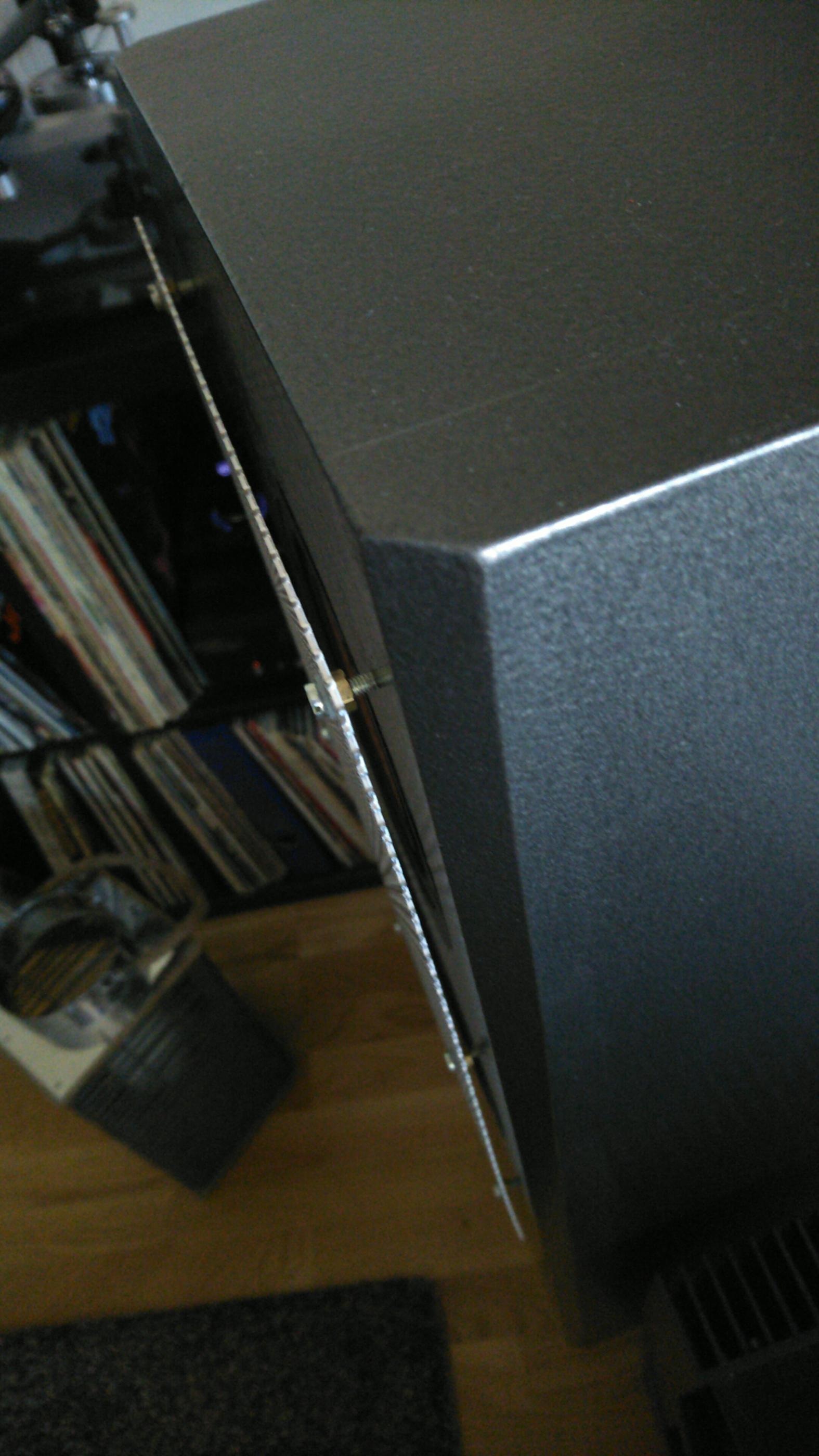

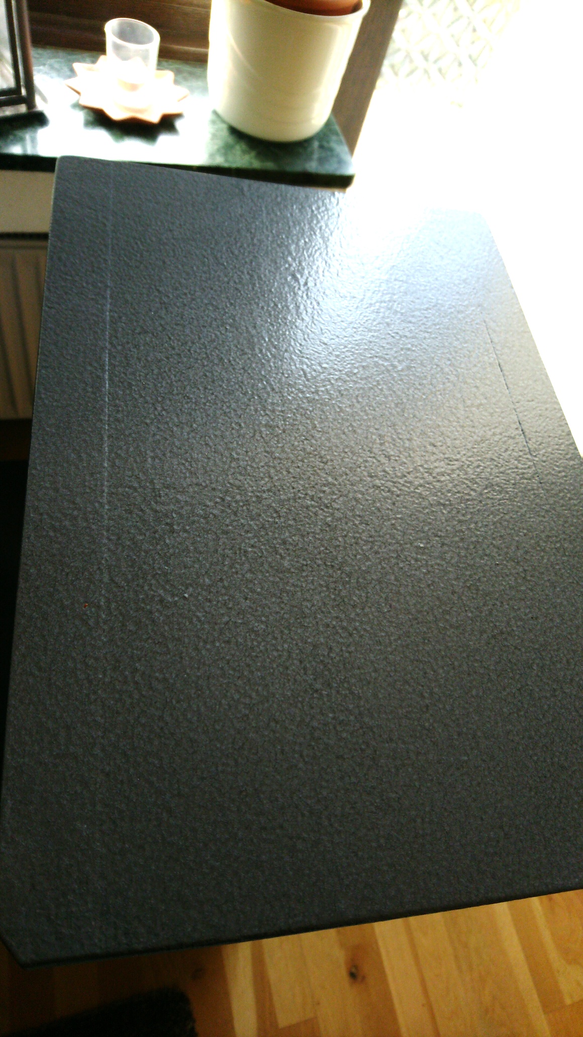

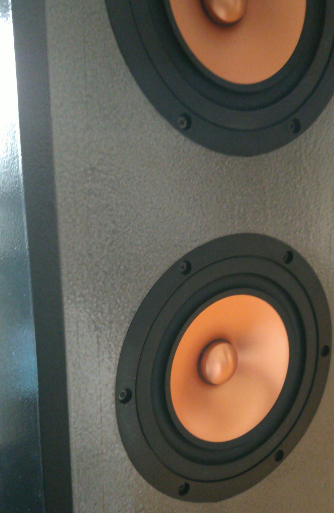

Inserted the magnets. Tried to push them not too deep into the wood to keep their maximum power.
Not really invisible under the paint.
At the end I'm satisfied with the finish.
Not pro but I don't need to hide the speakers.

How does it sound?
@Spassgeneral
Thank you for this first class design.
I am really satisfied.
Bass is deep and tight. Very accurate bass lines. Mids and hights are crystal clear.
Very balanced sound over all.
Curious to hear what will be when the drivers are run in for about 50 to 100 hours
By now I can say, well worth the effort.
Compared to finished high end speakers a real bargain.

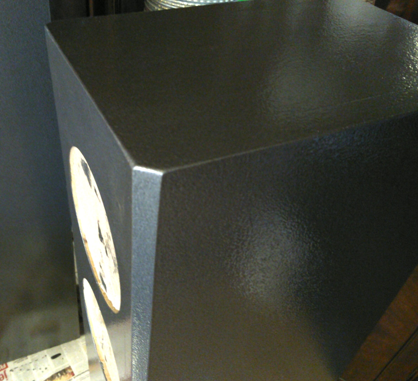

I like this paint. Do you have a link to the product? Thanks
Next steps.
Thanks a lot, I am seriously considering, it seems a great idea to use on wood. Was it easy enough to get uniform?
Nice, another set of hybrids! Now I really need to start building mine, because we just moved and our living room looks so empty without any speakers 😀
So you used the 8mm magnets under the paint? Have you tested them with the front grill already? How do they hold up? I need to get some magnets for my build also, but still wondering what size to get. I love the looks without the grills, but I'm a bit worried about our cats poking at the drivers.

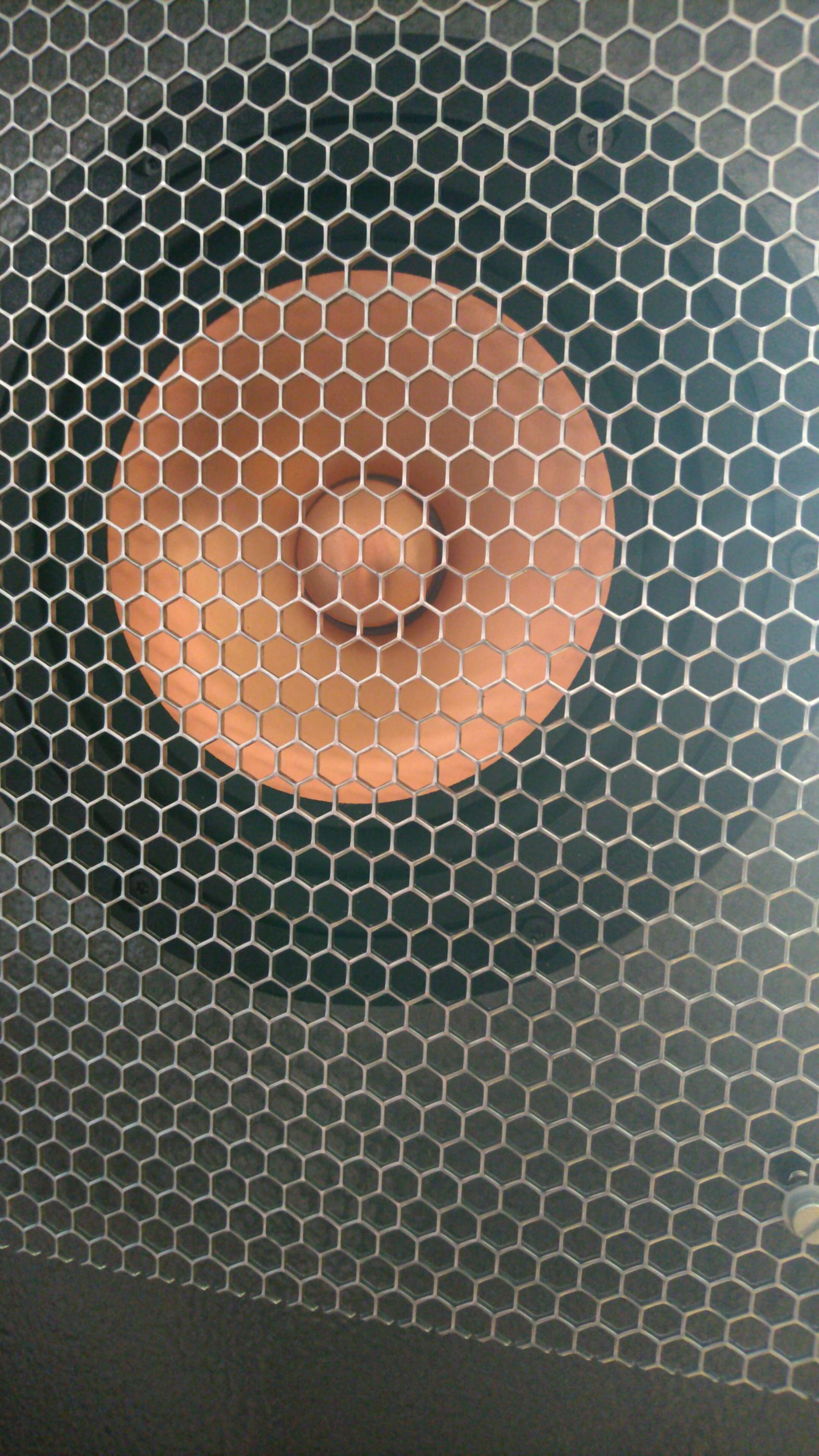

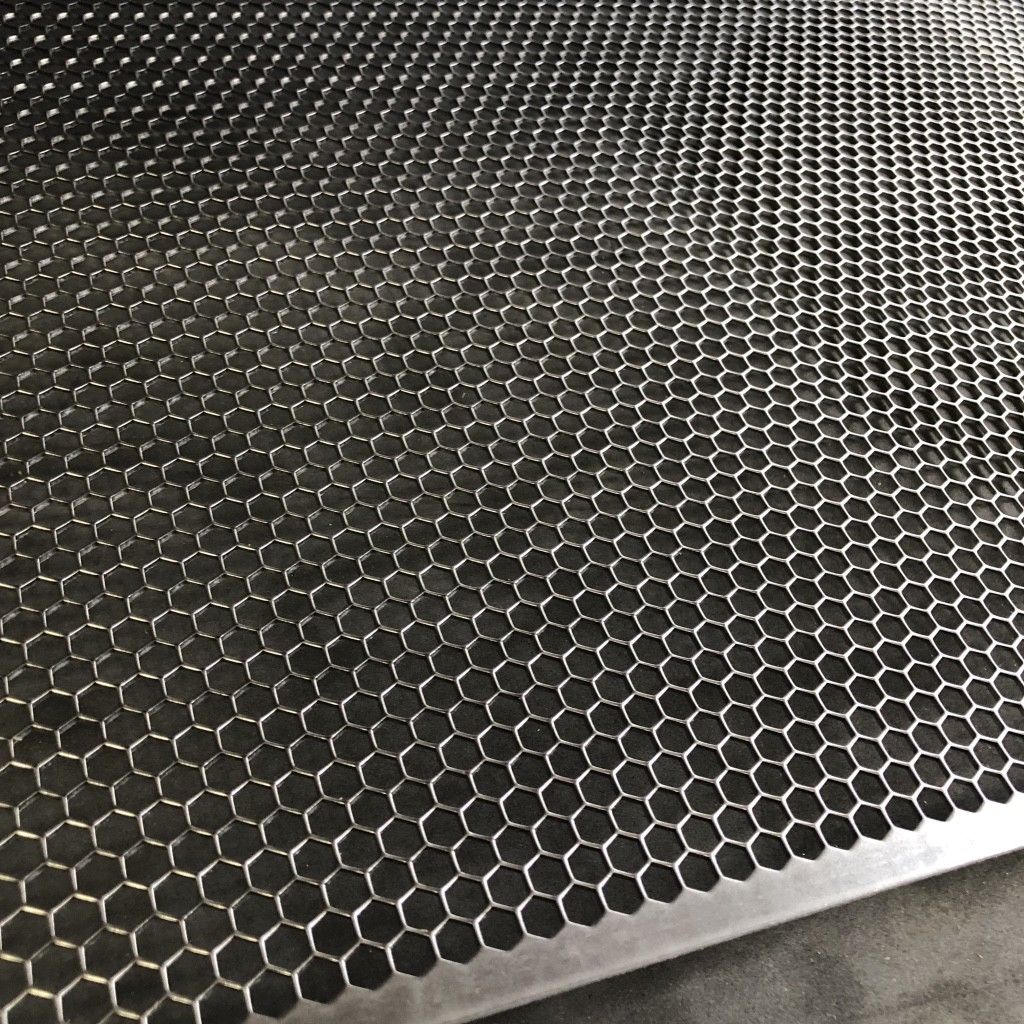

Finished at last.
Hmmmmmmm.....
May be i will shorten the screws.
But then it's really done.
Hmmmmmmm.....
I love the look of the hex grill, but you might find it becomes an auxilury radiator with high levels of bass (and these shurely should be very capable in that respect.
