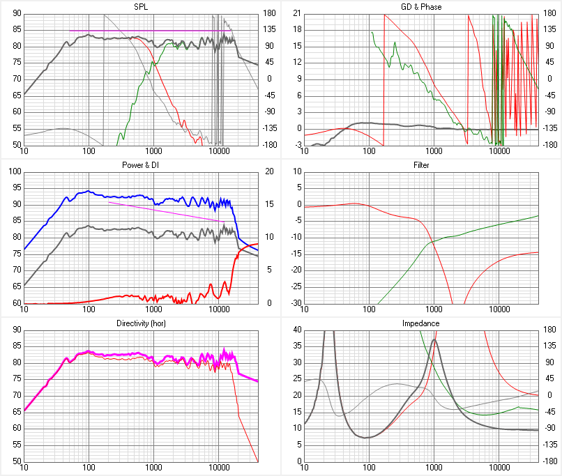

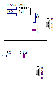

If the OP is still wanting to use the Dayton DC250 10" woofer here's some ideas:
post #11 this crossover or the woofer section and
https://techtalk.parts-express.com/...ver-config-for-a-very-cheap-10-3-way-retrofit
? plus
DA990 830656 DX25TG tweeter section
https://web.archive.org/web/2016031...-une-enceinte-low-cost-tres-haute-definition/
or
Peerless OC25SC65-04 (something other than this $$$ horn?)
https://josephcrowe.com/blogs/news/peerless-oc25sc65-04-with-horn-no-1900
Simulate and see.
Other 10" woofers- Visaton W250, Dayton DSA270-8, Eminence Alpha 10 (see Pi Speakers, 2Pi model-one cap, one inductor, and one resistor)
https://pispeakers.com/Measurements/twoPi.html
https://www.diyaudio.com/community/threads/wayne-parhams-2pi-towers.280841/

Here's the tower version of the DC200/DC28F:
https://projectgallery.parts-express.com/speaker-projects/noahs-8s/
