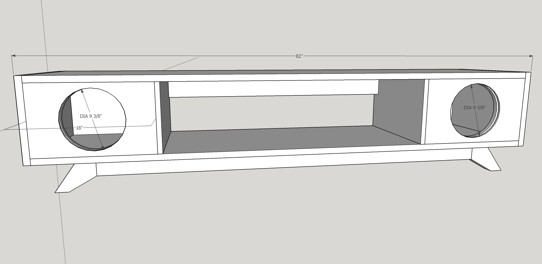

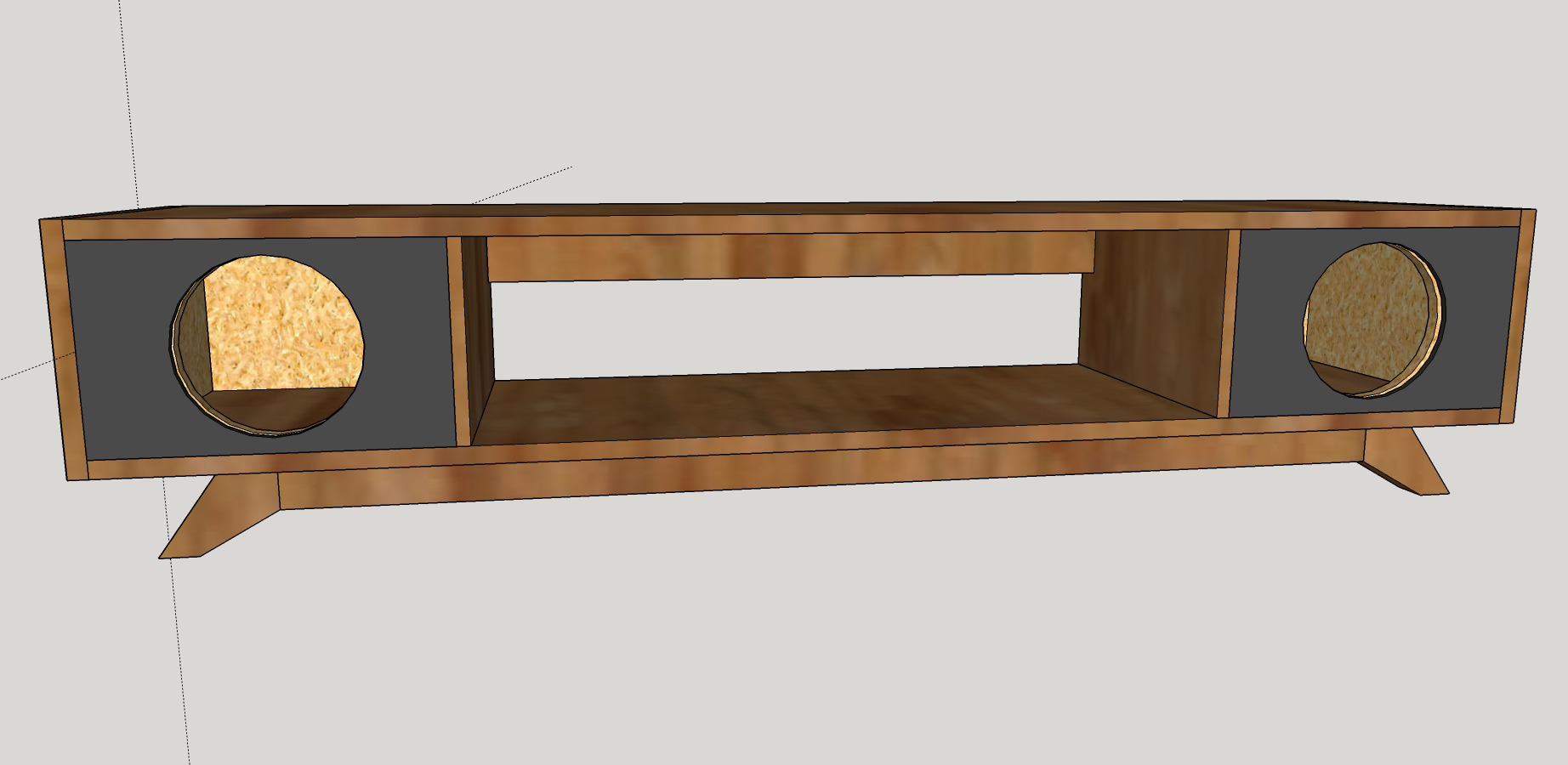

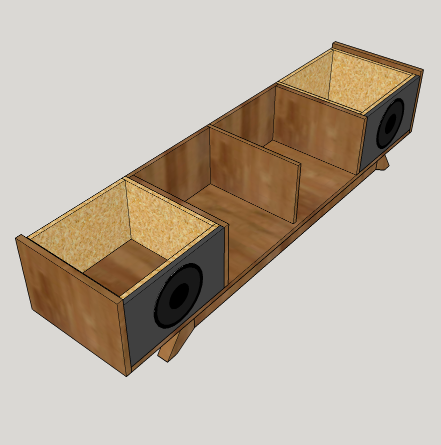

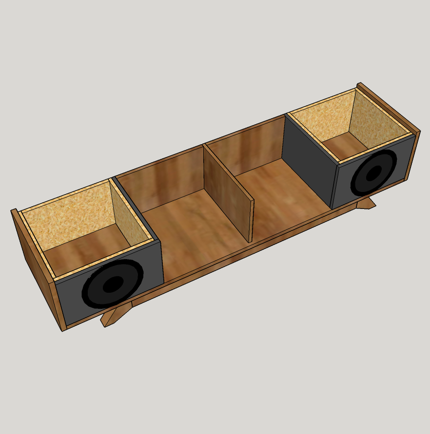

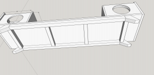

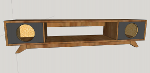

So here's the design now. I made it a bit shorter and removed the middle divider to give it a nicer design. I also added a brace up top to hopefully still keep it stable, I'm probably going to have to do more than that though.
attachment.php

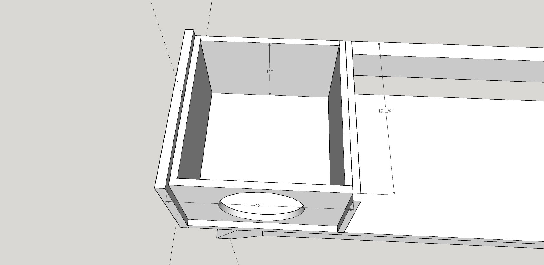

These are a few measurements.
attachment.php

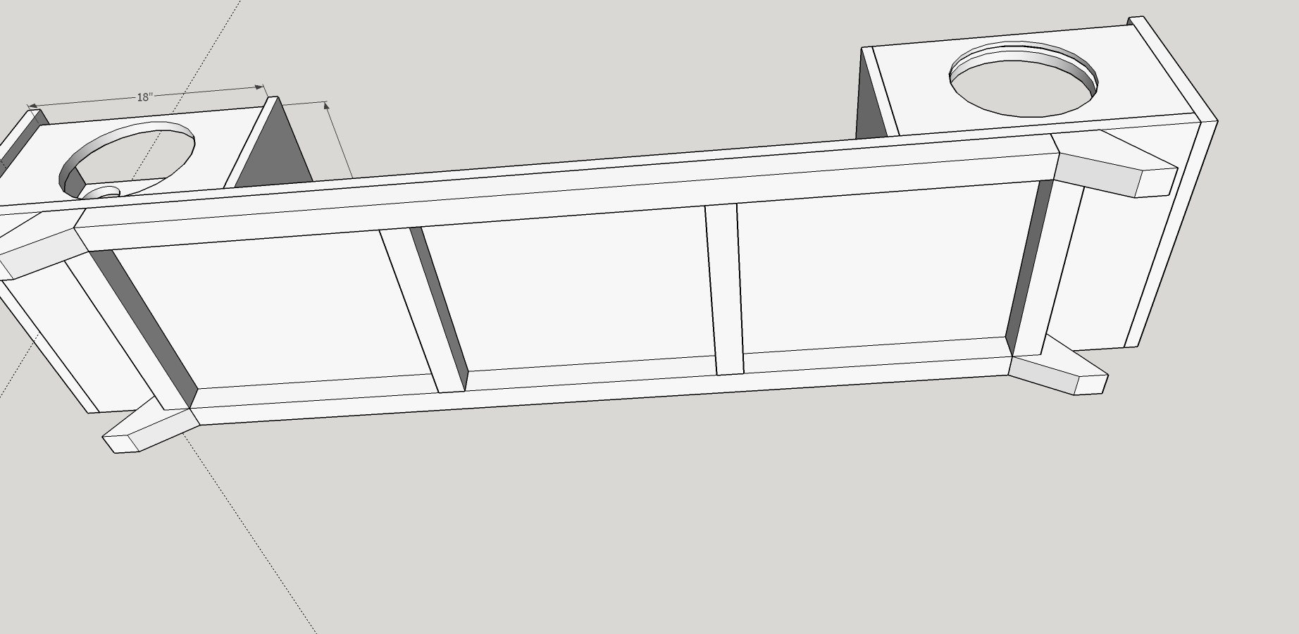

Some more measurements inside.
attachment.php

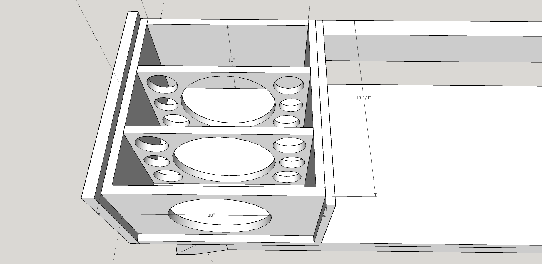

Some mockup braces I did, I really don't know how I'd do the braces honestly.
attachment.php
Bottom support.
attachment.php

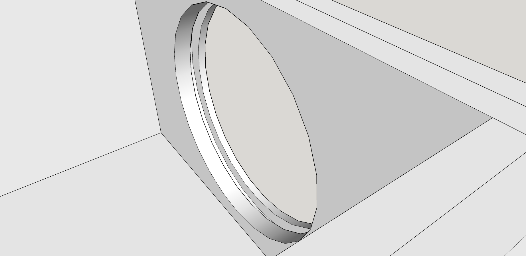

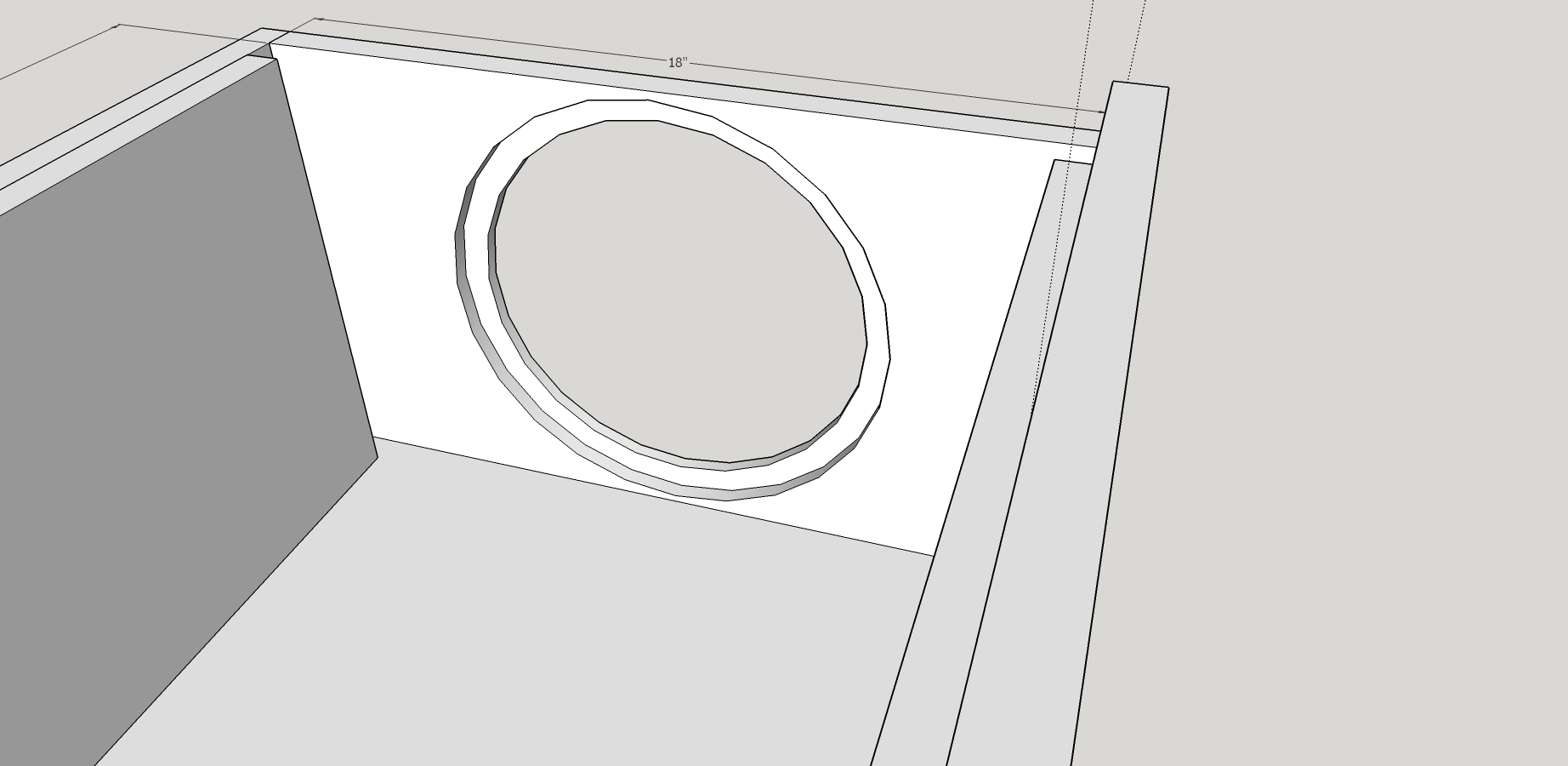

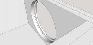

This right here shows how I'm going to recess the baffle from the back side to hide the outside edge of the driver. From there I'd round the edges of the the opening from the front side, hopefully resulting in a nice integrated look for the woofer. If I could model this I would, I'm slowly and painfully relearning blender to do exactly that.
attachment.php
And this shows both pieces of plywood together, with that gap being where the driver is mounted.
attachment.php

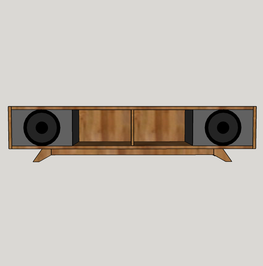

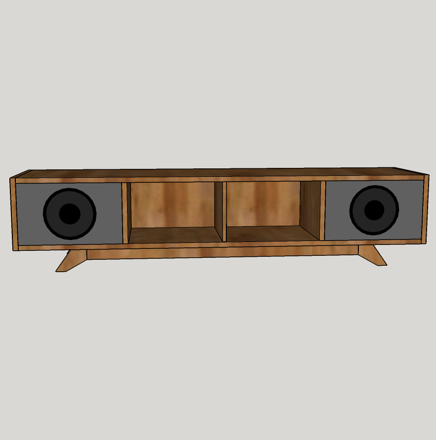

That's going to rattle and resonate against the frame of the driver. These are STRONG motors capable at high excursion of walking that console across the room empty. I wouldn't overlay the frame.
If you're look is MCM, why not a nice twill retro grill cloth?.....those aluminum dust caps are fragile and very ugly once dented. Also the grill cloth will attenuate any high frequency suspension or motor noise making for an improved performance. Use some chrome or polished stainless steel accents to keep the MCM look

I think (and measurements suggest) he's more in the 2 ft^3 range per bin, but I agree that he won't be hurting for output.
