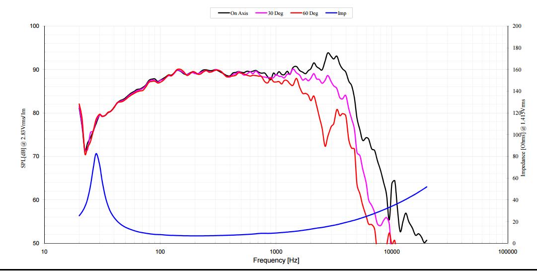

Looking at the Peerless FR below, the -3dB point at 45 degrees looks to be just about exactly where montana put his xo, about 1700Hz
. However, the corresponding wavelength is about 8", so unless you can get the centers of those 2 woofers closer than 4", it's a less than ideal setup. Even 8" center to center can't be done when there's a tweeter in between them. So 8" drivers are not generally recommended in MTM configurations.
Also those Peerless don't go any lower (ie. F3) sealed than the 5" SB's do. And they need a fairly large Vb for 2 of them ported, upwards of about 50L. You are going to want to double check if you have enough room for that.

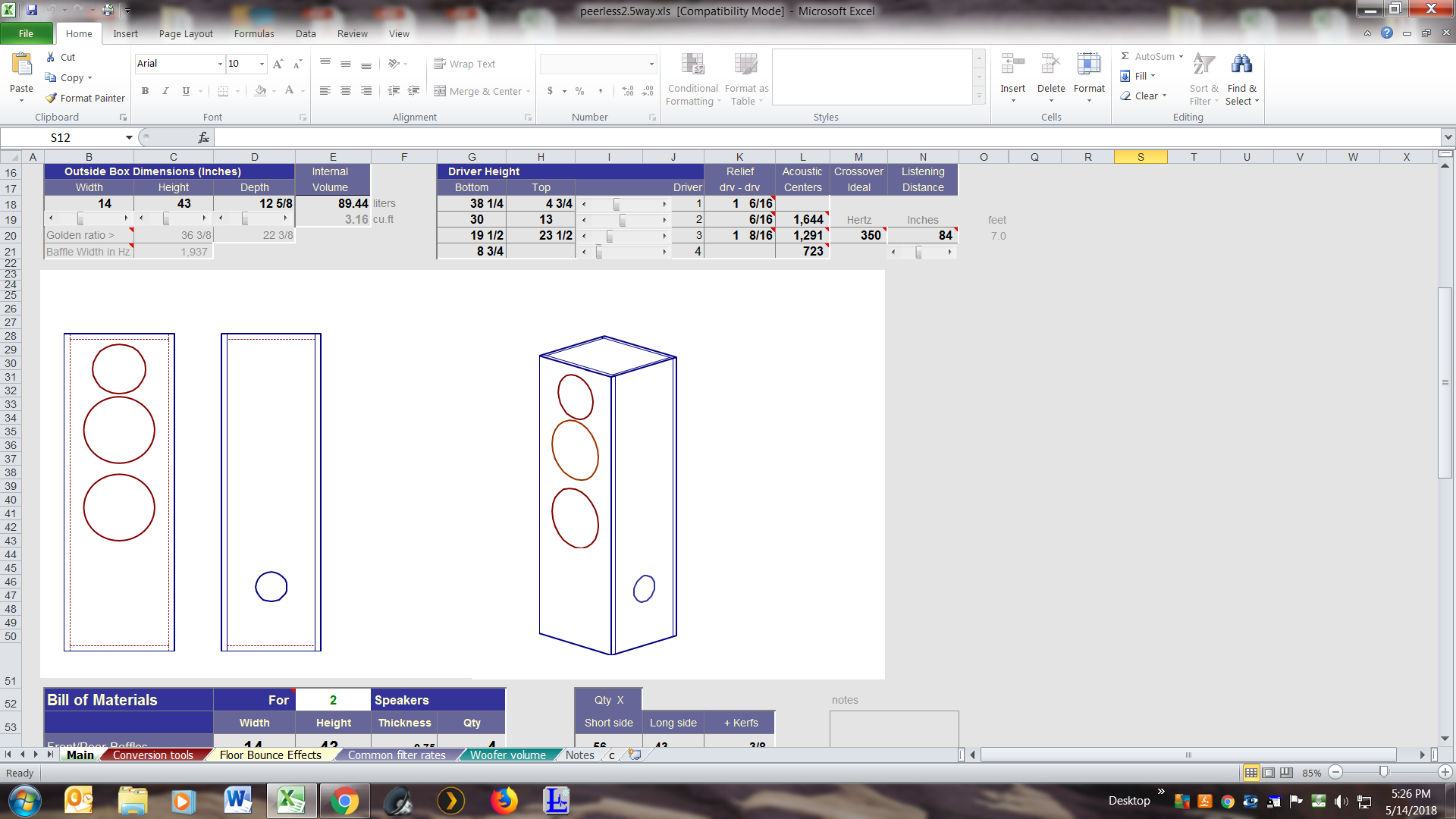

I wanted to run a question by you to get your expert opinion. This may even be a design option for the OP. What do you think about a 2.5 way TWW configuration with upper woofer 25L sealed and lower woofer 58L vented? The woofers would be the Peerless 830869 and tweeter may remain the SS D2604/83300 mounted in Monacor WG300 or maybe look to something else that can be crossed around 1.2k or there about. This build we me strictly for music but I'm convinced that it would do well for HT use as well. I have attached a boxy cad drawing to get an idea of cab size, driver spacing, etc.
Hi Rich,
First I would double check your modeling, as I think you've modeled for 2 drivers instead of one for each of those chambers.
Going sealed and ported is a little unusual in a 2.5-way design, but it could work if you are looking for a LF response in between a sealed and ported alignment. But I would design in more flexibility and go with 2 chambers, both ported. Then stuff 1 of the ports if you want to play around with that LF response. More options this way, say if wanted to move to a bigger room later.
However, 2.5-ways are still a bit of a compromise in that 1 of the midwoofers is still handling the whole frequency range from somewhere around 40Hz up to 1 or 2kHz. Actually, what I think you are ready for is to step up to the big leagues and go 3-way with say 2 of those Peerless as woofers and throw in a 5" Revelator or Satori as your mid. Now we're talking. 😀 The 3-way also gives you the added advantage of treating your mid and woofer chambers differently in terms of resonances and absorption - something that's much harder to do when a driver is covering a much wider frequency range.
Also, have you written any books on loudspeaker design and theories? If so, where might I purchase a copy. I really have learned a lot from your posts.😀
Best Regards,
Rich

- First attempt at designing a speaker and crossover. I'm sure that I've done it wrong.
