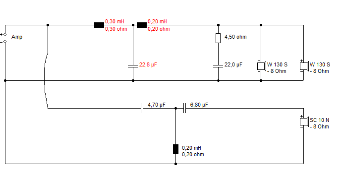

The crossover:
I am sure that I am completely out of my league in trying to design a crossover, but I gave it a shot anyway. I'm just going to post a bunch of graphs and hope that you guys can tell the ways that I screwed up (and hopefully how to fix it 🙂 ).
Schematic:

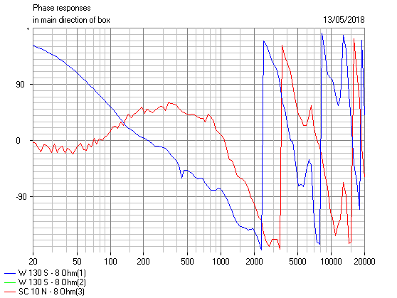

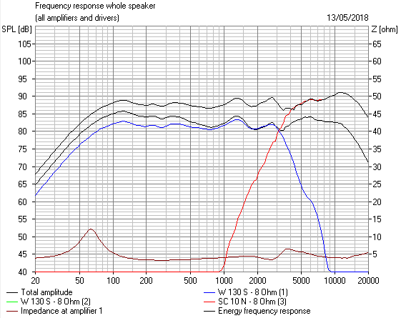

Frequency Response with Phase Curves:
It drops down 2-3 dB at around 5 kHz. If I changed the resistors in the high-pass to two 2 ohm resistors in parallel, the line stays pretty flat at 90 dB; however, if I do that, I'm worried that I'll deliver too much power to the tweeter. Any suggestions?
Regarding phase: I left the phase source "as measured" (as opposed to "derived"), but I don't know which way it should be done. So, the phase may be inaccurate.
Impedance:
Am I going to be in trouble because it dips slightly below 4 ohms at 200 Hz?
