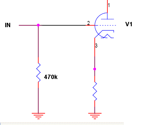

Can you please elaborate on the resistor to ground for the grid?
Is this what you mean?

the reason i was confused from the beginning.....the schematic shows U1b and U2b to be the tube sockets i think.....
either way, i guess the jumper has to goto the #2 pin on the number 1 tube socket
jdbrocious said:the pad to the left of the one circled leads to the #2 pin.... so i would need to run a jumper from this pot to the #2 pin correct??? or do i place a resistor in there??
Yes, that is right the jumper goes there, but you also need to connect the resistor from the junction of these 2 pads to ground. We still need to know what pad connects to ground on the back side. This pad can be located because it will connect to the outside of the RCA input jack. Just solder the resistor to this ground pad on the top side of the board, and connect the other end to the jumper.
So looking at the picture, the jumper goes between the upper right two pads, then the resistor will go to another pad, and then to the jumper. You can also solder on the back side of the board if the board is too close to the chassis on the top.
V1 and V2 are the tube sockets. V1a just refers to half of the tube
, V1b is just the other side. They both are within the same tube though.

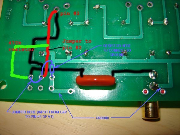

ok, i think im confused here....... but here is a picture of what i think i should be doing
i dont quite understand why im running a jumper to the #2 pin on the tube.... the PCB shows a connection between these 2 points already... sorry for the rediculous questions, but im learning....
try not to laugh at the soldering job,.... it was my first time
and i had to put the c1 capacitor on the other side of the PCB to fit the power switch

You don't need a jumper all the way back to pin #2 on the tube. There is already a trace there on the board as you can see. Just jumper the 2 upper left-hand pads as shown. This connects the input signal coming from the capacitor directly to pin #2 on the tube. Now you need to add that resistor from this connection to ground. I can see that gound buss as it connects to the outside of the RCA input jack. Solder the resistor vertically into the upper right-hand pad as shown. Then bend the lead over and solder it to the new jumper you just added.
See the picture.

ok i have it soldered into place.... look right??
