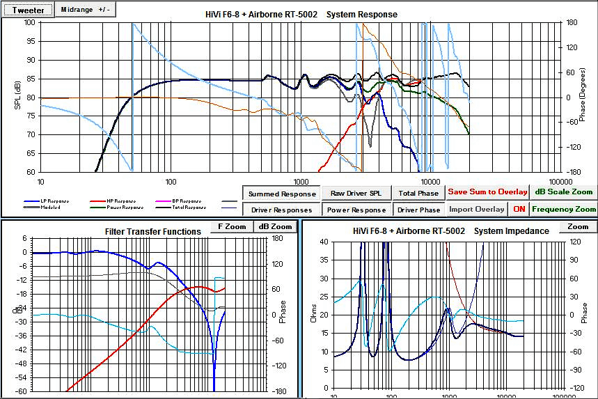

3 meters, random phase, 50 watts -> 95.5 dBSPL. No problema with great recordings and high DR. With films better 100 dBSPL -> you need more than 2 LM3886 by channel or other kind of amplifier.
I appreciate this input. I may not fully understand. Please confirm this: the Nephila kit requires an amplifier capable of delivering 95 WRMS per tower, correct? (AMT=50wrms, F6=45wrms). If that is the case, I get your point. I also like the idea of a Class D. Although, it appears Class D is somewhat of a debated route. Do you have experience in the digital life?

I listen to very good recordings with high / very high DR. KEF Q100 5.25" coaxials, with true 85 dB and about 5 Ohms (KEF says 86 dB and... 8 Ohms 🙁 ).
Calcs are made with 8 Ohms. Then with 4 Ohms, double watts. 4 Ohms, better with two LM3886 by channel.
To 3 meters I want at least an amplifier with 80 watts at 8 Ohms, 0.1% THD, and about 120 watts or more at 4 Ohms. These coaxials love watts (KEF LS50 more!, with true 83 dB more watts!).
Of course, it is better that the amplifier never leave its comfort zone even at maximum demand.
