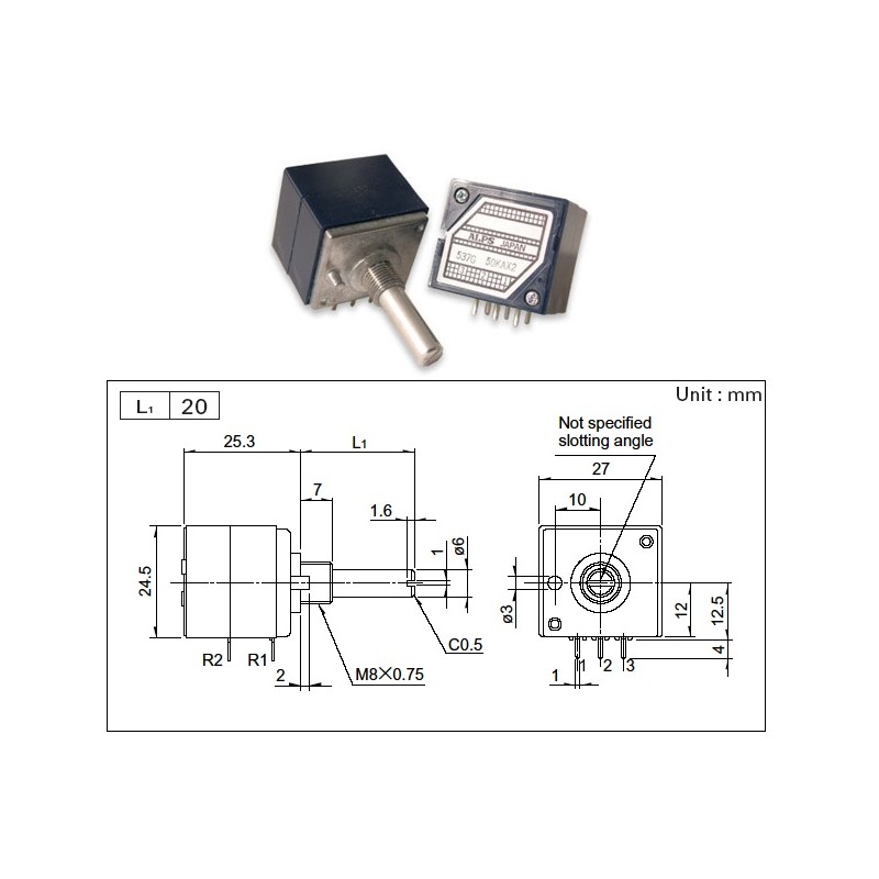

The amplifier kit looks nice(quality pieces), the power supply does not look so good though, to power up the amplifier you just need a transformer from 220V or 110V(depends on your location) to 15-0-15V up to 28-0-28V( i use 25-0-25V to drive 8 Ohm speakers).
For the volume control, if you have the possibility use ALPS RK27 50Kx2.

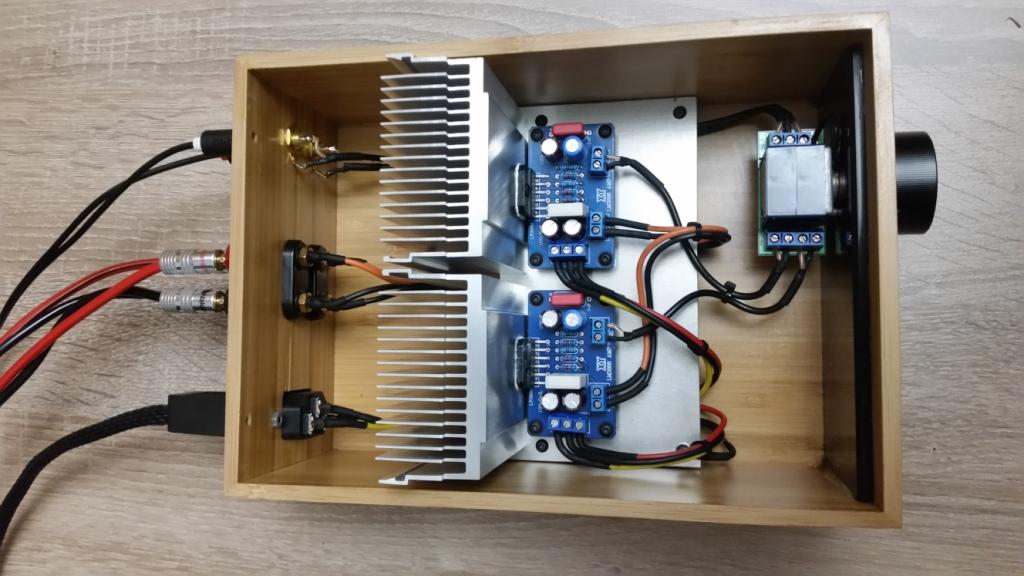

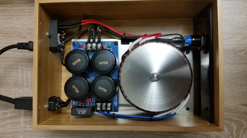

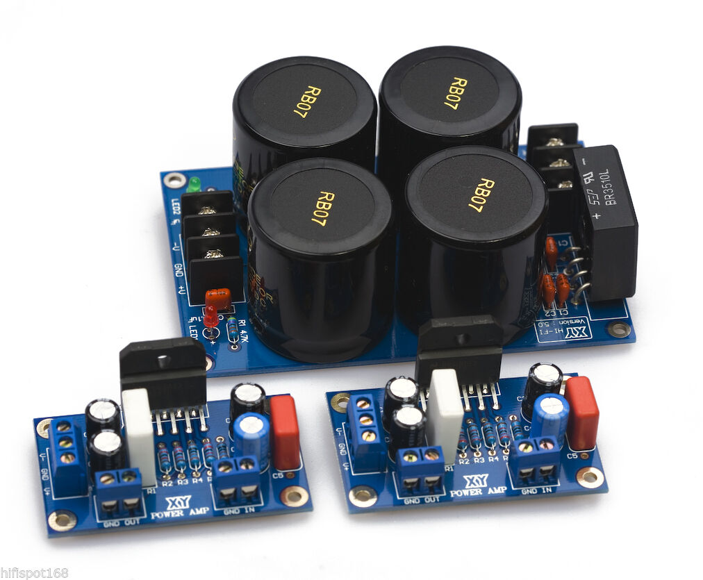

@mrgarison - Which is the signal source? I use a desktop PC as signal source( 24bit, 192000Hz), my RCA input terminals are connected to 50K volume potentiometer than to the signal input of the amplifier... and it works just fine. I have to mention tough, that i am using a different LM3886 kit...more simple than the one you want to use... XY LM3886 kit bought from ebay. In my point of view the reproduced sound is quite spectacular...but i am not a musician...i am just comparing the sound to the other amplifiers that i have build over time and of course i must be subjective. Anyhow every solution is a compromise.

Thanks for that input Mishu, I really like your simple and effective setup. Can you confirm the amplifier I chose doesn't need the Capacitor filter you have used before the Toroidal? Or should I still use one?
What kind of wood did you use to build yours?

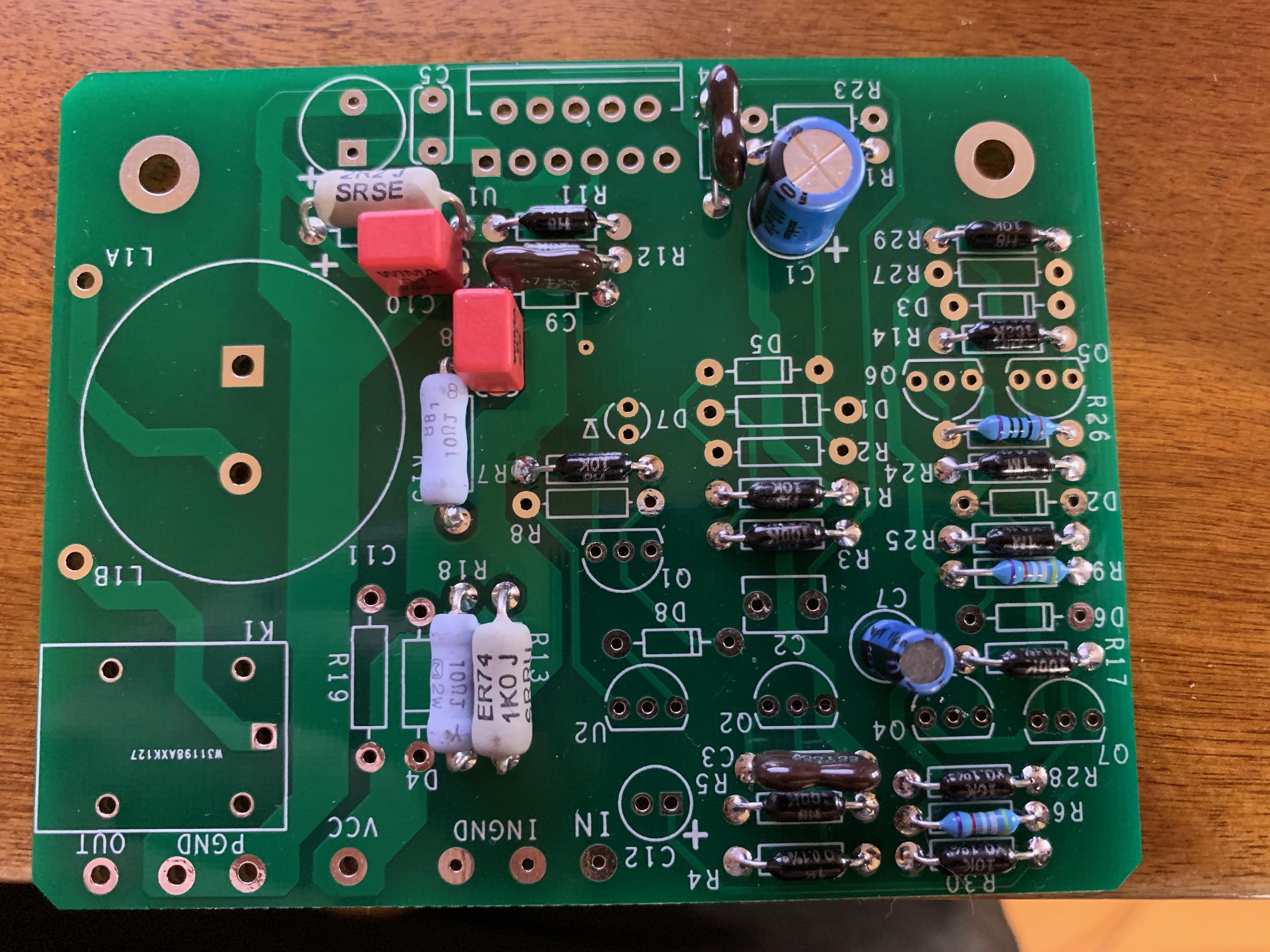

Yeah. Shy away from eBay unless you're just looking to solder some stuff together. I reviewed one of the better eBay boards here: XY LM3886 Kit Review & Measurements
I suspected the LM3886 was fake and contacted some connections at TI to have it analyzed. TI confirmed that it was indeed not a TI product, though it did appear to contain an LM3886 die as I recall. Whether it was a test reject or some other floor-sweep that made it out of the fab somehow is unknown.
If you're after performance, I suggest my Modulus-86. It uses error correction to drive the distortion of the LM3886 down into the abyss. The result is a marked improvement on the LM3886 itself.
On the surface, the Modulus-86 may seem more expensive than a 'naked' LM3886, but in reality the Modulus-86 adds maybe 5-10% to the total project cost compared to the 'naked' LM3886. The vast majority of the build cost is the chassis, heat sinks, power supply, etc.

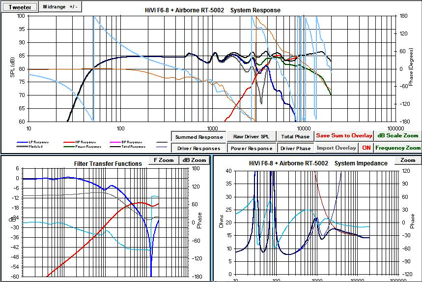

3 meters, random phase, 50 watts -> 95.5 dBSPL. No problema with great recordings and high DR. With films better 100 dBSPL -> you need more than 2 LM3886 by channel or other kind of amplifier.
