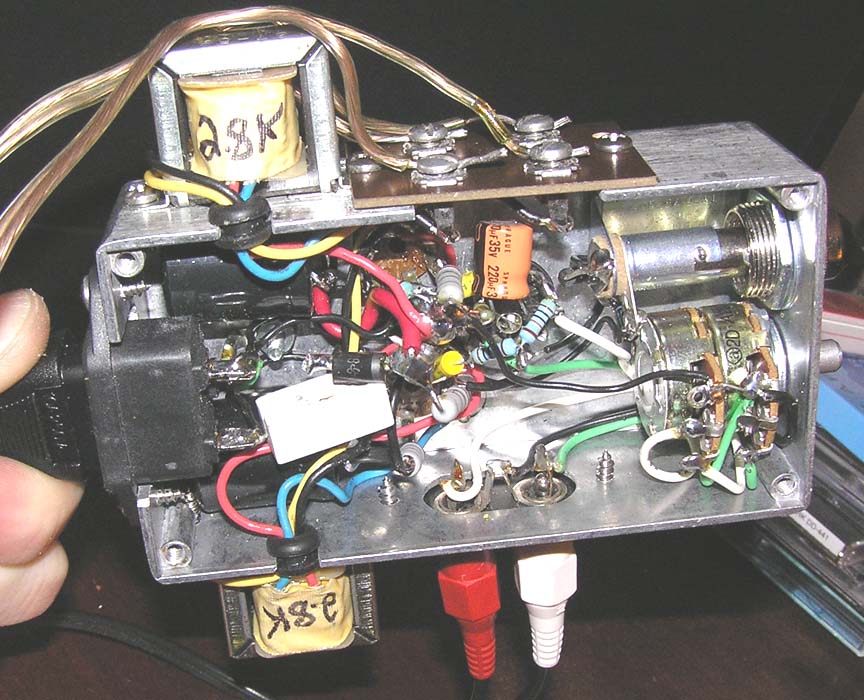

Here is one I prepared earlier 😉 ...

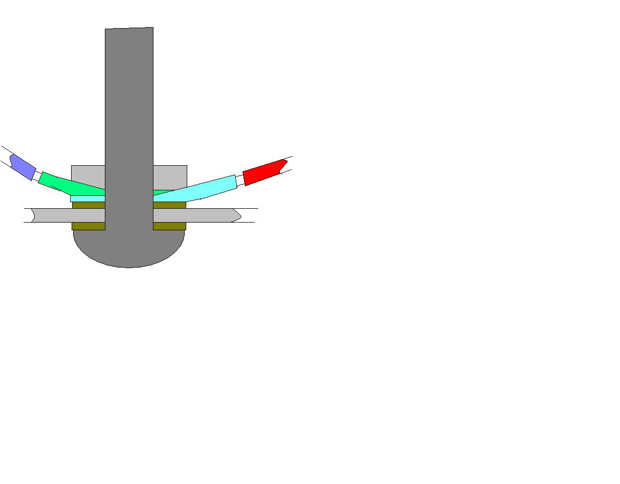

That ground connection....
Dosilegecko: Furthering what Chrish said above, it appears that your chassis is steel, and steel does not solder well. It may be sticking for now, but it won't last long.
That's the most important connection in the amp, especially since it's a guitar amp, your life could depend on it. Use a #8 or #10 screw, a ring lug, and star lockwashers between the ring lug and the chassis, and the ring lug and the nut. Over time, oxidation/corrosion builds up, and the star lock washers bite into the mating metal in multiple places assuring a good ground that lasts a long time.
Fusing the mains hot wire is also important since fusing the neutral leaves the amp live/hot, and potentially ungrounded when the neutral side fuse blows. Also make sure that you are switching the mains hot or both mains and neutral (DP switch), and not switching the mains neutral.

When one talks about 'Area' for grounding I'm refering to spreading out the surface area as your grounds all converge.
Ever wonder why car "jumper cables" have these nasty serrated teeth on them?
It's to get a good surface area by biting into the lead terminals on a car battery.......same thing for the grounds.

Just to cheer you up, here is a photo of my kinda sloppy AX84.com construction. Hum levels are very acceptable.
