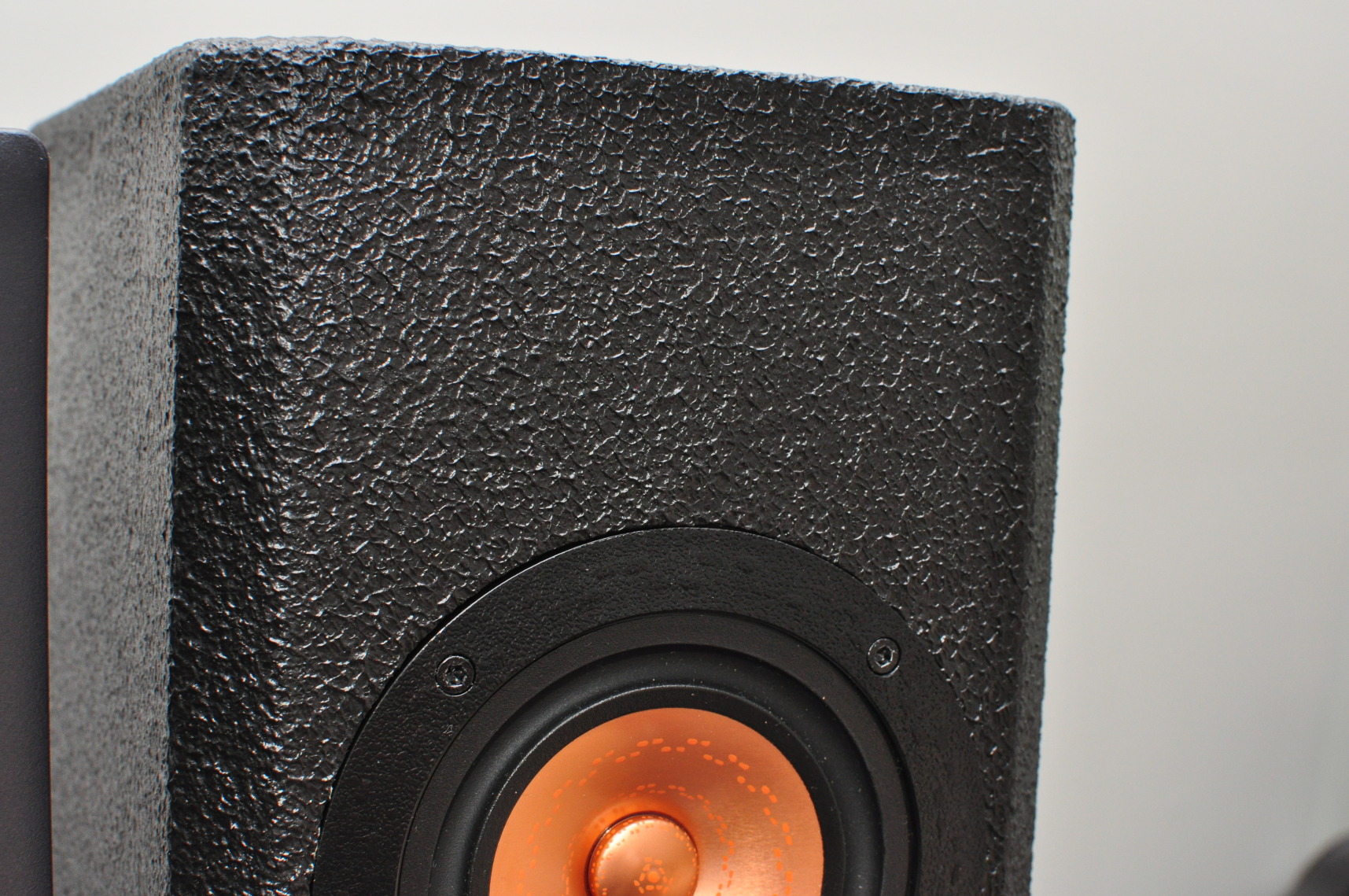

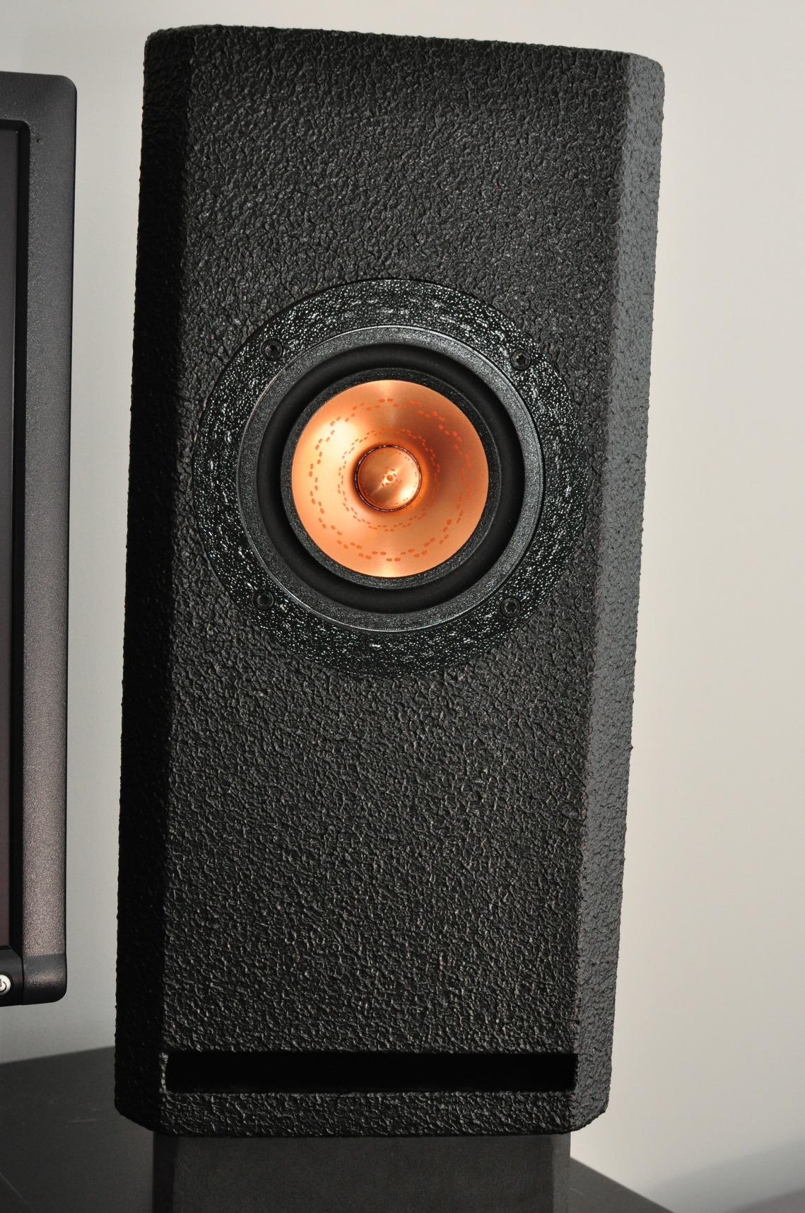

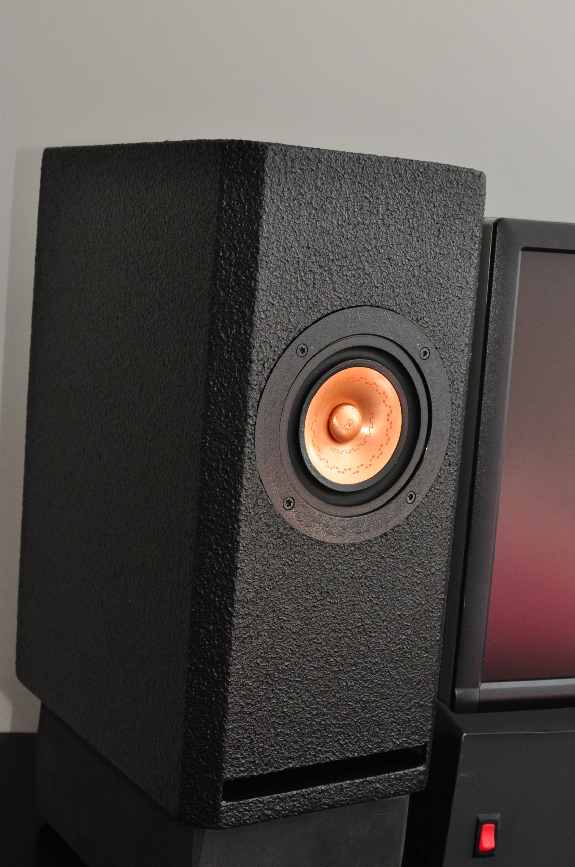

Thanks again for the Duratex suggestion. I was initially hesitant to use it, thinking it looked too textured. Several coats later, I decided I actually preferred the rough textured look. I used at least 2x as much product as necessary. I think one or two coats would have sufficed, but I kept trying for a smoother finish. Once I got a fairly smooth finish, I decided I wanted the rough texture. The wise thing to do would have been to practice on a piece of scrap wood. Anyway, other than using more product than necessary and taking a long time, I'm happy with the finished product. Here's some pics of the finished speakers.
