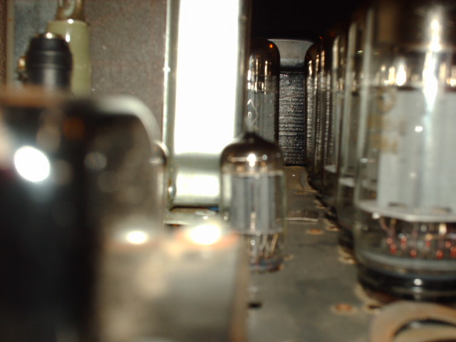

Running a bit warm, still need to optimize the bias circuit. One of the original 6p3s-e used for testing started redplating, it was replaced. This thing runs them like 6L6GCs, and they seem to take it. Screens are dim, no red plate in dark room.

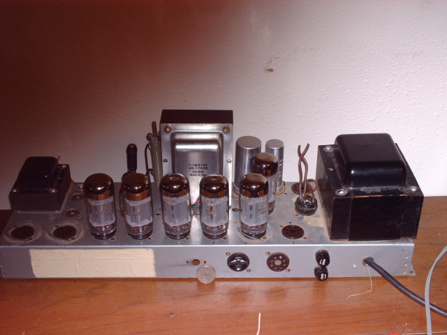

Here's some pics and the spice file (with .INCs). Any comments, improvements, etc. are welcome. You are welcome to use this design or its improvements for any non-commercial use, assuming you'd want to. Commercial use of this design requires contacting me. It's not anything special anyhow. I won't be posting PCB layouts, it's all point to point. Parts were around $300, can't remember it's mostly stuff I didn't need from other projects.

Incidentally, I am not entirely sure about the inductances on the OPT in the spice file. 689 watts (105squared/twice8) is so ridiculously high that I am sure I mucked that up. In any case, the OPT is only rated for about 100w "guitar" so even if the amp can swing it the OPT will probably melt. Primary impedance is 1700, DCR is 19 and 22 to center tap from each side respectively. Oh that's a quarter in the front view, for scale.
I'm afraid you got the math wrong. 105 Vp-p has to be divided by 2 and then by the square root of 2 to get the RMS voltage which for you is 37.12 V RMS. Square that and divide by 8 and you get 172 Watts - not humble for a tube amp but not 689 by a long shot.
Was aiming for 100W, glad I got more. The 689 seemed to be a math error, since the equation I got for RMS power was (Vpk^2/(load*2)). I probably have an erroneous equation! I calculate approx 154w pd, so any more than that would be nonsensical. The transformer can't handle much more in any case!
Actually, that's comforting since the result is within my current OPT's spec. I was quite confused w/regards to the RMS wattage based on my equation!
