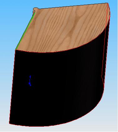

Finished subwoofer idea.... what do you think?
After Tom Danley's suggestion in the other thread this is what I've come up with for the final DC motor driven design
that's a 24x30" cone... each opening is 25x30" and is 60degrees from the center line of the curve
it allows for 30" of one way movement in each direction and is dipole... designed to be optimal in such an exclosure
2HP servo motor... with 300vdc and 5A.... (already bought this)
cone will be carbon fiber over foam (needs internal dampening) shooting for 1/8" thick carbon fiber epoxy resined
BB6 says 4800cm2 of cone area moving 5" one way (the suspension will allow for 22" one way) yields 133db at 10hz.... at least with a 1500 gram cone weight 😉
if I can get a stable 10+ inches you're looking at around 137db at 12hz or so in dipole...
I'm only looking for this to play to about 35hz or less...
any suggestions?

In that case,
1. Dipole will have a whopping SPL of 0db . + & - waves of the same magnitude travelling the same distance net to zero. The front of your speaker would be your dipole null. One side of your contraption needs to be in a box or separated in some fashion, and not just a divider with them both still facing the front.
2. Your cone will be traveling very different speeds depending how far the point on the cone is from the axis. I think this will cause significant doppler distortion.
3. If your motor will work like you think, wouldn't it be less problematic to drive your cone in a pistonic motion?

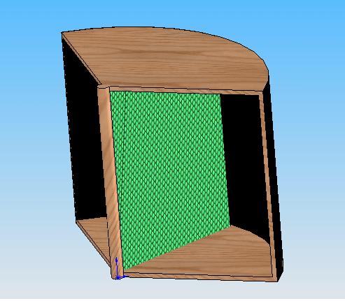

Additionally, it sounds to me (although I may have misunderstood) that your SPL calculations were done with pistonic travel in mind. In your case, however, one edge of your 'cone' is stationary. As such, the swept volume of a given displacement of one edge of your 'cone' will be half that of a 'cone' that is not stationary at one edge.

this is the problem with the CAD ... it wasn't exactly clear... there will be a type of compression panel aiming the backwave 180 degrees from the front wave... I just included the musical element itself
2. this is the same method the PG cyclone uses for servo's... so I'm not sure if this was an issue for them...
3. I can and may in fact do a simple down firing element... problem is coming up with a workable rotation to linear converter with only one "pumping" action vs. the dual action Tom's design for the contrabass... there's the very distinct problem getting the moving mass low enough this way
to apply a pistonic SPL calculations all you do is take the mean (center) of the moving element and how far it travels... which is 15" one way max...
this will give the you mean (average) excursion at 30" one way (this is how far the outer edge is traveling)....

Nope. That will significantly understate your air moved. Back to geometry class we go. :bawling:
hhahaha well yea haven't had math in years, it made sense to my poor math skills... I went ahead and figured it out though 😛
it's roughly 161.48L Vd one way... this is 26" around the "circle" there's roughly 27" from rest position and the opening around the edge of the circle part

If it were me.... I would make this an IB "sub." Bass modes at extremely low frequencys(below30hz) typically are inexistant anyhow and the achieveable SPLs would be incredible.
With your existing design there will be INSANE mechanical vibrations from the unbalanced rotation. a good idea might be to put a weight on the other side to counterbalance and steady things up

IB = Infinite Baffle. You'd put in a wall between two rooms so that the front side would go into the listening room and the rear would go into the other room whatever it may be (an attic crawlspace, garage, etc....) That would isolate the front and rear waves increasing spl as frequency goes down by 12db/octave(I think) over a dipole.
You can slap as much weight on the box as you want, but at even 1lbs of moving mass if its moving 10+ inches at even 20hz there's going to be alot of inertia at work.
When developing the cyclone PG struggled with keeping the fins light and strong enough.
Their solution was to use a foam-core with a carbonfibre skin, thick at the base gradually thinner towards the outer edge.
