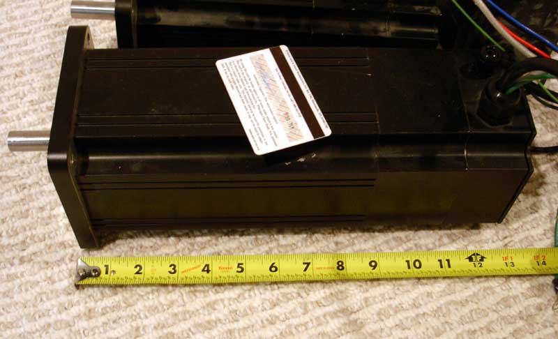

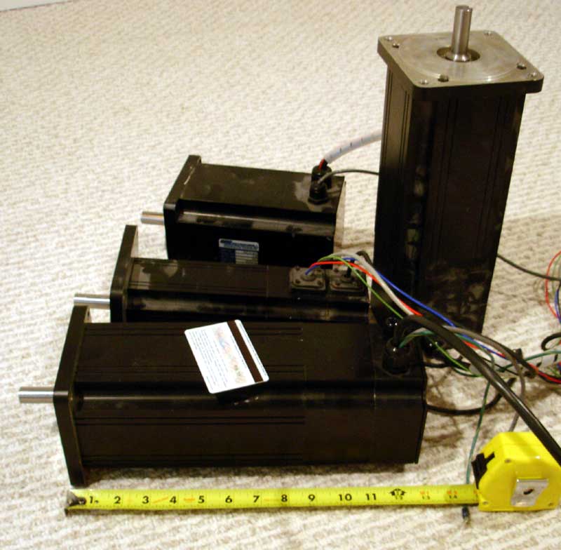

just to give an idea, here is some of the bigger ones:

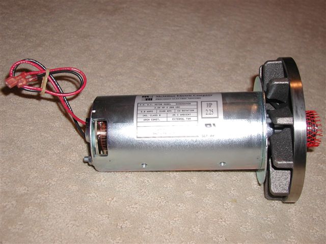

no I haven't received it
guy said it was a brushless servo motor... it's it's not w/e I guess I'll pick up another one...
here's a picture
what's the efficency difference between a servo and normal DC motor?
is it worth grabbing another one??? this one was only $20 for 2.25hp at 280vdc

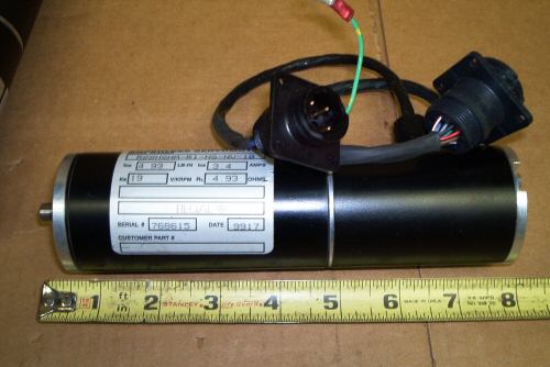

HAHA I don't know you got me... I haven't received it yet man so he could be fudging to bump up shipping 🙁
it's a 2.5" tube 7.5" long... that's a big piece of steel 😛 or lead for that matter
what are all these really large plugs coming off of a servo motor??
how would you rig this up with with just a postive and negative input?
im not an expert, but that ISNT a servo. its just a DC motor.
some of my servos have as many as 11 wires coming out of them, and then they have dual output encoders which have another 7 or so...
a servo is basically a high-efficiency dc motor that has an encoder attached. servo basically means "feedback" or "closed loop". thats why you see servo used with velodyne subs. they have a closed loop system with an accelerometer and comparator circuit.
same with dc motors. a servo controller accepts feedback from the encoder and sends appropriate dc signals to the motor to move it precisely. this is not possible unless the motor is precise and efficient.
that seems awfully small for a 2.25HP motor. the motor on my milling machine is 2HP and is around 50 pounds and about 1.5ft x 1ft. its not very efficient of course, but still, its HUGE.

in regards to your most recent post, see this post 🙂 those are all the wires for the encoders. well, im just saying, lead is heavier than whatever that motor is made out of... and a piece of lead that is LARGER than your motor weighs around 1/4 of what he says it is.
if i can figure out how to wire one of these up, ill test this whole deal out.
