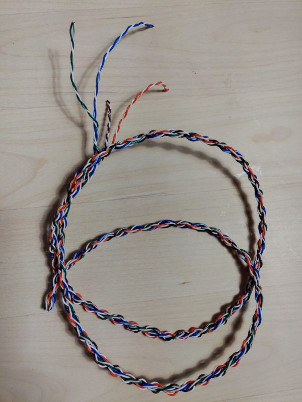

I did a braided speaker cable from a cheap multistrand wire Cat 6 cable. The cables are about 4 meters long and used for the speakers in my study. I use them mainly for background music when I work, so no real reason to turn up the volume.
The picture is from a short cable I'm will use to try out between my volume control and power amp.
I have no idea what the impedance of that cable is going to be. Anyone?

The impedance will be that of a single pair divided by the numbers of pairs.
If the pair is 100 ohms, 4 in parallel will give 25 ohms.
But only if you connect all whites together, and all colors together.
I had a tech make a 15 foot run with 6 cat5e cables paralleled, 24 pair. It gave me very close to 4 ohms, I used it to do a ten microsecond risetime 40 volt pulses into a 4 ohm serpentine stainless steel resistor immersed in liquid helium, the waveform was perfect, no reflections.
For speaker runs, I would never recommend more than 4 pairs if you want to play.
