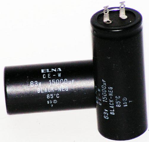

I have a question regarding the PS, and the large caps (10000 uF 50v Panasonic TS Capacitors (35mm x 30mm low profile)) ... Is it possible to replace them with 15000uf 63v ELNA? (see the attached picture)

63V caps are a waste for a chipamp PSU.
They are more expensive and they are bigger.
Use 35V or 40V or 50V smoothing caps as appropriate for your chosen transformer.

I dont mind the size, and the reason for using them would be that I already own them .. 🙂
