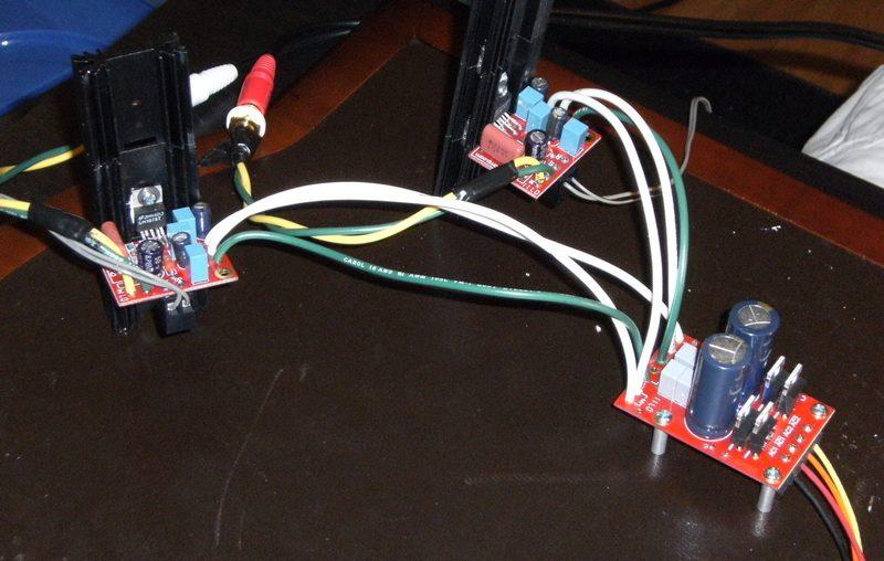

-power off the amp, and wire the secondary windings from the transformer into the AC1 and AC2 terminals on the power supply board. Here is a picture:
(AC1 = black, AC1(bar) = red, AC2 = orange, AC2(bar) = yellow)
-Wire one of the GND connections on the PSU board to the chassis ground.
-Once the transformer secondaries are connected to the PSU board along with the chassis ground connection, power up the amp to check the output DC voltages. Measuring from GND to V+ and from V- to GND should show ~25vdc if you are using a 2x18vac transformer.
-The LED on the PSU board should also be lit up, if installed correctly.
-Once the power supply voltages are verified, power the amp down, and wire up one amplifier board to the V+, V- and GND connections from the PSU board to the amp board.
-power up the amp again, and check the DC offset of the amplifier with the multimeter, by setting it to the minimum DC voltage setting, and measuring from OUT to OG. You should measure between 10-30mV, but under 100mV is acceptable.
-if all checks out, power down amp, and hook up the other channel and test it.
-once both channels are verified, connect the RCA input terminals to the IN and SG connections on the amp boards for both channels. Also connect the OUT and OG connections on the amp boards to the output terminals on the chassis.
-power the amp up again, and test the amp with a test speaker for both channels.
-Once all is verified, connect to your system and enjoy!
(note, this is a quick rough draft of the manual, and I will work this into a manual for putting together an LM1875. Let me know if you spot any issues, or have any comments)
Brian

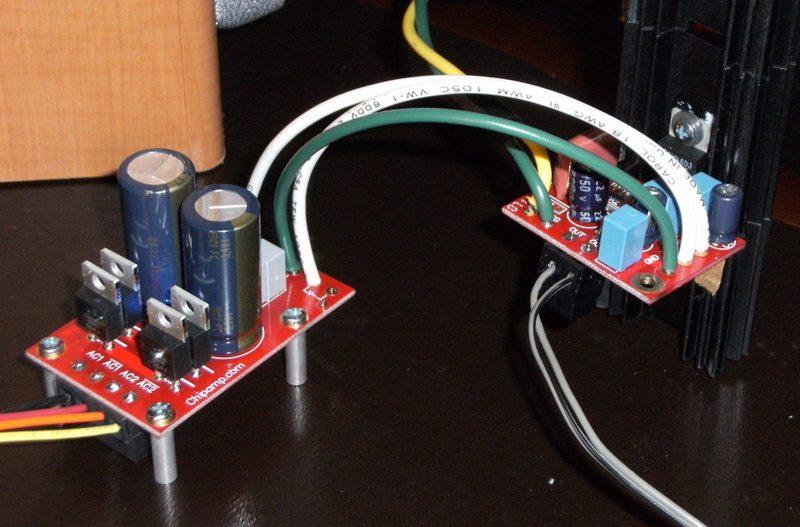

Here is a picture of the wired up amplifier board:
Note: I would highly recommend using different colors for V+ and V-. For this amp, the wiring as done with what I had on hand, and will be rewired for the final chassis setup.
I also installed output terminals for the output connections under the pcb, so that I could wire the test speakers directly into the PCB. For the final chassis wriing, the wires going to the output terminals will be wired directly to the PCB.
For heatsinks, I tested with the small heatsinks that I had on hand. With a single heatsink per channel, they got quite hot, so I connected 3 together to obtain a reasonable temperature for the heatsinks. We were able to run the amplifier at full power, and easily overwhelm the test speakers. At full power, the heatsinks were a bit warm, but not to hot to touch.
Note: make sure to insulate the heatsink from the LM1875 package, as it is not insulated like the LM3886TF chips.
Brian
