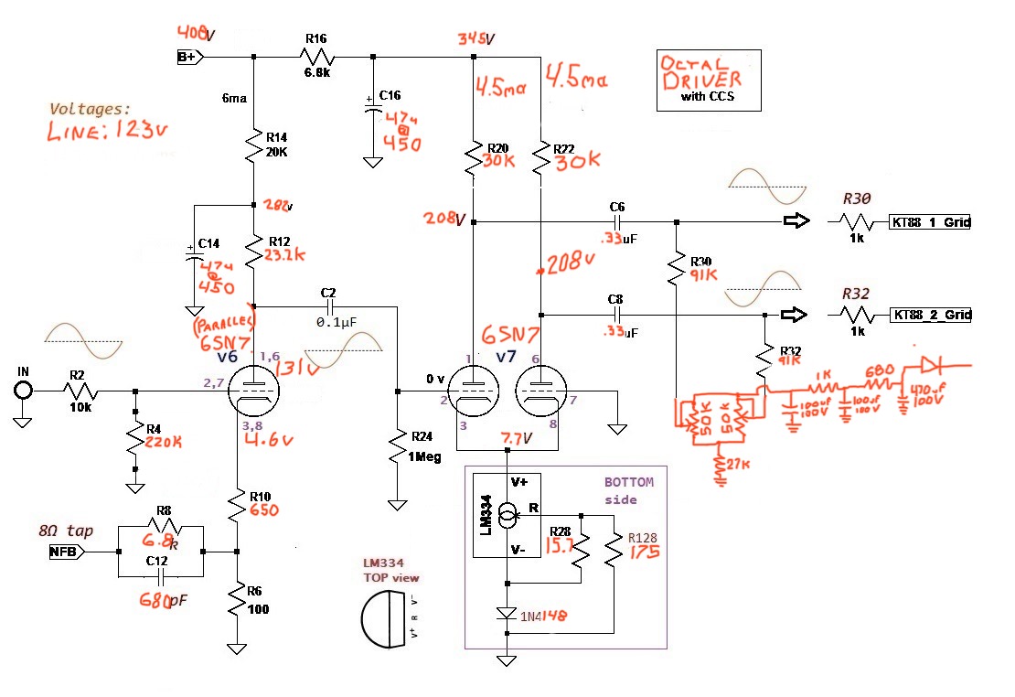

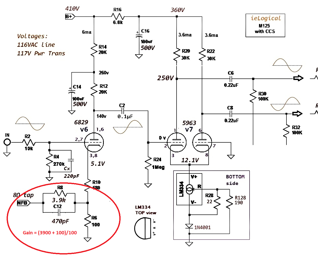

Here is the close loop gain that I was talking about. "Hot", I mean the gain is too large. Usually, the overall gain should be around 20, so that the amp will not pick up some noise easily.
Regarding feedback point, just use the 8 Ohm tap, unless you own some 16 Ohm speakers.
PS: Before tinkering the gain and feedback, you'd better build the kit as intended way first. Make sure it does work as designed. Then you can mod the gain as you need. Watch for any instability issues. With sqarewave, overshoot is fine, but you should avoid any ringing.

Sorry, “normal” means the majority tube amps have the voltage gain about 20. 20 voltage gain is 23dB. The original MK III has about 22 voltage gain with the 16 Ohm tap.What I don't understand is "normal" gain? When you say normal is 20, are you talking about 20db? I've been referring to voltage gain. But normal for what, this circuit? I just don't understand, you must be talking about a specific circuit with specific operating points.
Oh now it makes sense. 1.5v input to 23v out, 23.6db. Speaking of the 8 ohm tap, of course. Of course the amp up to the OPT has much more, but voltage is dialed back down after the transformer. I still get confused about db sometimes. I think about power doubling every 3db, I always remember that one speaker sensitivity considerations...

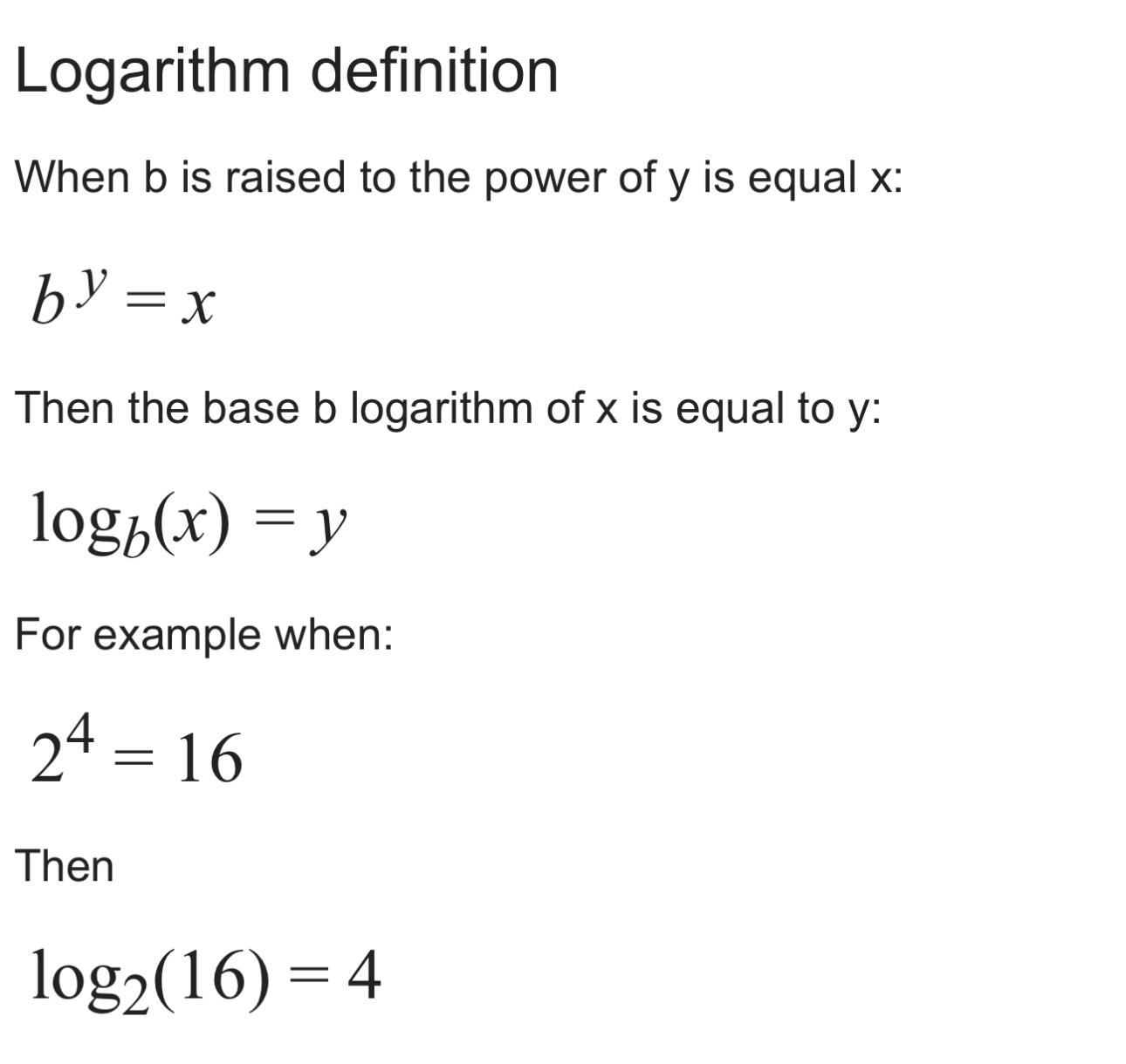

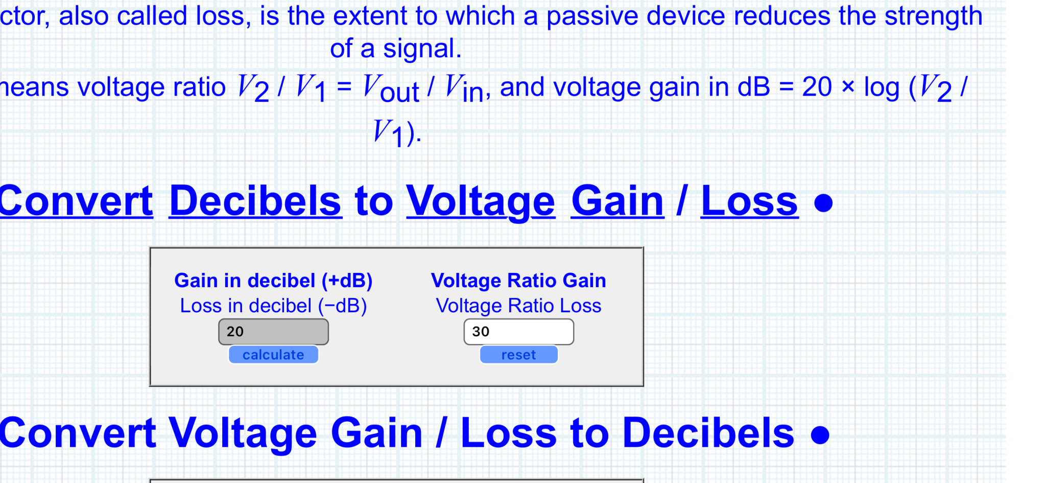

Ok so thank you for that. I'm still having a little trouble with the math. Here's a pic of the calculator I've been using, and the equation I'm trying to figure out.
db=20 log(Vo/Vin). So I headed over to some other sites to find examples and figure out how to solve these,
So, reversed it is 20*log(Vo/Vin)=db
Which means log(22v-1.5v)(20)=db
So log14.6*20
And I come up with 1.1643...x 20= 23.287db
I'm sure I'll be using the calculator to find the common log of the voltage gain for a bit, but that's ok. I wanted to know the math, and now I do. I knew of the logarithmic scale, and basically how it functioned, but reading up on it I did not realize there were different logs (bases). Other parts of the history were super interesting too, like where the name decibel came from, and some of the historical uses the equations held.

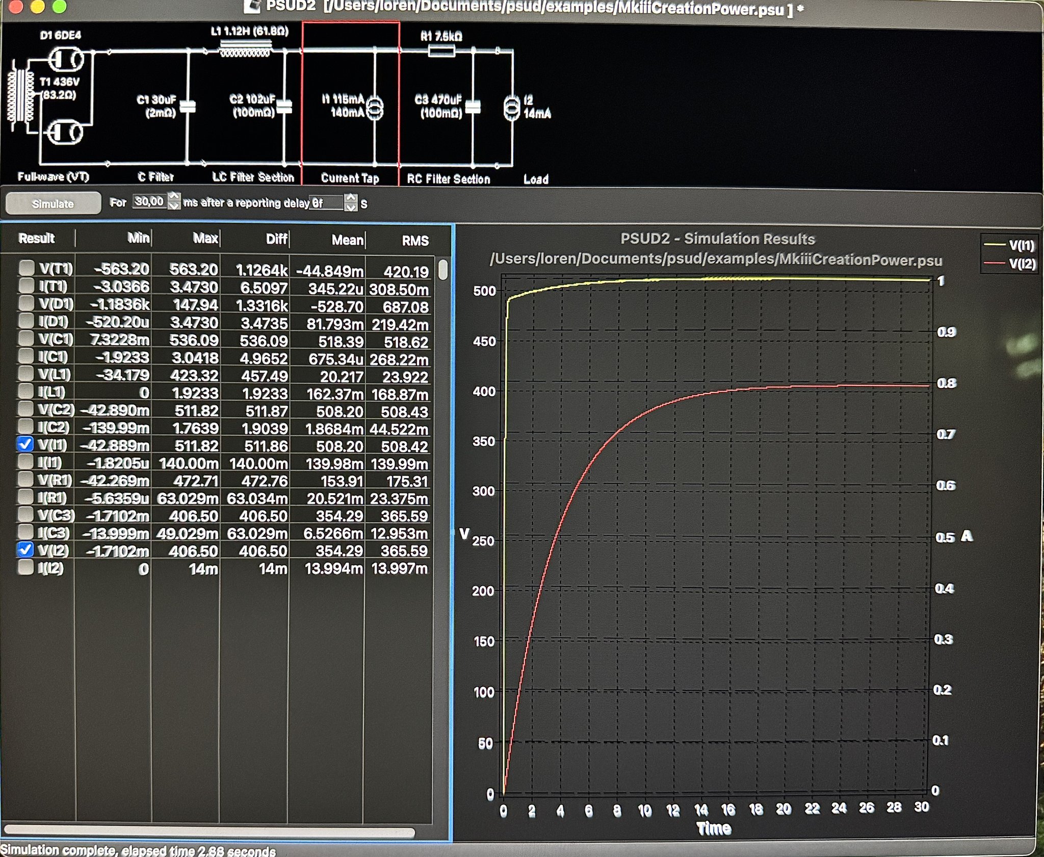

Hello again all. Work has been really busy this time of year (construction, before rain hits) but I got to sit down for a few hours last night. I've got more on the chassis now, binding posts, choke and fuse, rcas, octal sockets. I'm trying to figure out where I'll put everything, before I put it there. So, it was time to open up PSUD2 and see what and how many things I still need room for.

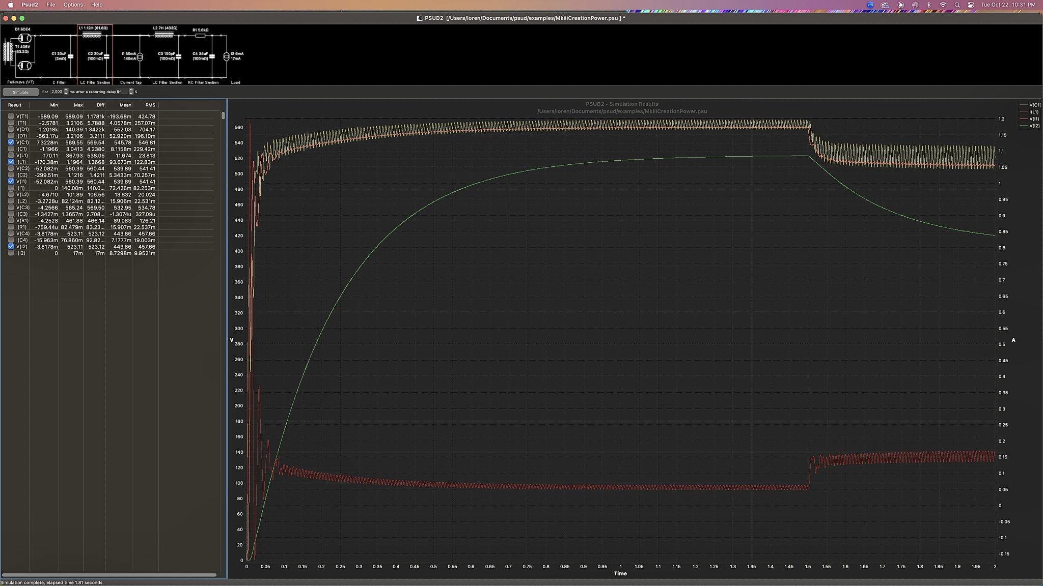

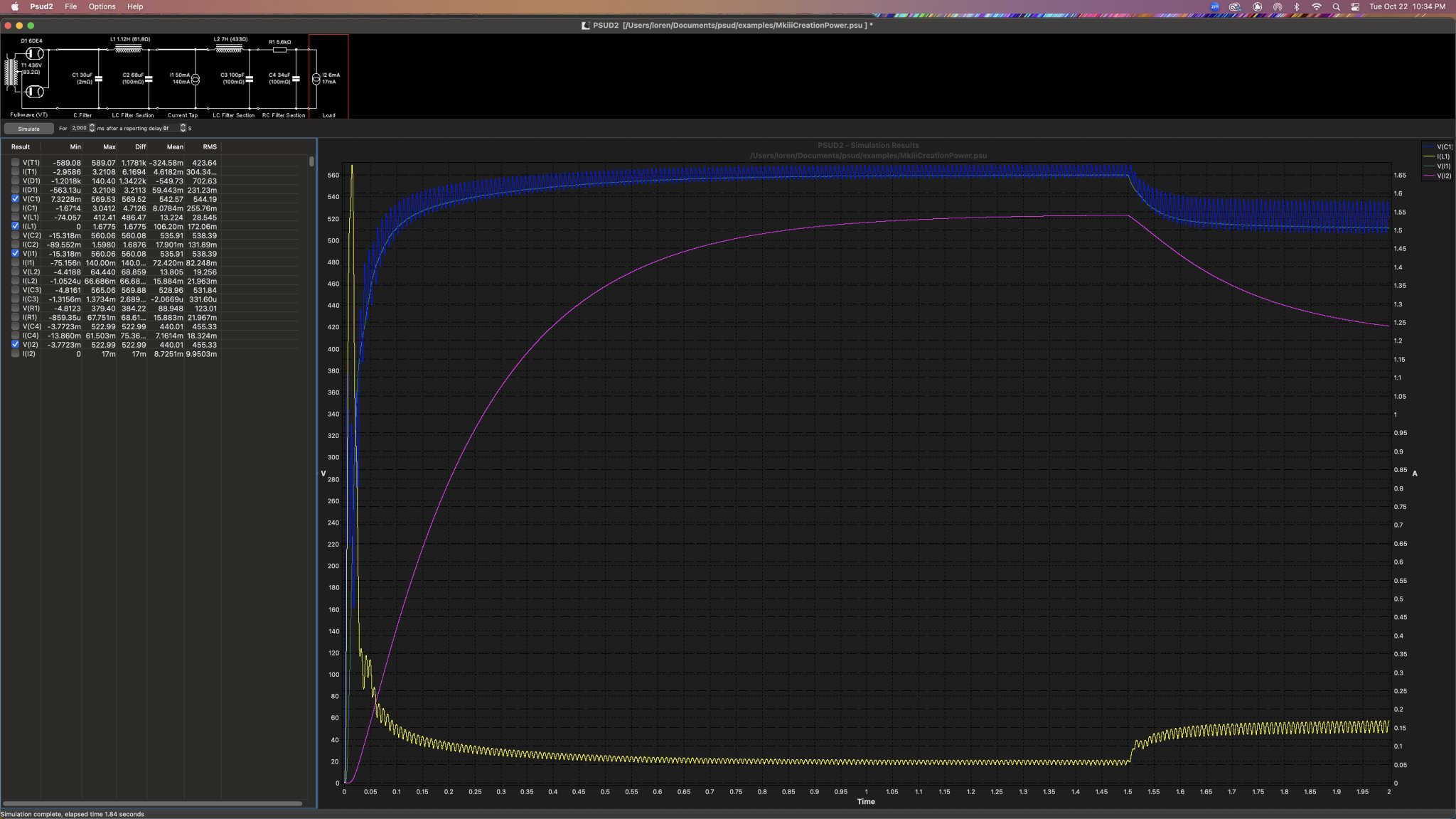

First I wanted to see how the supply faired wired as stock, with extra choke filtration for the drivers and input stage. The ripple was satisfactory, but I wanted a little better, and a little better transient response (I'm using a stepped load to see how it reacts, I know not perfect, but helpful).
So I increased the second cap. I've always wondered why Dynaco made the first cap larger, don't see that often. I figured less stress on the choke, but when I modeled it, it was such a slight difference it still made no sense. Anyhow this is where I fell. First cap is a 30uf film 600v>stock c-354 choke 1.1H>68uf 550v (2 sections of 105degree can cap in parallel). This gets me down around .01% ripple, better than I need. The 7H>34uf (3rd section of can)>~6k>47uf then makes ripple less than I could read.
To finalize results, I needed to pick a rectifier and get down around 500v raw B+. I plan on hexfreds and using the rectifier as a slow start/dropping device. Also, we'll see, I may very well have enough voltage on the 5v winding to run a damper diode (that's why you see 6de4). But I got to thinking, I'm not 100% on how much voltage the device would drop in this application? With the 6de4, it's probably real close to what psud would model. But if I went with a full wave 5v rectifier, then I would have both sections in parallel. So would this halve the resistance and voltage drop, approximately? I looked all over for this particular question, but could only find references to parallel when people were needing more ma. and were so doubling up on full waves.

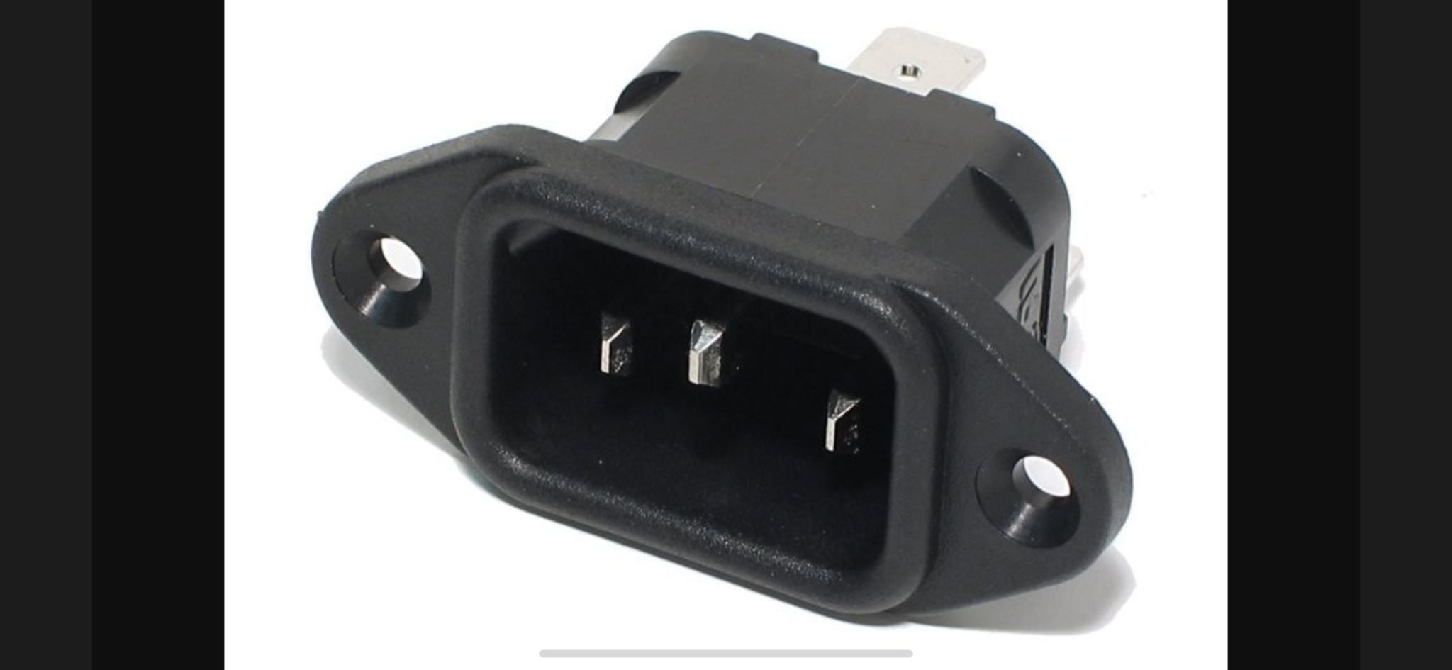

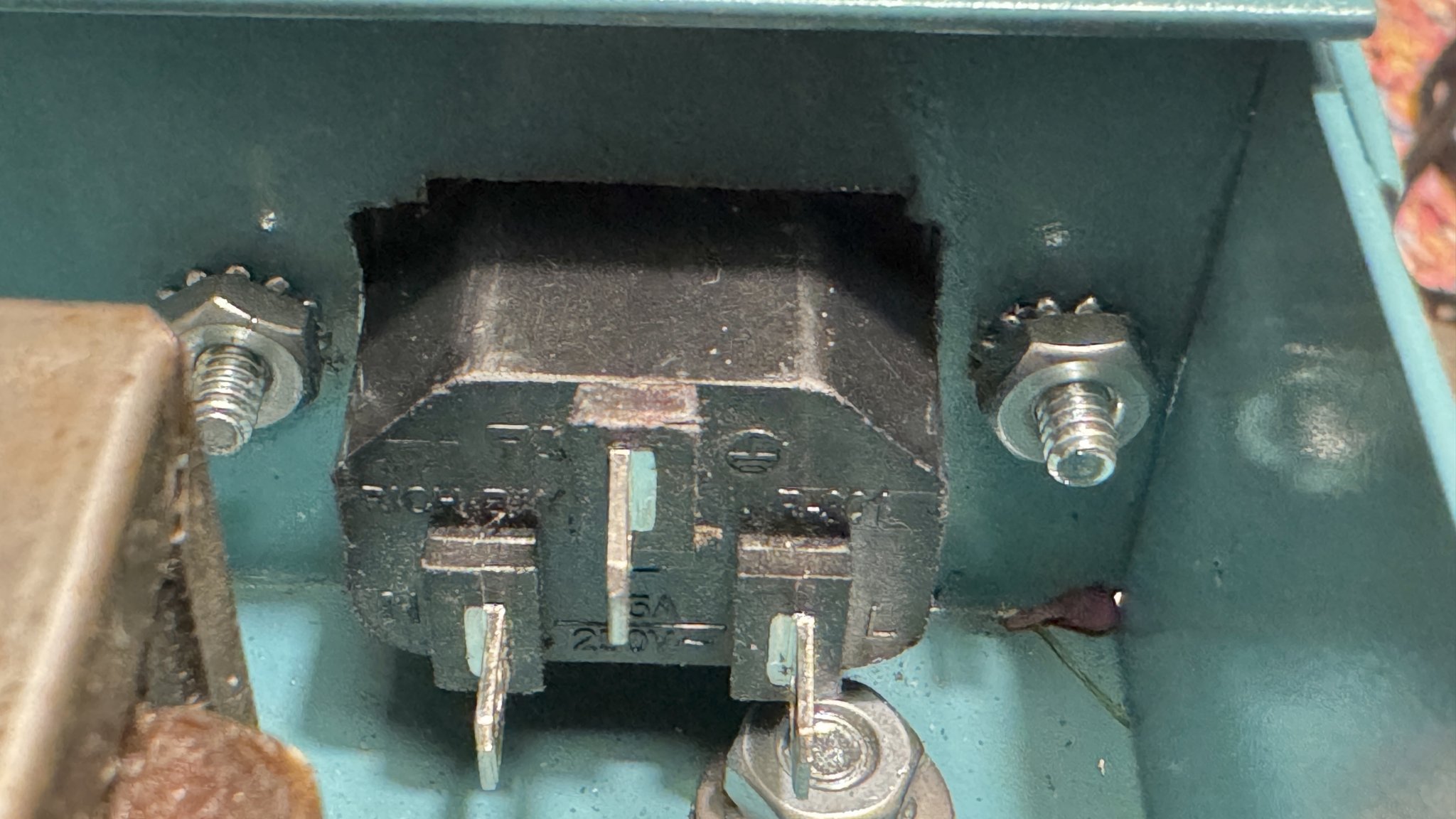

How did you make the cutout for the power socket? I have struggled with that, even in aluminum chassis that are easier to cut.
I just use a sheet metal nibbler, a handheld one. I must admit it's a little tough, but probably wouldn't be if I invested in a good quality pair of them. I'm sure there are longer handles and other means of more leverage for the better nibblers. If you have to do it on a painted chassis, just tape around your hole so the face of the tool doesn't scratch the paint, and make as many drill bit pilot holes as you like. By the time I get the nibblers in there, it's really just for the corners that the drill bits leave. Then last I get the files, so I don't take too much because there's no do-overs on power sockets.

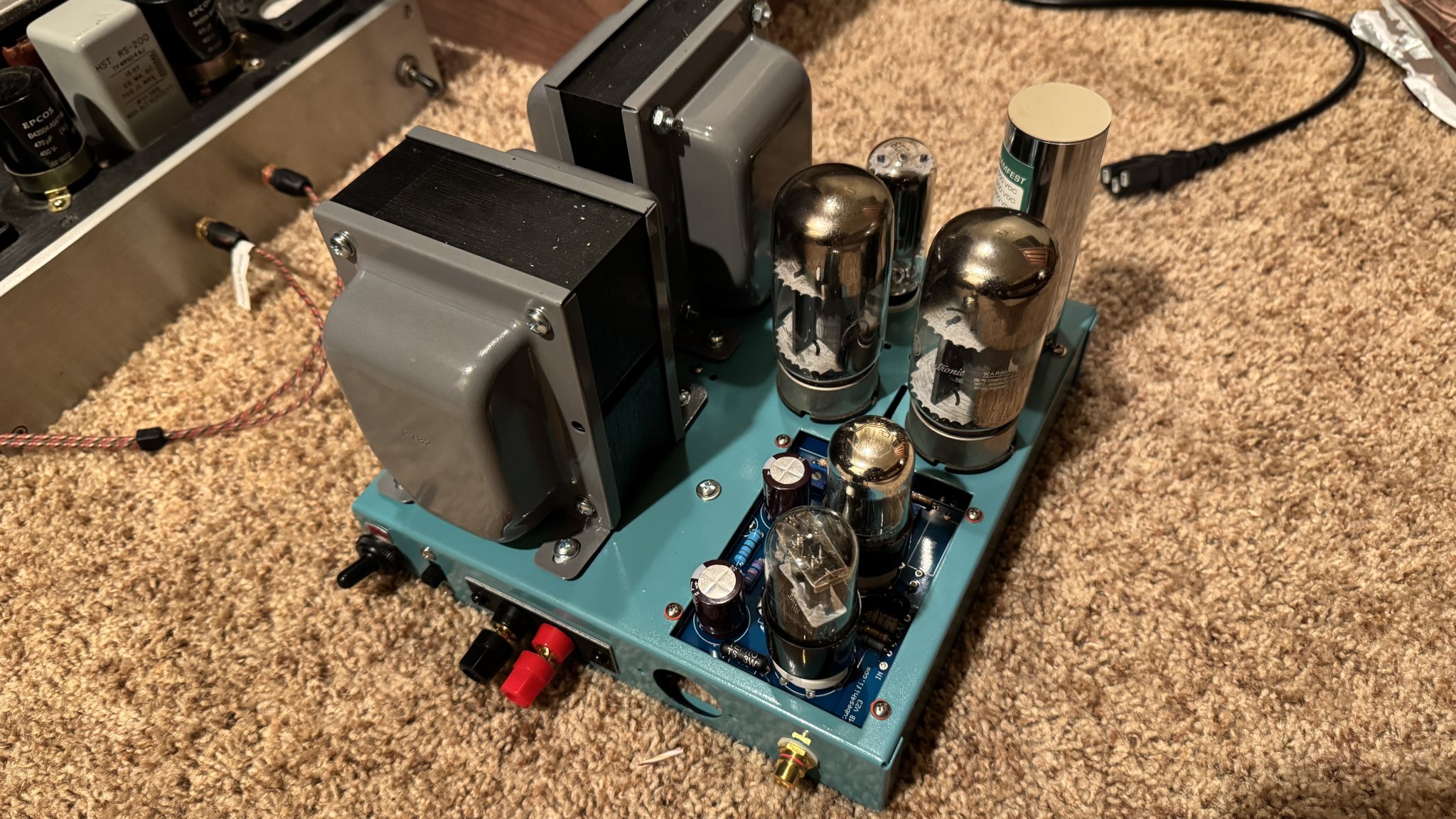

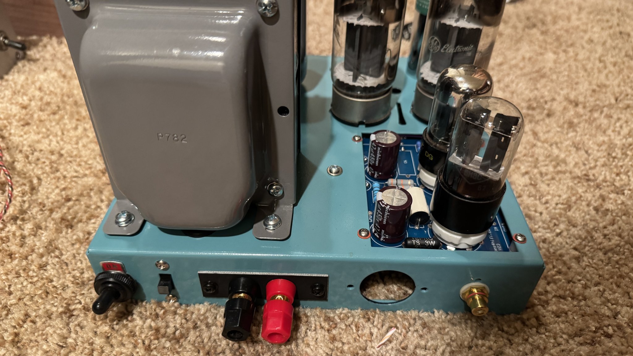

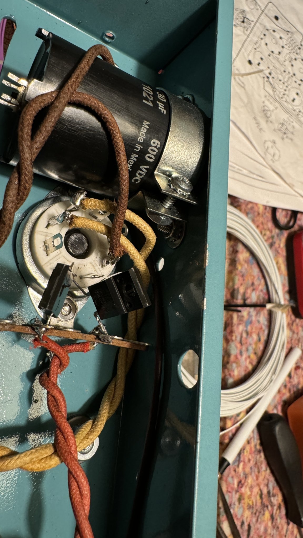

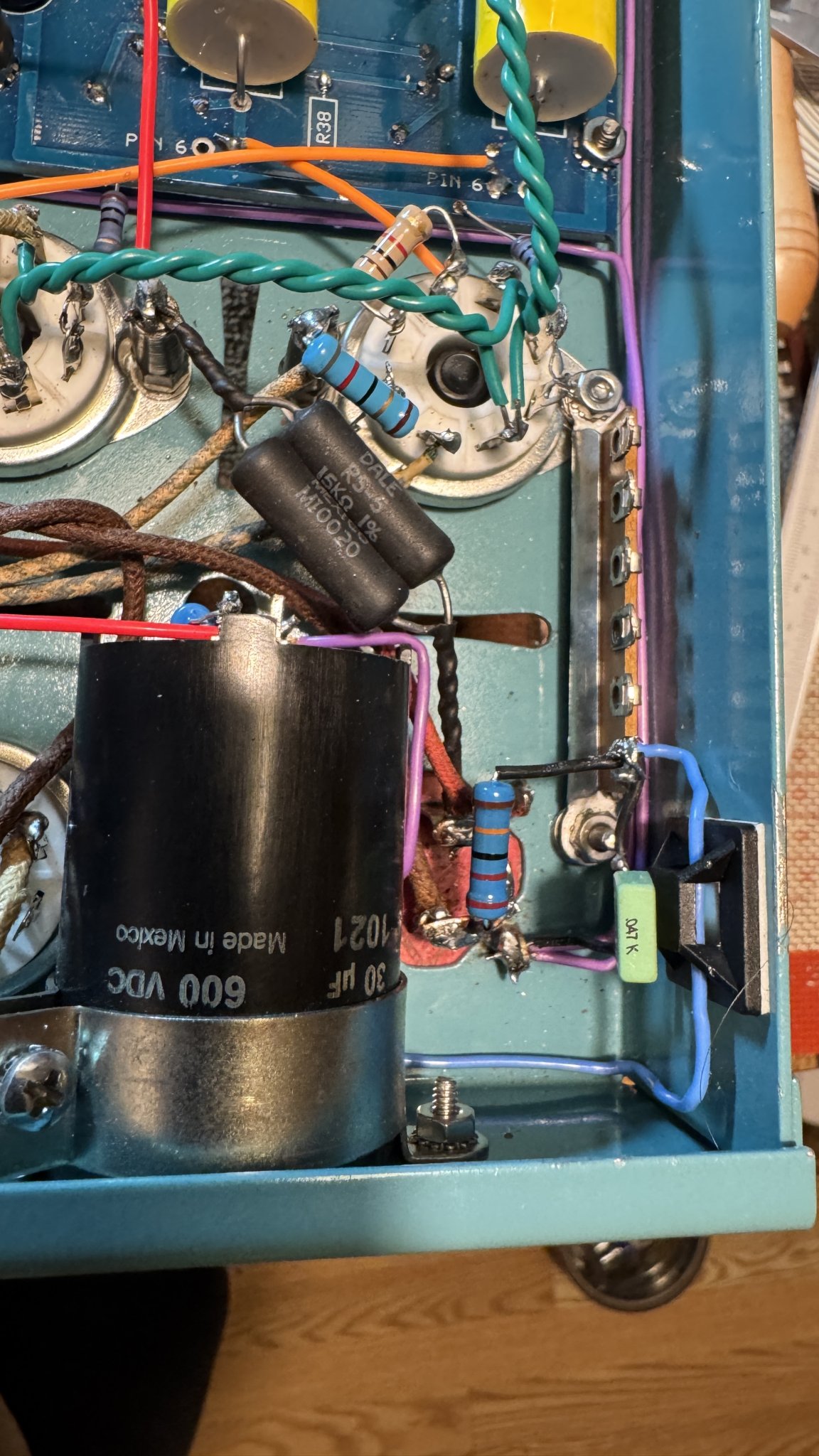

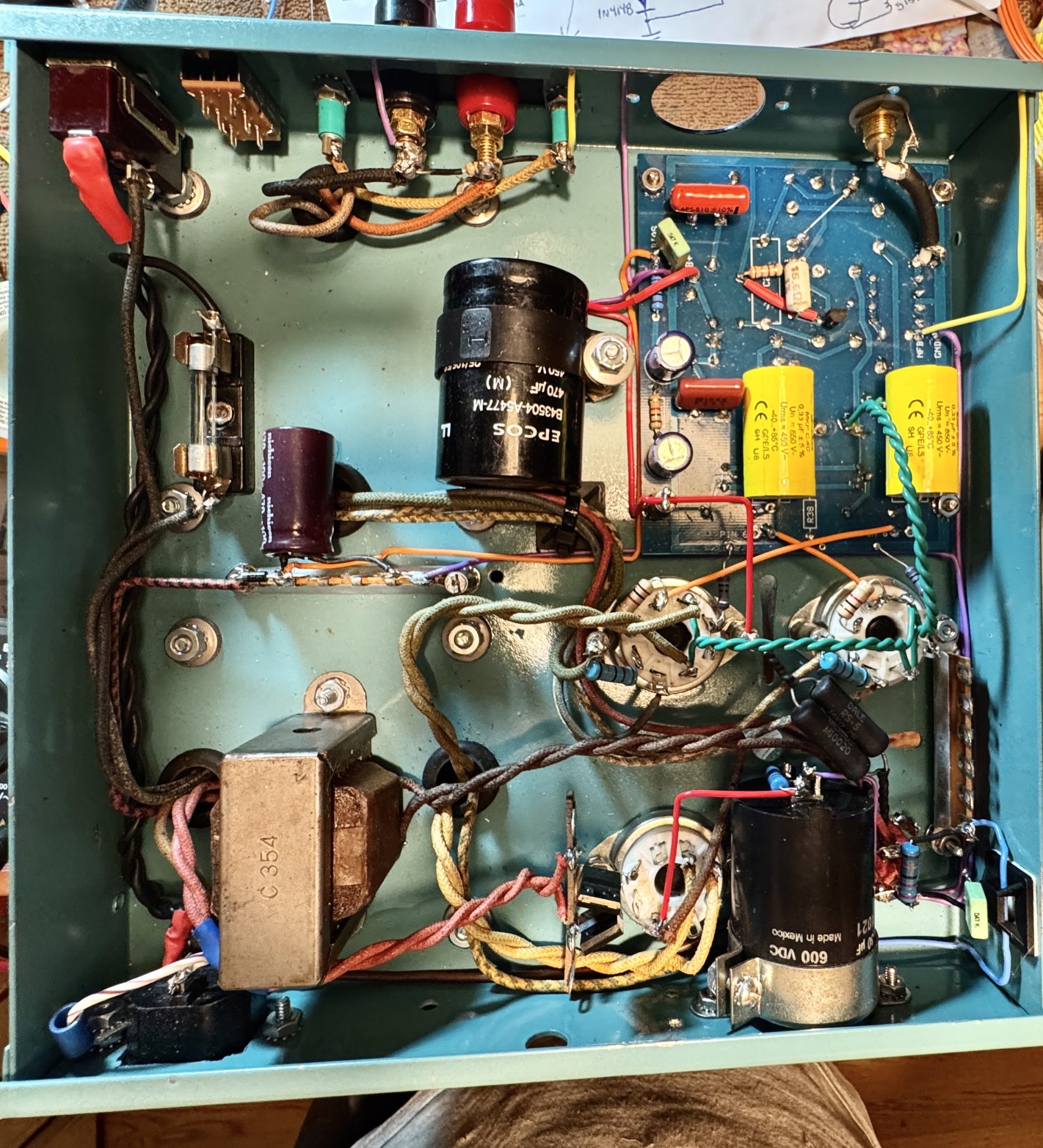

Progress has been slow, but last night I finished one of the amps. Sound check after I post this, but the voltages are where they're expected to be and amps are stable&mechanically mute. So let's see, I left off with adding the IEC outlet. Huggygood, I procured a 6.5"x6.5" throat coping saw, like that. Of course after completing both chassis sockets haha, but they turned out alright.
I'm re-using the original fuse block, a dpdt switch I had, and so it was time for power supply. I ordered a 34uf550vdcx3 can from Hayseed Hamfest, (I like the look, and supporting domestic makers), and have plenty of my own hv caps. I decided on a 600vdc 30uf film for the first cap. I'm using a 6DE4 bypassed with 1.3kv uf diodes for rectification/slow start. It's using the 5v taps (heater floating for now), and so voltage comes up very slowly to 524. I'll lower that later, and or elevate kt88 cathodes.
Fit right nicely in between the rectifier and can cap. Next is the stock 1.5H 50ohm choke, and then on to the combined can cap which measures 105uf. There's B+. After that, a pair of 5w 15k resistors =7.5k to drop the B+ down to 408v, as well as a beefy 470uf 450v electrolytic.
Then on to the board where it goes through additional rc stages to feed the input and LTP tubes. Everything is spot on, input 6sn7 4.1ma 145v, driver ltp 4.2ma (each) 208v, kt88s at 50ma 518v with plenty of spare room bias...Except the expected cathode voltage of the ltp was 10.5v and I'm getting 7.7v. But I know CCS can confuse that, and I know it's working at the current I set, so I'll wait to see if it still has enough headroom or not. The blue wire, resistors, and green safety cap (bottom right) is where I took advantage of a free solder terminal to make the shortest b+ reference I could. Resistor to terminal, back to ground with resistor and cap. Tapped at junction. 6.3v heaters elevated to 25v. You can also see I added stoppers on the grids as well as the screens of the kt88, 1k and 82ohm, respectively.
What else...the extra terminal strip spaces will be used up when I install the LED bias meters. The original switch, I've thought about using as a 4/8 switch. They're new, not original, rated for 6a125v. But I'm still weary to trust them for dynamic spikes...extra components soldered to pcb are bypass caps and temperature compensation for the lm334. The negative bias diode and cap I placed off board, and so I just turned that spot on the board into another rc filter. Now it is 470uf>680ohm>100uf>1k>100uf for the bias supply, and works a treat.
I'll get an updated schematic drawn up, and some initial reports soon. I never did get around to testing different dampers for DC drop specifically, but getting refreshed with them, it seems probably the same per current as the ac charts in their sheets.

That looks neat and clean. Great job. If that pair of 15k 5W resistors get very warm you may want to unwind them a bit and spread them apart for air space.
Thank you 🙏🏼 . It's dissipating 1.45W or so, less than 3/4w each, so I shouldn't have any issues there. The one supplied was this tiny 3w "flameproof", that likely would have flamed 😅
Gave initial testing this evening. No smoke. Sounds good, stable, dead silent, that was nice. Too much gain, but really close. Bottom end seemed a little lacking? But again it was close, and the gain mismatch made fair assessment impossible. I've got GE 6550s in there now biased at 50ma, and running UL with around 515v on the plates. This quick edit shows the current values/measurements on the driver circuit board. And here's a couple photos from up top as well.

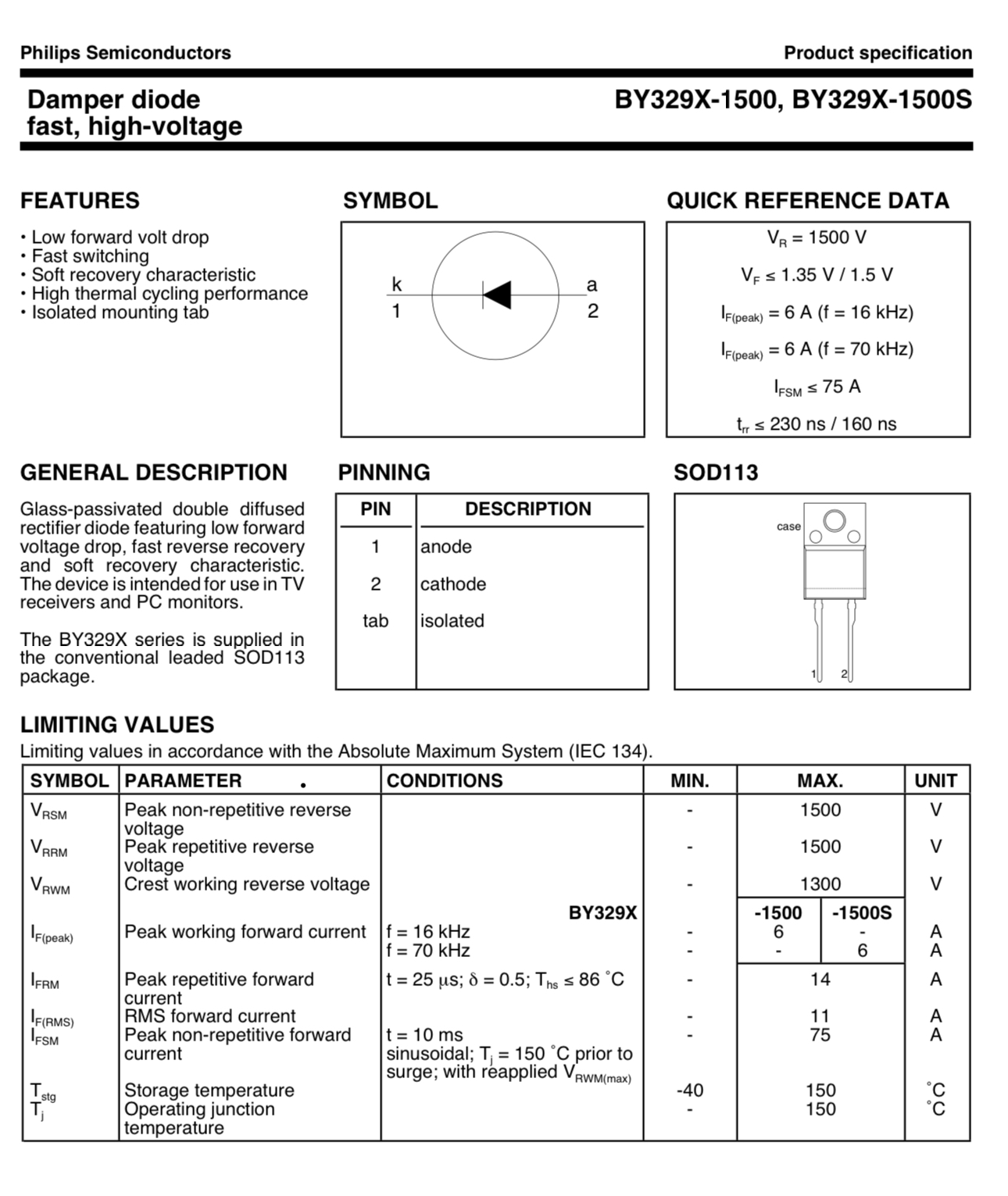

Almost forgot, I wanted to post the final power supply schematic since I had posted another earlier in the thread. Again rectifier tube is a 6DE4. Heater's -5.45v, taken off the 5v tap, floating. The actual rectification devices are these NXP damper diodes (I know, ironic) I have had success with. Look at the specs, still impressive to me for an all plastic package.. Voltages are almost identical to PSUD modeling🙂
I've always shied away from slow rise times in the power circuit. But in this instance, I didn't see an issue. With the capacitors I had, either a 30uf 600v, or the 470uf 450v cap, had to go last in my main CLCRC supply. So I simmed it, and I thought about it. The driver stage here has headroom, and I understand it is primarily pulling from the last cap, which in this case is the 47uf on board, correct? (And the 102uf can cap for output stage) I don't think the slow ramp up to voltage for the PCBs should be an issue. Obviously everything here can handle the extra initial current. The 6DE4 takes 25sec to warm up, so in practice, there really isn't any. Please someone correct me if I'm wrong. It even felt wrong doing it, ha ha, but really I didn't see cause for concern. For what it's worth this is also why both the on board caps are the 47uf, and not changed to something larger. After 470uf and those big Rs, 47uf was more than sufficient,
I figured.
Thanks all,
Loren
Thanks all,
Loren
Hi Loren,
Where do you get the Philips SS damper diodes? Mouser and Digikey don't seem to have them.
John
John
I should've checked that. Another thing I've had to get used to- It's so much more frequent that parts are replaced by newer models, and then discontinued entirely. Honestly, 4007's in a well designed supply "sound" OK to my ear. So, any time I'm buying HV diodes that look superior to them, I don't worry about much else. I've had these at least 6-7 years now.
The replacement that digikey suggests https://www.digikey.com/en/products/detail/stmicroelectronics/STTH812D/1117517
looks more than acceptable. 1200v, 8A, and at 50+ only $0.77 each (otherwise $1.25 ea). But if it were me I'd just be searching through lots, of hv diodes, at my internet resources. On the hunt for ultrafast and soft recovery, high junction temp capabilities, you likely could find even more economical choices than the $0.75. For 2/channel, that's not bad 🙂
