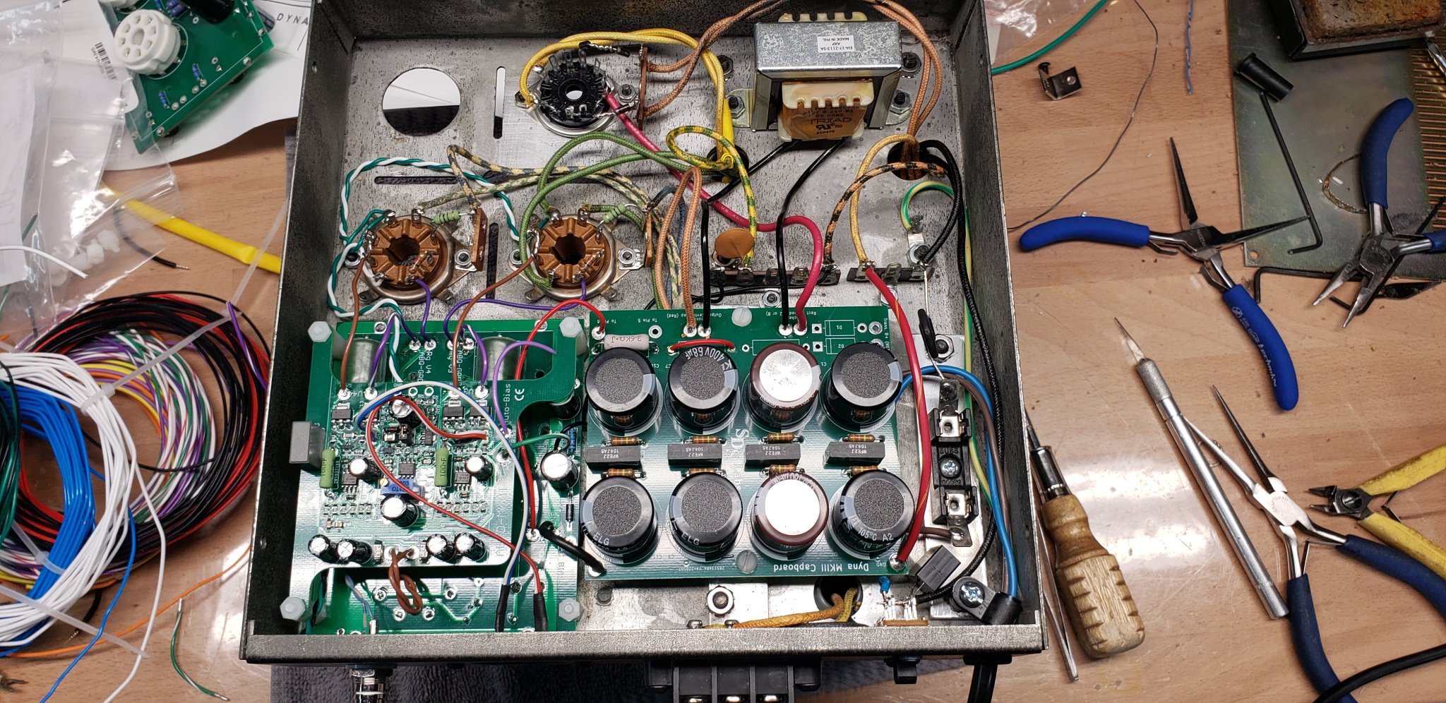

Of all the Amps I've had over the years, I never had a pair of Mkiii's. And not to say anything for, or against them, for some reason I've always been curious of how they'd sound. Refurbished not as if money, or original design, were no barriers, but with respect to them. A very similar topology, well implemented. So, this is how I found them. Gotta love the single ccs phase splitter driver stage, led biased even!, 12bx7, feeding the 6550s directly 🤦‍♂️ Aside from that, and the added "heater voltage doubler" for -15v (now that ccs is working perfectly, I'm sure...) both of the amps are identical with stock iron. Couple weeks apart in '64 says the serials, so probably came from a store is what I'm thinking, as a set? I do know parts are starting to arrive, so it's time to do something with these dilapidated classics.
Yuck, what a mess under here. At least I won't have to worry about trimming the OPT secondary leads, they barely reach. Lot of extra wires for that heater based DC- supply too. If you look close, you can see that whoever made these "driver" boards was recycling them from some other board design. At least they were trying, I tell myself...

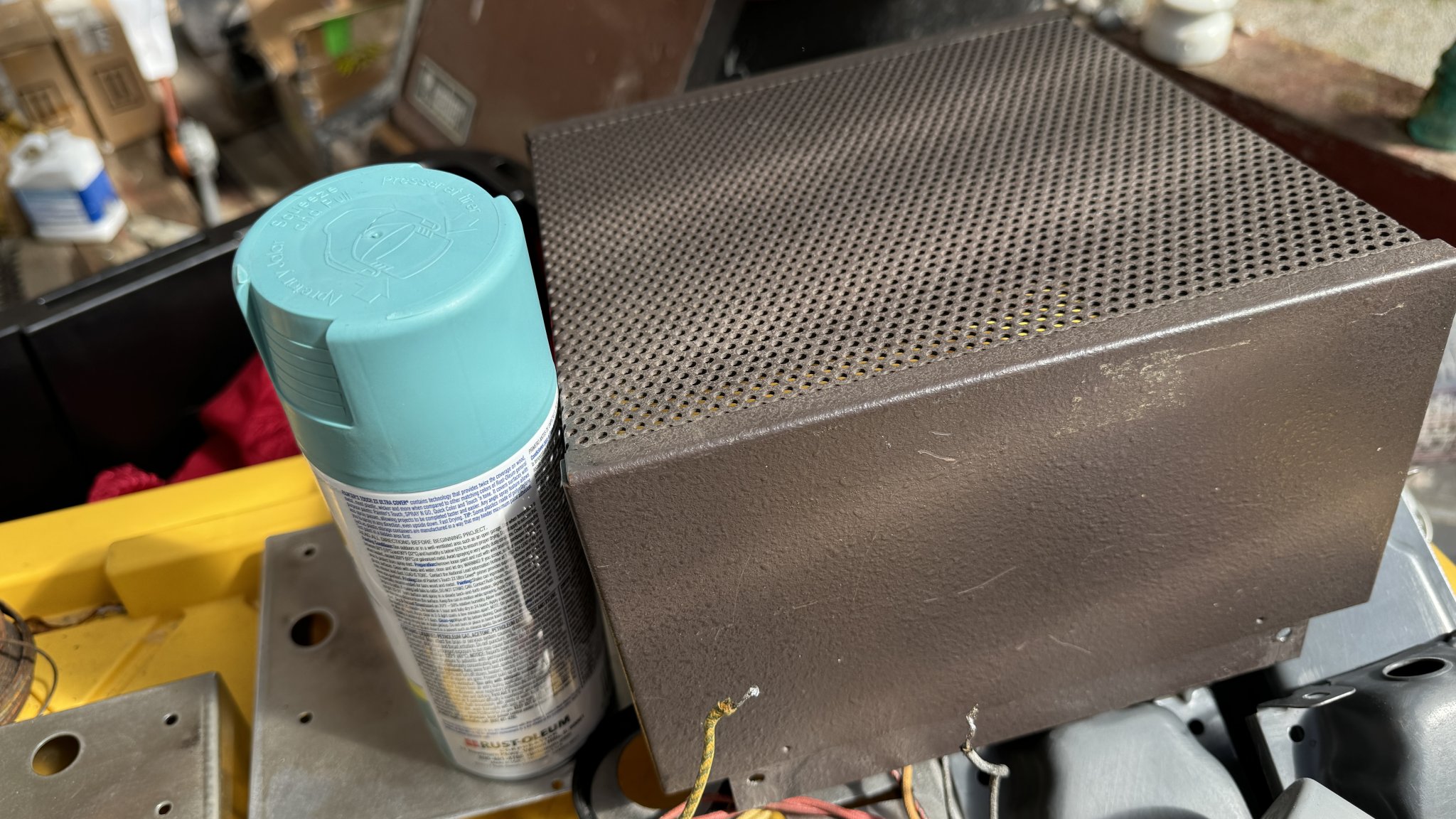

Ahh there we go. Every surface, every angle and hole. Used a single stage 220grit, which is more than sufficient for chassis like these, without any serious pitting problems. I don't know if you can see in first pic, but they had the chokes screwed in through the tube vent slats! This made one of them be shaped like they now all are. What a pain in the butt hand filing, but I'm glad they look as if they're supposed to be that way now 😅. Besides more ventilation is welcome on a 1.75" chassis with bottom plate (Hmm....more on that later..). I'm thinking close to stock for the transformers, and then a kind of aqua blue for the chassis.

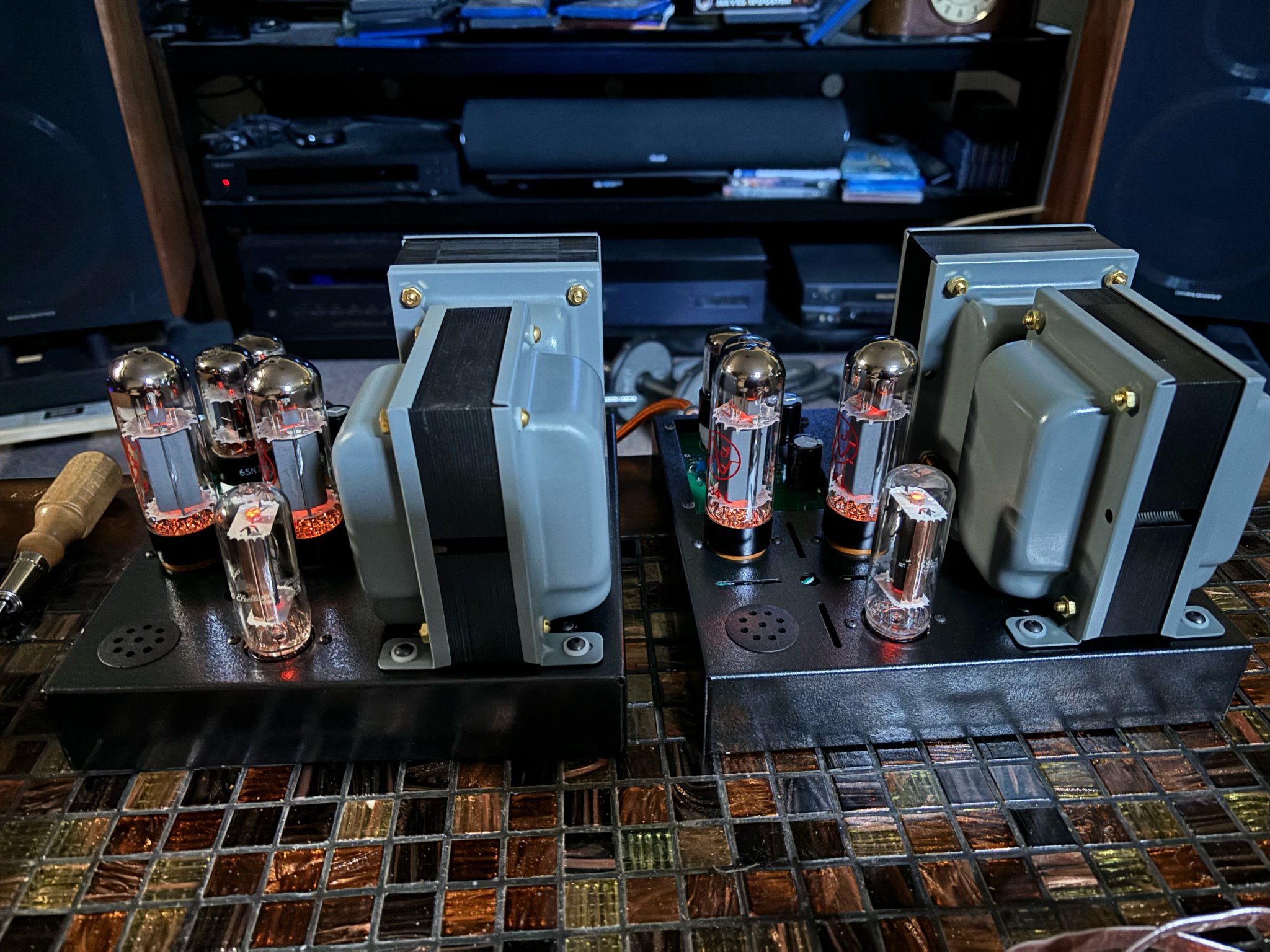

Here's the pic that I forgot yesterday as well. Like I said I'm open to suggestions, and this is where I love seeing others' work. Definitely leaving this way though. And I think the brown covers give a nice contrast to this blue. That and the fact that the "front plate" of the Mkiii is fairly crowded with black switches and such.

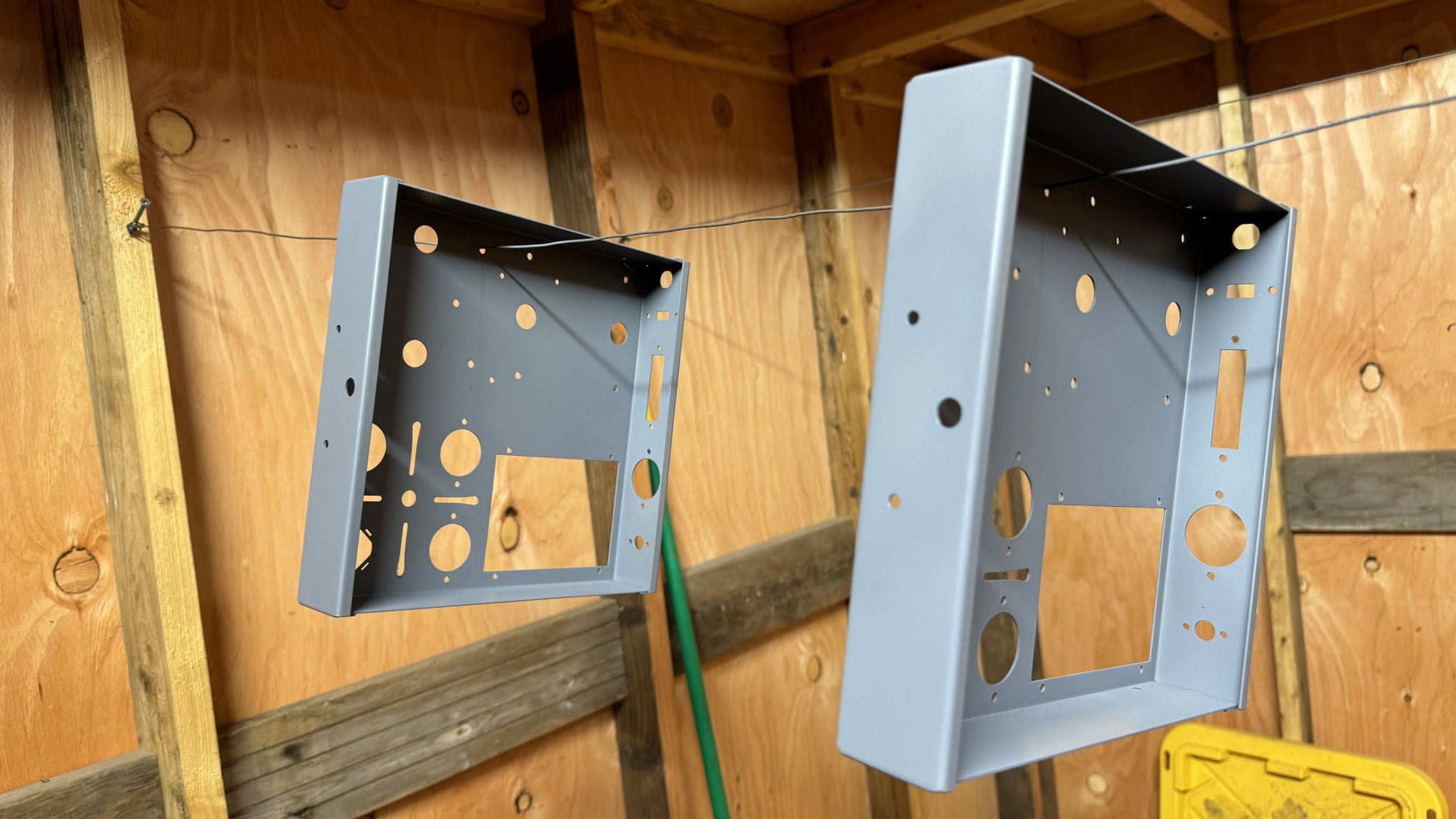

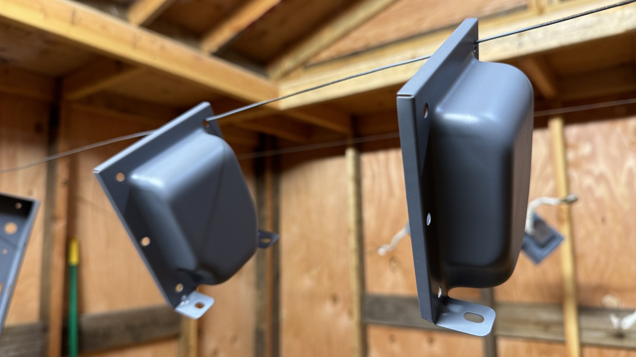

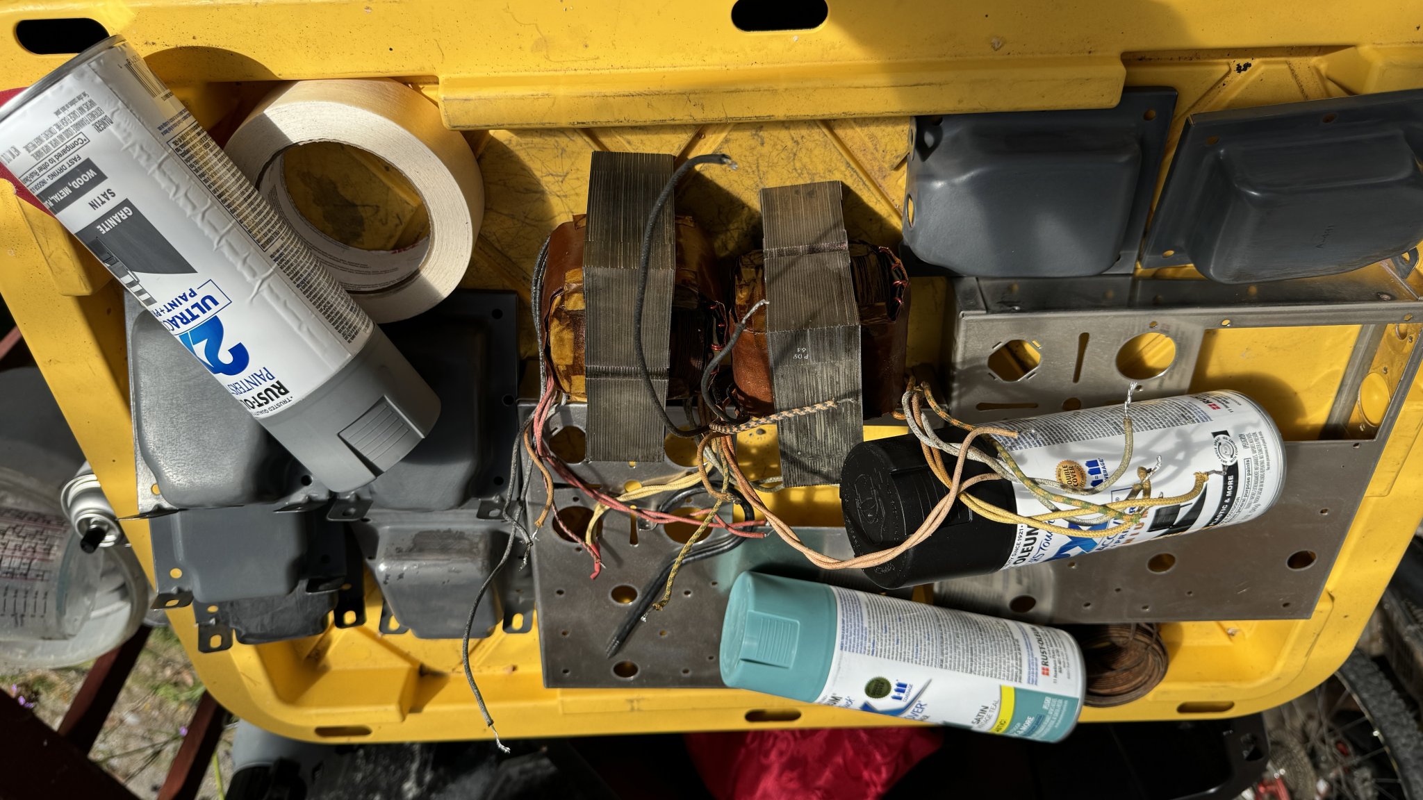

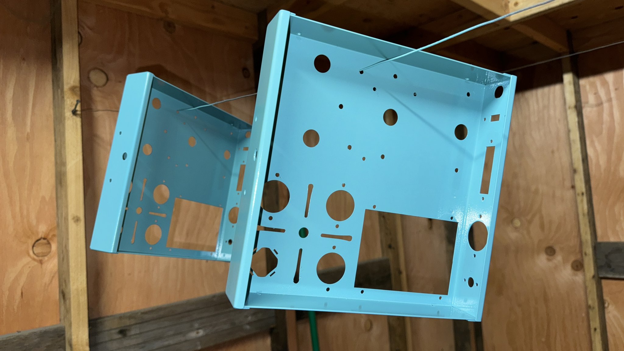

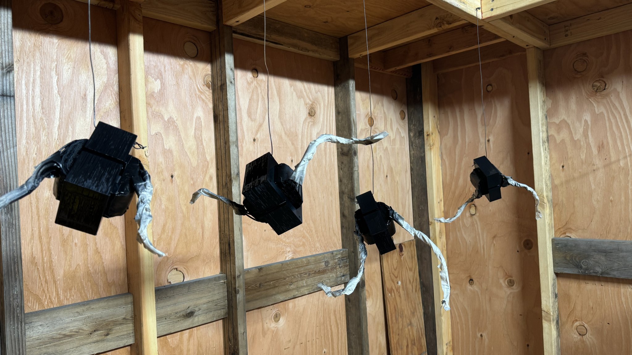

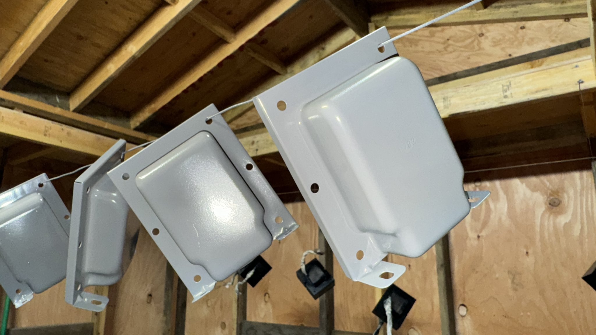

Hung everything up today. Nice having this shed that I happen to be just finishing, I used metal tie wire for all the suspensions. Everything was already sanded, but I solvent cleaned these and started soon after.
Everything is primed. I like to use 2 light coats, quickly after one another. Temperature was kept around 70, and will be for the rest of the evening.
All turned out as well as I could have hoped for. I didn't see anything make it through the 3-4 quick coats I put on, save for stamped part numbers and of course some of the lamination areas on the transformer cores. What do you think about that blue? Only picture I edited, to get it as close as it actually looked to me. It reminds me of the old metal storage drawer things that I'm sure so many of us have...

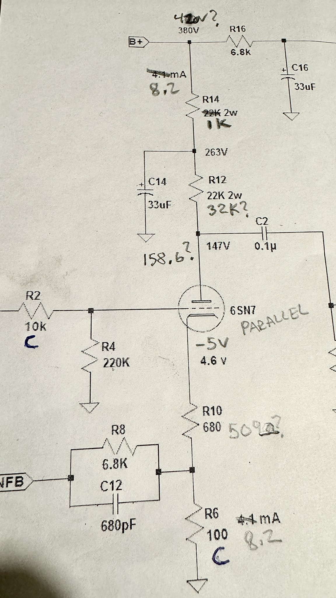

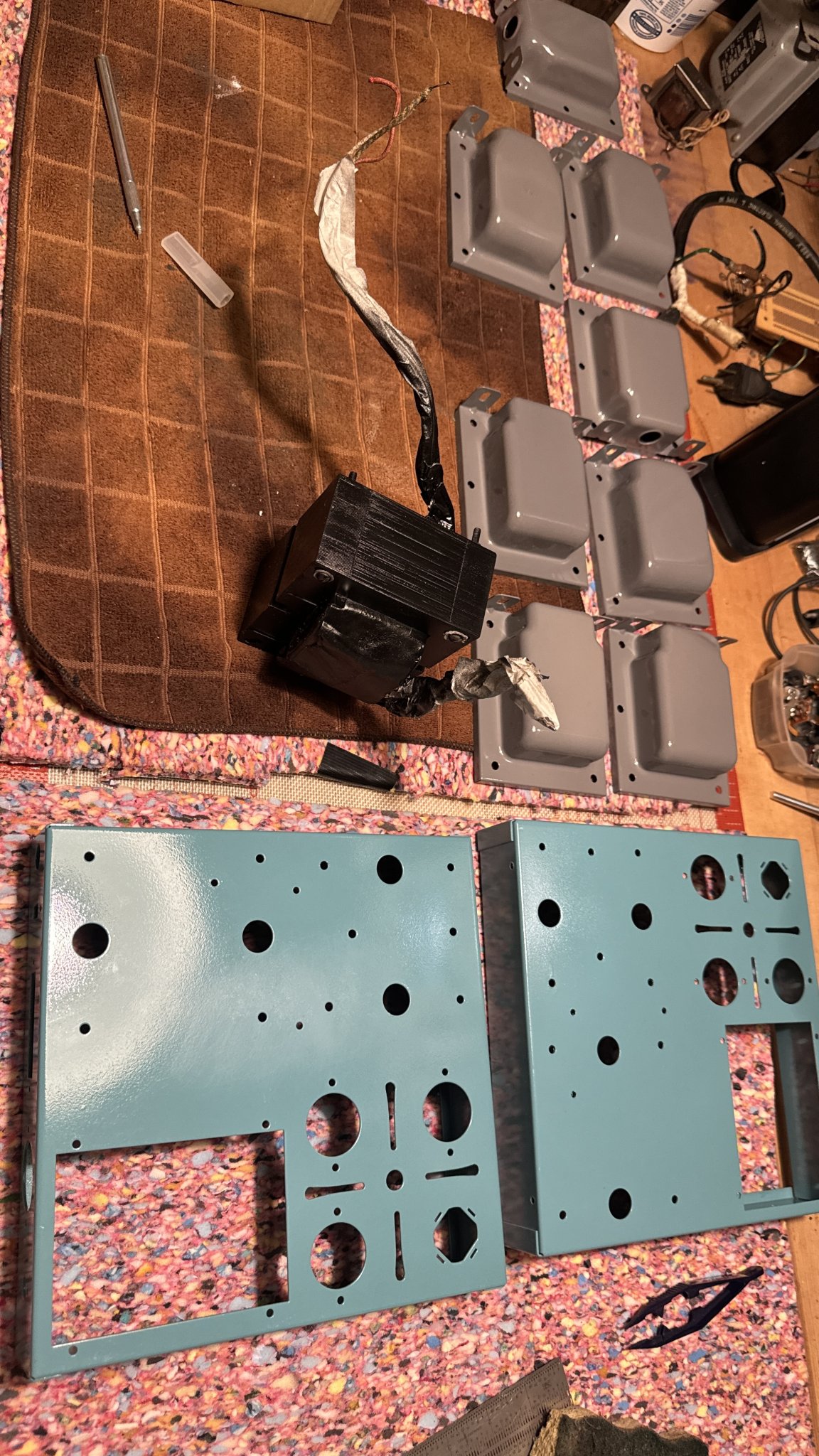

Hello again everyone. Got back to wiring the amps today. This was the chassis, bell ends, and transformers when I was done painting. But I put all that aside for now and got on to these tubes4hifi boards.
Pretty simple boards. I made a few changes for carbon comp resistors (the c's on schematic) but for the most part values all looked good. But when I got to the driver 6sn7, the schematic as written didn't make sense to me. For example, 380 B+, 4.1ma, 44k. Doesn't that drop us down close to 199v, not 147 as listed? The halves are paralleled, and since I surely have the voltage after B+, wouldn't 420v B+ and these values be a little better?

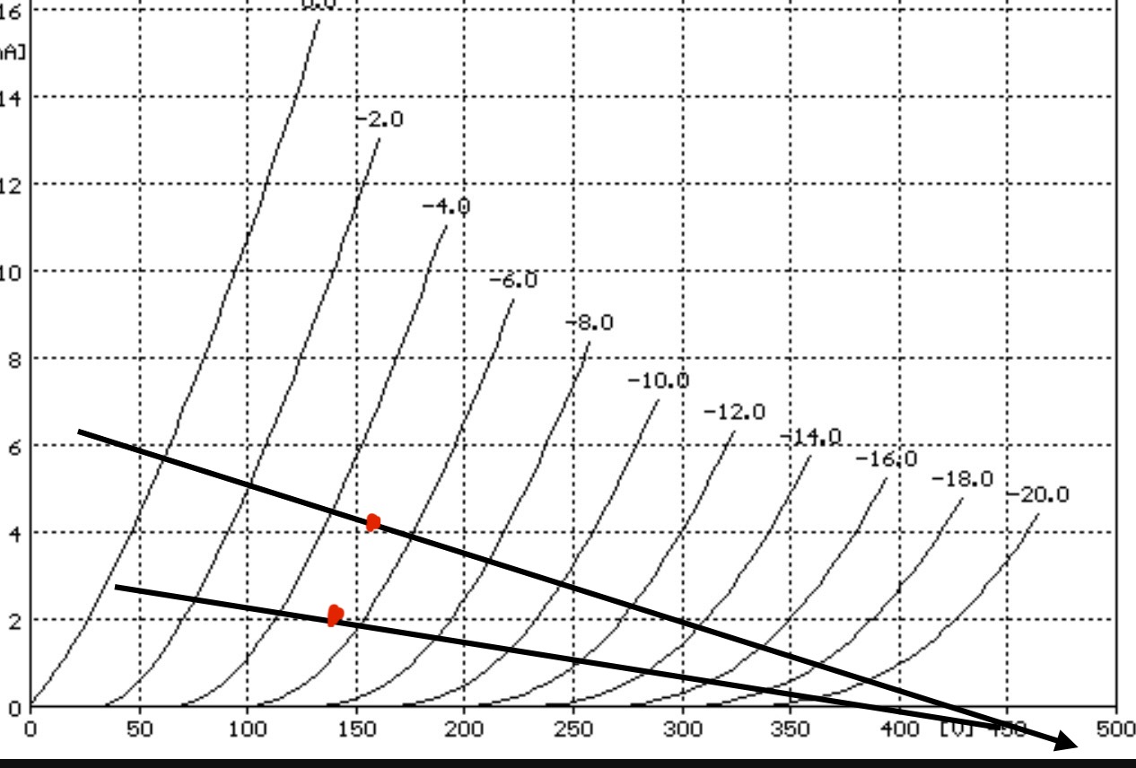

Here's the 6SN7 graph, and I think this, or maybe slightly lower bias, looks like better idle spot than the stock one was. Anyone else changed this section from what the tubes' schematic says? Mine is the top operating point, stock is bottom.
