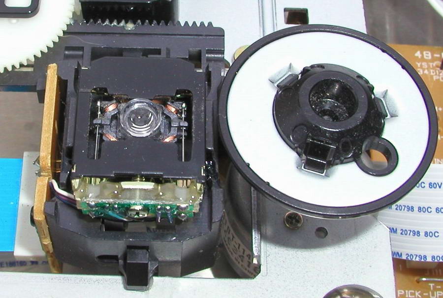

I am awaiting delivery if the JVC Boombox. Idle hands could be a dangerous thing ! I have butchered an old Sanyo Boombox as a peek inside led me to believe that the same chips might have been in it. They are not, but the transport is easily detachable and a search for a data sheet, gave me the pin outs of the chip.
There is a dig out at pin 43 and a 16.9344 output pin at pin 58. I connect to which pin and ground ? There is another pin designated (Digital Filtering D/A Converter interface) I assume I ignore this ?

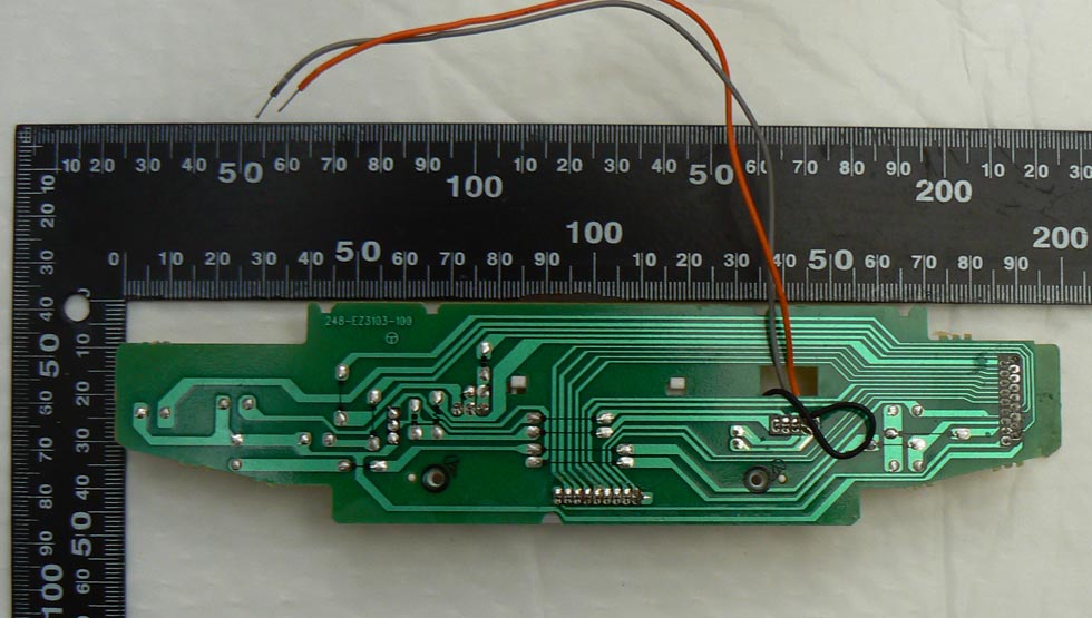

lazenna said:can someone tell me how wide and high is the pcb that holds the lcd display from the jvc?
The EZ31 pcb is 200mm x 50mm..

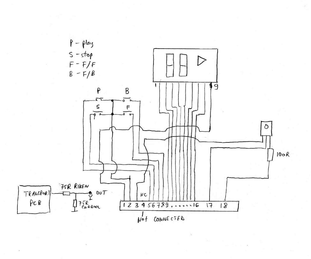

Would it be possible to post a quick sketch of how to wire up the digital output/resistors combo.? I have studied the pictures already here but I still have brain fog
Any chance to cut some of that PCB away, and still keep it functional? What are the 2 pushbuttons to the left of the display for?
As I was working recently on a new display board, here's the actual schematic, the one in service manual is not exactly accurate.
I also simplified it for my needs, with only 4 main buttons. The other 2 buttons are for programming and repeat. I only need them on remote.
The digital output resistors are also explaned there.

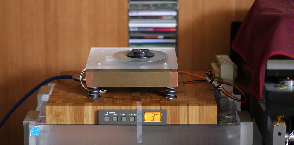

Dr.H said:Peter, not sure of you have posted this, but could you describe the sound of this clone? Also, sound vs Mark Levinson etc.
While over the weekend I was modifying the chassis to install the display panel I put on my modfied Levinson ML37 . Now, unmodified unit sounds so uninteresting that I couldn't listen to it at all, with the mods, it comes pretty close to ML31.5 and is quite listenable.
So after switching to Levinson, I got impression of very well defined and presented mids and highs, with proper PRAT, probably a bit less bass than with clone, however, the thing that strucked me the most was slight edginess: the sound had still some digital character that I already forgot about when listening for months to Shigaclone.
The clone is very smooth and natural, I don't miss my analog rig at all. It is very similar in charachter to CEC TL0 which was my reference for last 2 years, it keeps the best virtues of that transport and adds a bit more excitement ; for me, it translates into more involvement while listening. The clone also seems to have more resolution and fine detail comparing to TL0.
Did I already mentioned that the clone became my new reference and it replaces the 5 transports you see in picture below? No kidding 😉
