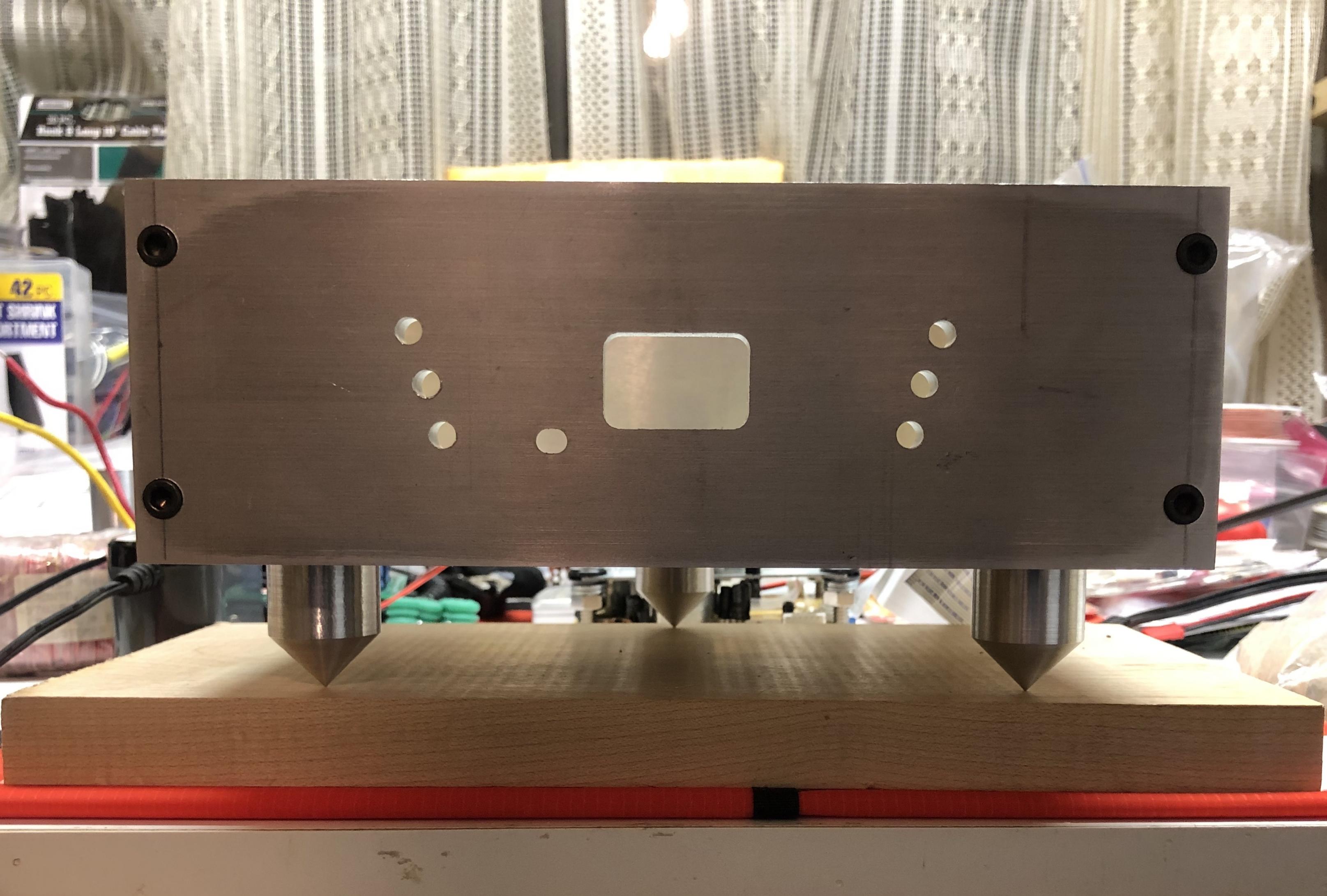

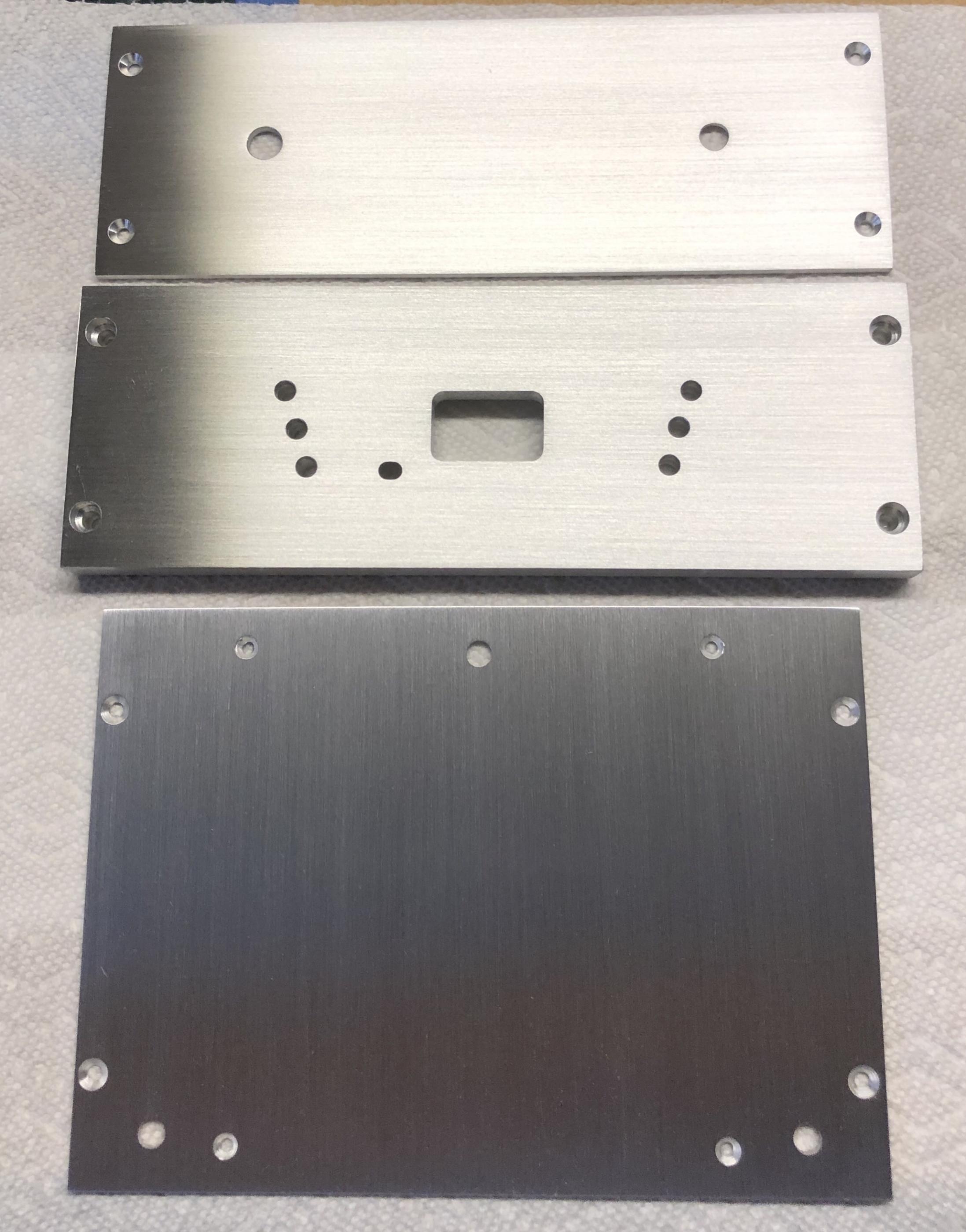

I’ve been a bit busy dealing with renovations on the house.

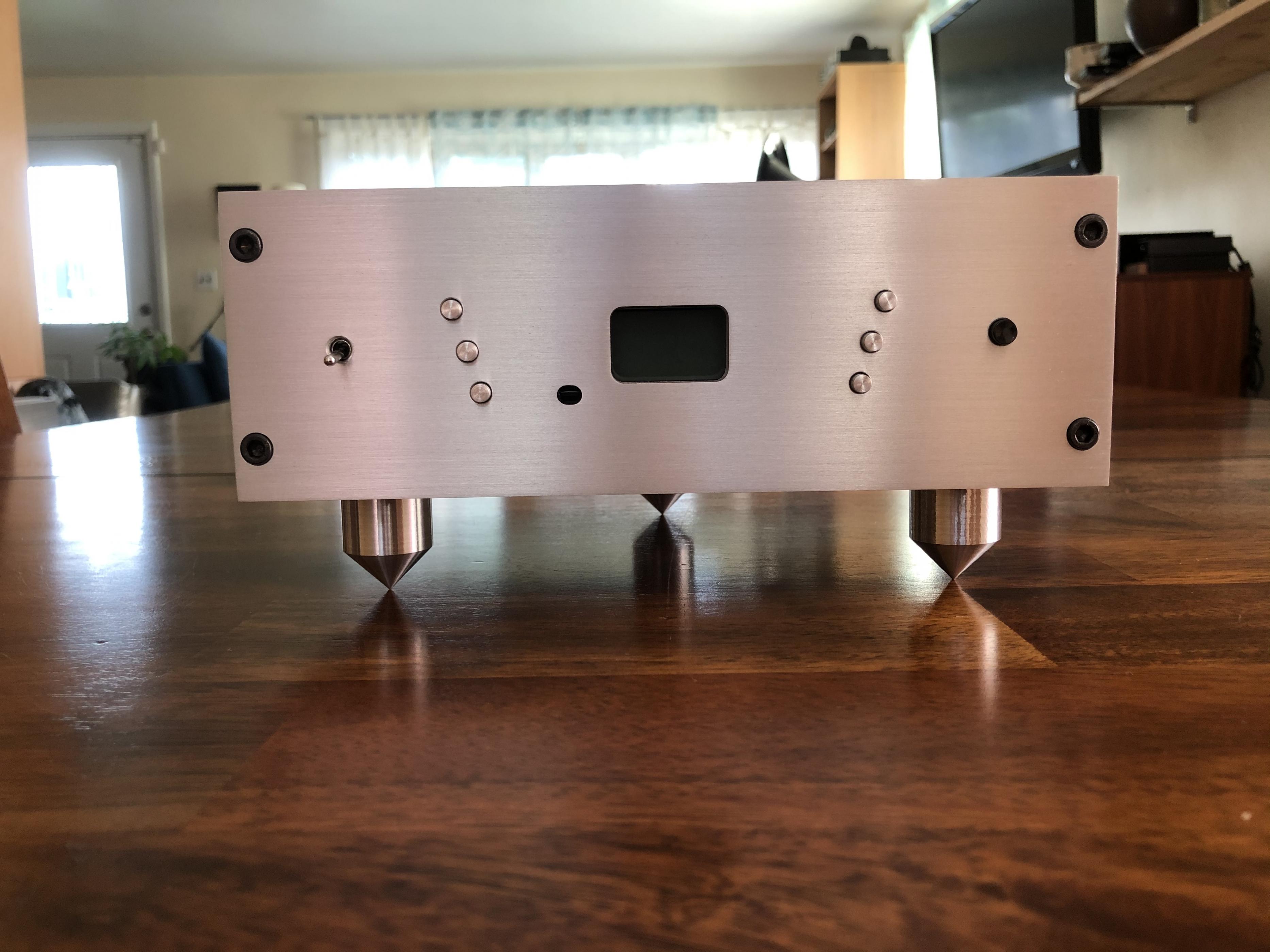

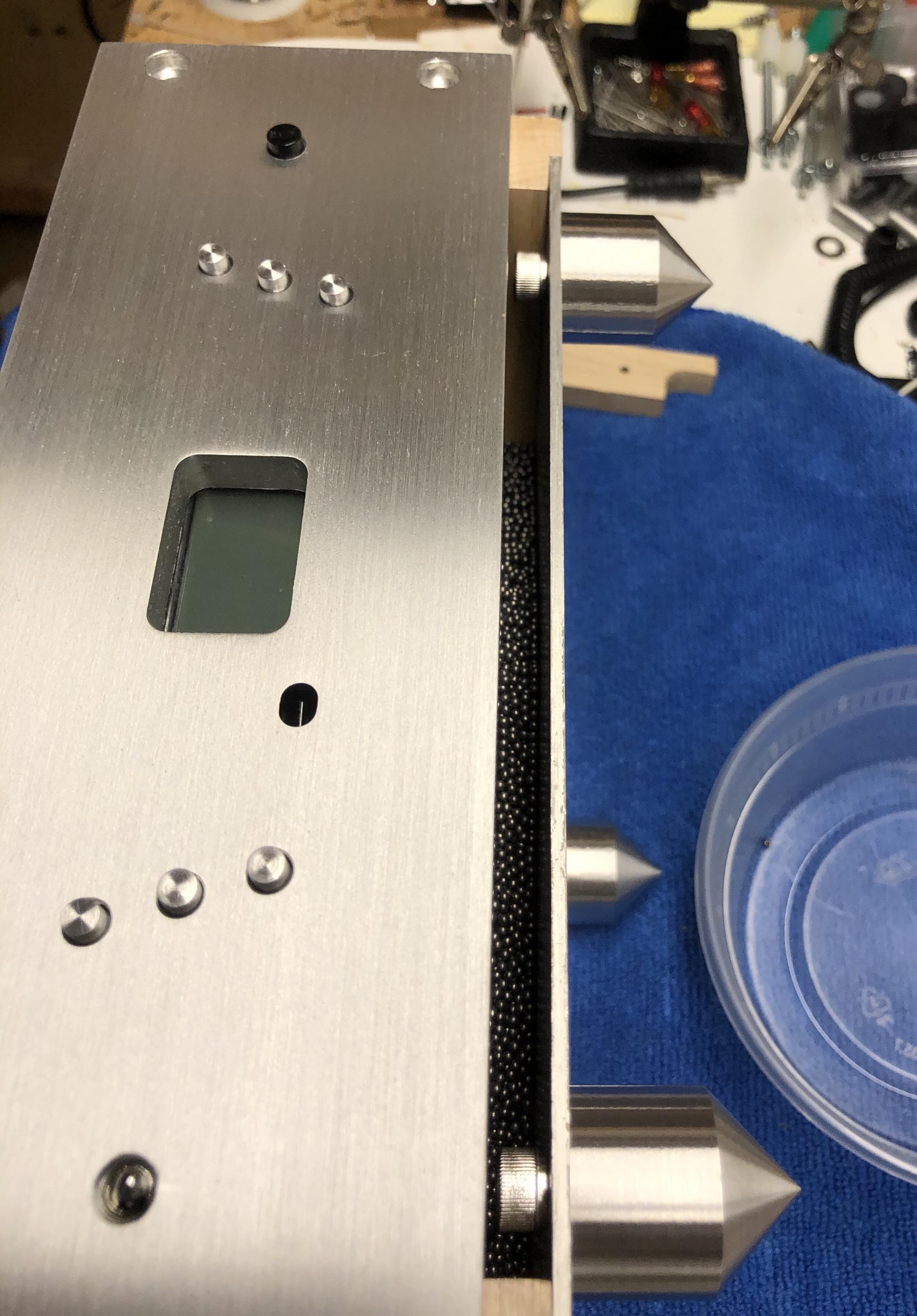

I did find time to wrap up most of the case fabrication. I’m still on the fence about whether or not I want to hinge the lid or just make it removable. I didn’t get a chance to take a lot of pics. I keep putting it together and taking it apart in order to test fit things and solve different problems.
I spent a few days doing nothing but wet sanding the aluminum. No finish on it yet, but that will be simple wax and buff.

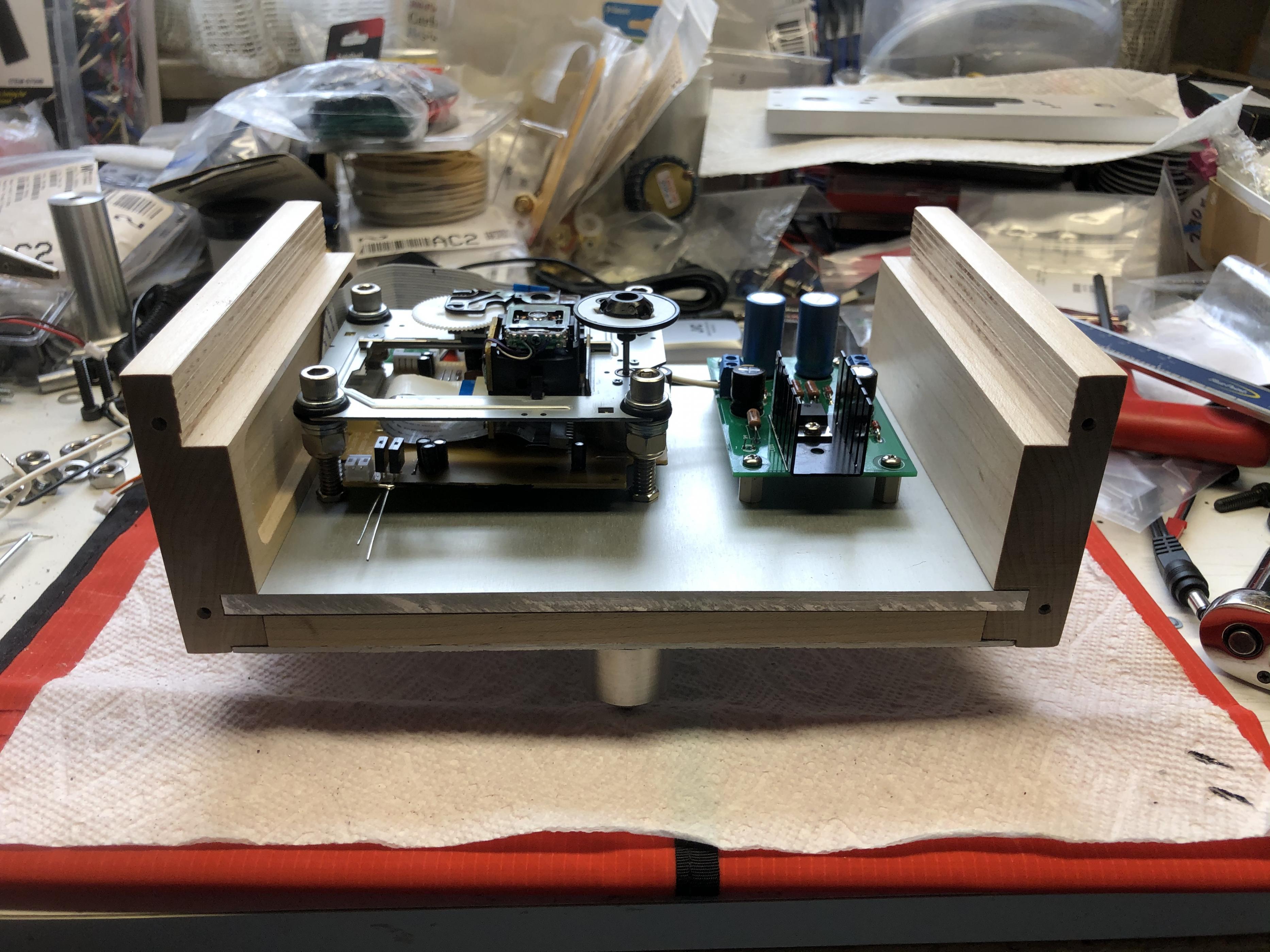

Today I found some time to work on the electronics. I got the inductor removed along with C916, C952 and their bypass caps. I don’t think I’m gonna go further than that right now. I want to get it together for a test.
Damn trace started to lift right at the edge of the board on C916 positive pad. I lost the outside half of it when I removed the cap. When I replaced it I bent the leg of the new cap over and soldered it to the empty pad for the bypass and again at what was left of the through hole pad. Tested continuity and all seems ok. No Black Gates in my bins. I used Elna Silmic II.

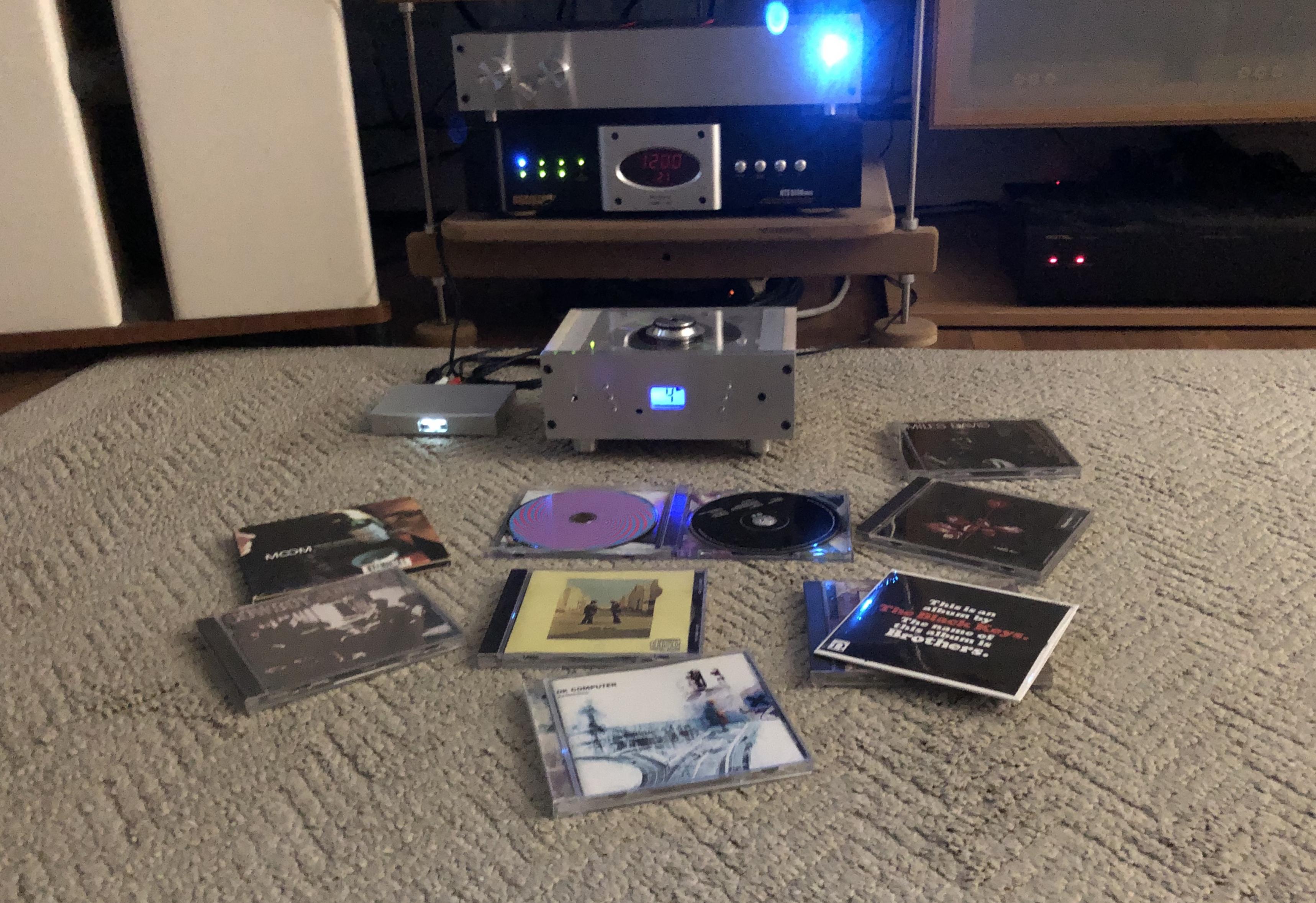

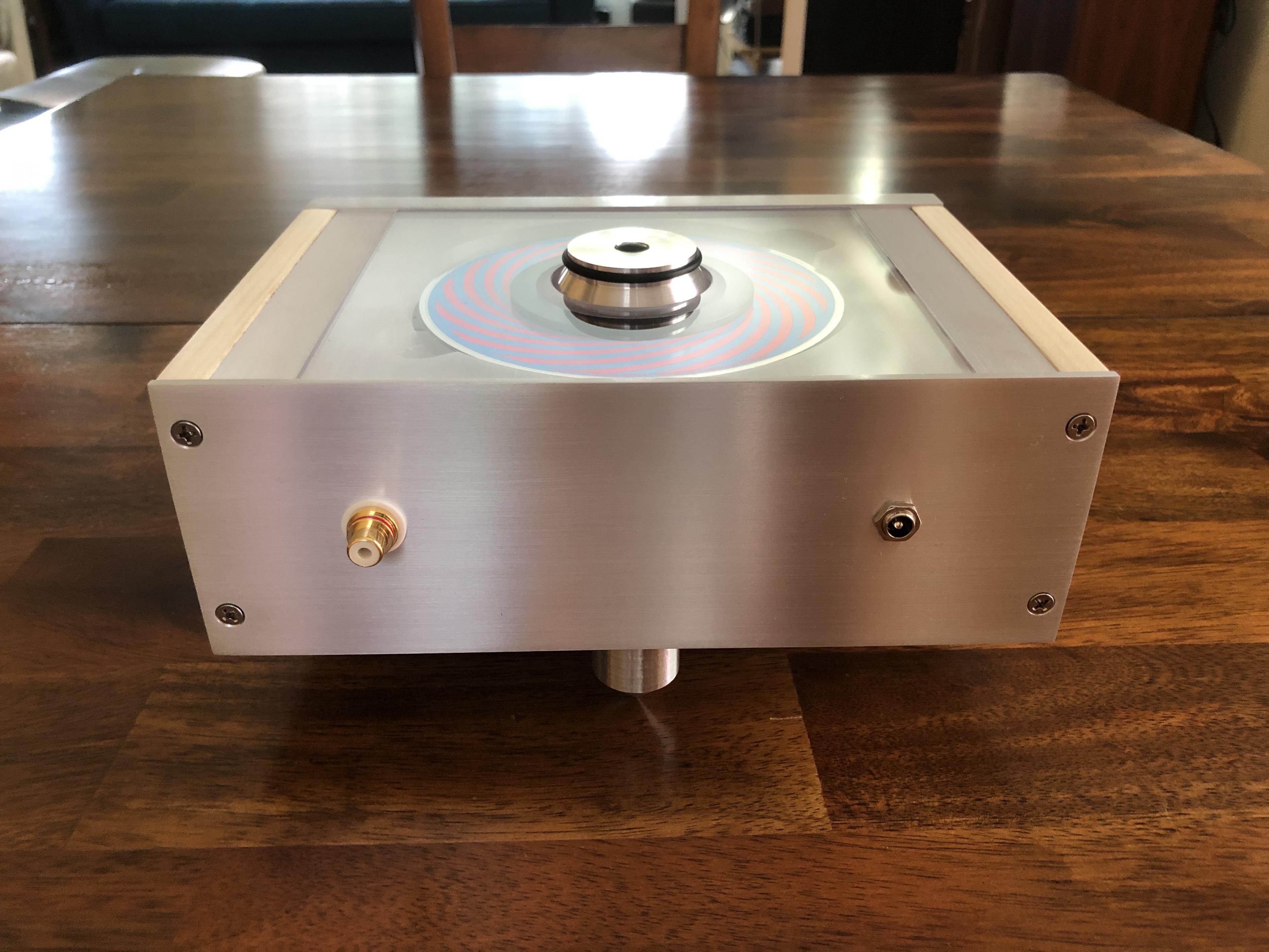

Finally!

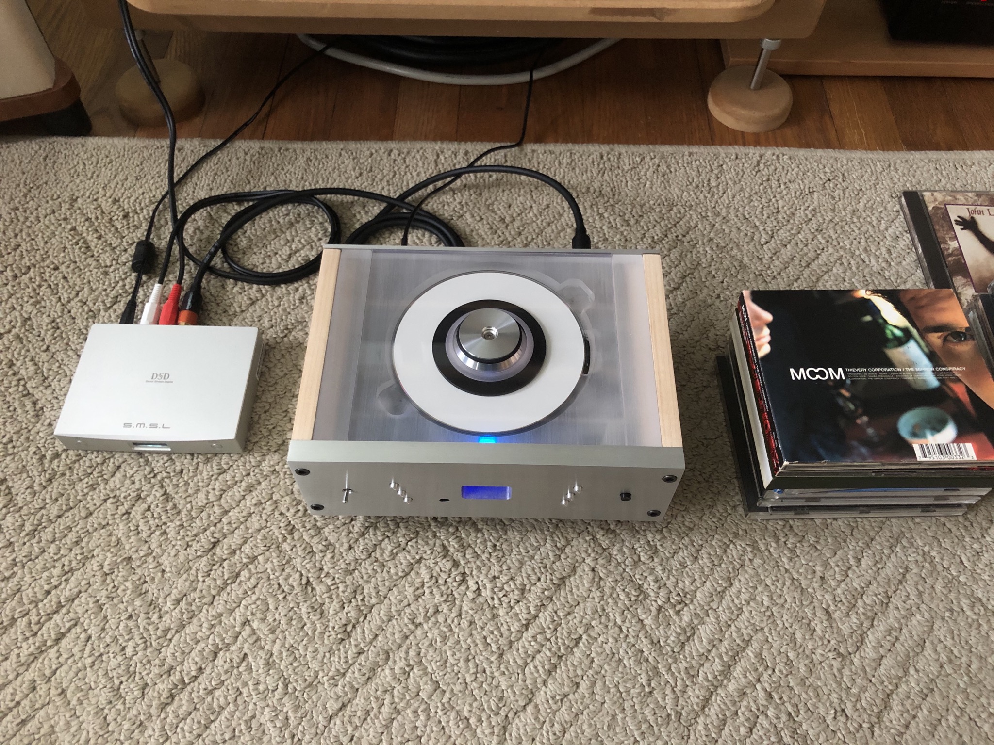

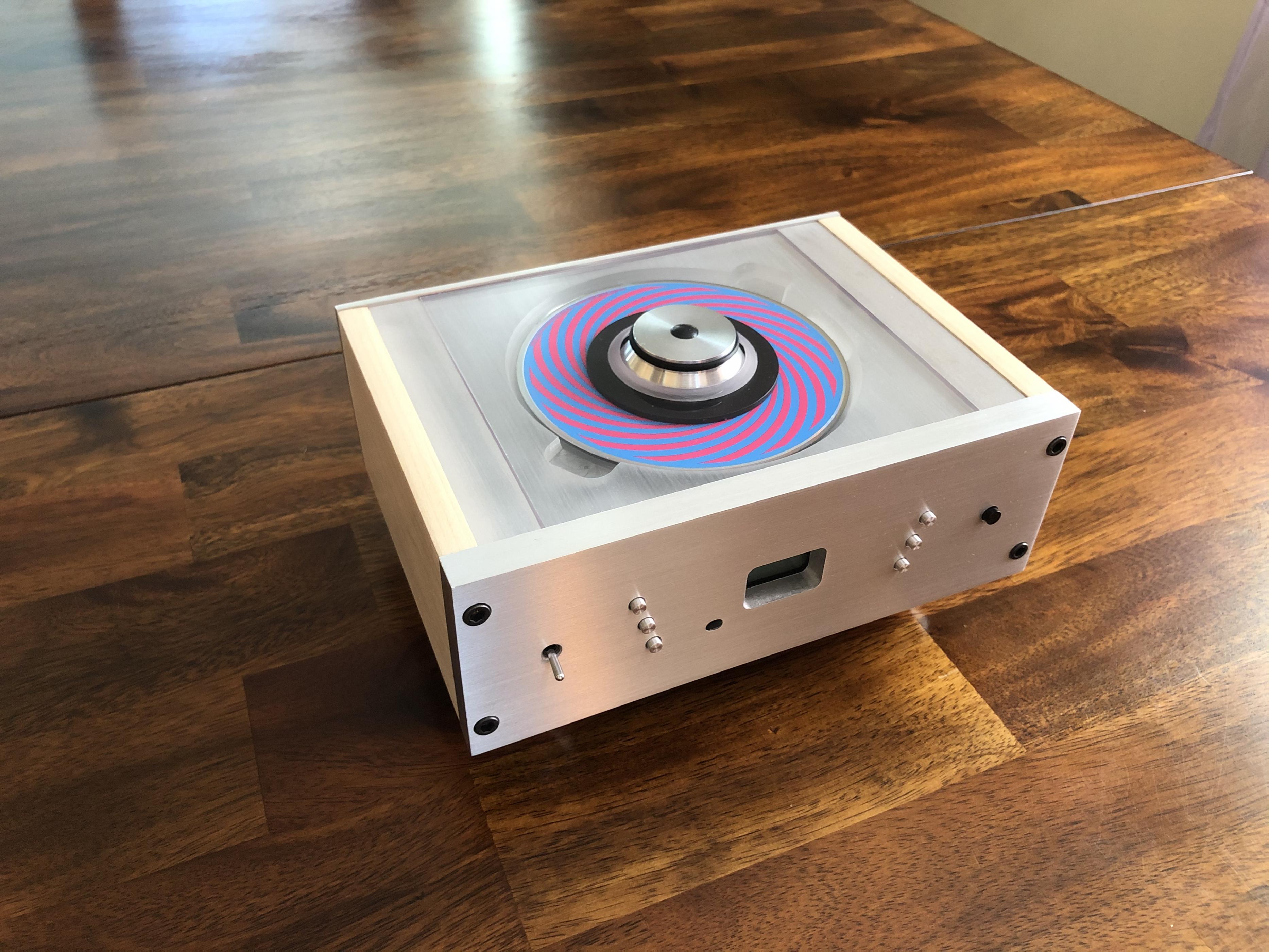

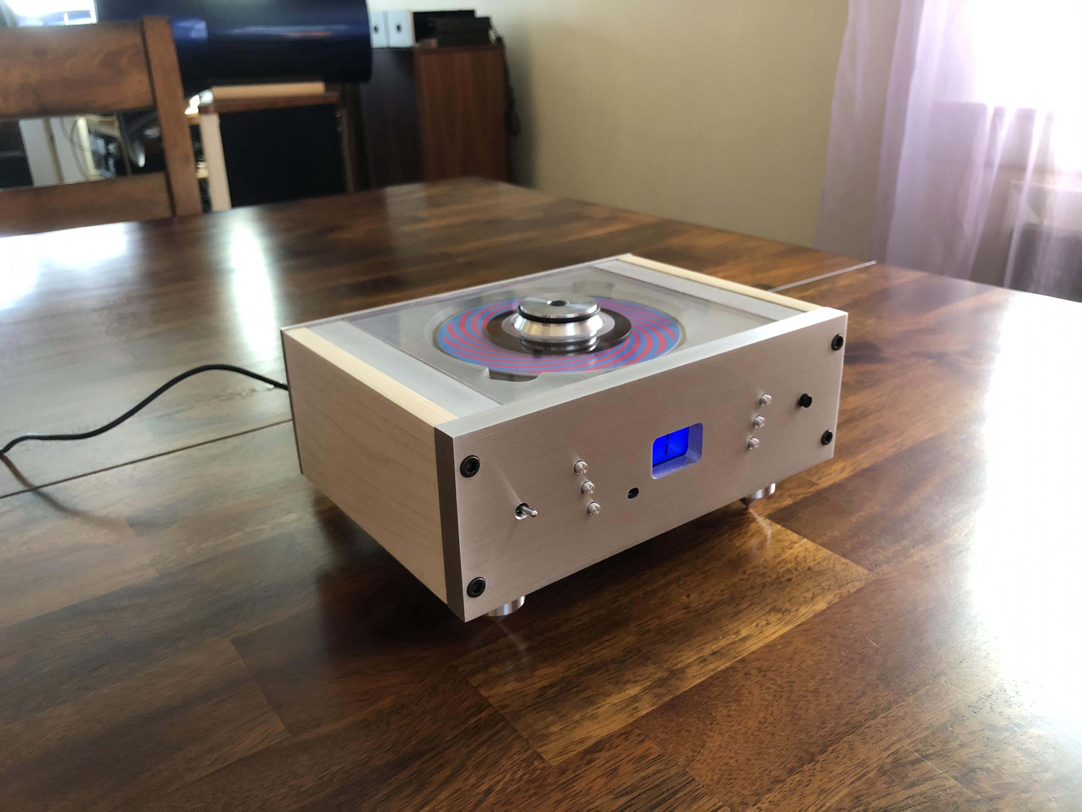

Well I managed to pull it together and got my Shigaclone assembled and working today.
I took a few more pics of final assembly as I was mounting, adjusting and wiring it all into my chassis. One of the last steps was loading the compartment in the bottom with lead shot to help damp vibration...while trying to not spill it all over.
Of course there was nail biting and panic involved during the first test in my system.
I had only been testing the player for function without sound previously.
I fired it up and immediately got unpleasant noise from my speakers.
It turned out to be a crappy SMPS. I ended up repurposing a router wallwort I had saved as a temporary solution. Actually, its dead silent...go figure.
But...again there was nail biting...there was no music.
Duh...the DAC was set to the wrong input.
I only currently have an SMSL M8 to try with it, but it does sound very good.
Now I’m finally sitting back and listening and enjoying my CDs again...for a little while anyway.
Now I have a real reason to get my D3 TDA1541 project together.

Voltage during TOC reading still fluctuates and drops down to 9.25V or so. There must be a sudden demand during the process that perhaps is not being dealt with well by the mosfet regulator, the wallwort or both.
I am in the process of trying to figure out how to assemble a Salas SSLV v1.1 kit I bought a while ago for a phono project that I used a battery supply on instead.
Hopefully I can build it to produce an 8V supply that will meet any of the demands the transport can put on it.
BTW...I also embedded a blue LED in the bottom front edge of the Lexan CD tray. I was going to do this originally just for aesthetics, but then read a post in the thread that this can actually help with read problems.
This wallwort is designed to deliver 15V up to 1A. Once it is connected to the mosfet regulator I am using in the transport I get about 10.5-10.7V out of the regulator.
I was a bit reluctant to try it, but gave it a shot.
The transport now reads the TOC of any and all discs I have in a fraction of the time it did previously on discs I wasn’t even having a problem playing.
Even on discs that are obviously scratched and hazed it will read the TOC. It will also play them.
However, it does reach points in the disc that don’t read properly and the result is loss of proper sound output.
The funny thing is that it still just keeps plowing through the disc until it clears up and starts playing music again...so I guess it can still track through the bad segments of the disc.
I am a bit worried that the possibility exists that the 10.5V I am putting through the circuit is not within tolerances it may have been designed for which may result in burning the laser or something else out.
