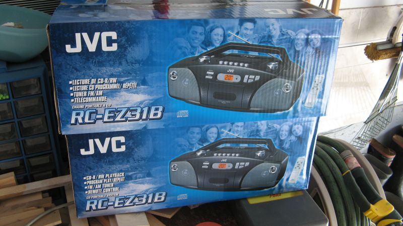

EZ31 are going fast, almost 2 units almost sold...Please send me an email if you are interested.

Thanks Jean-Charles. Just returning from there. I got probably all the left units from around Montreal. Guys send me emails, chance for you to get the almost impossible to find anymore transport.
