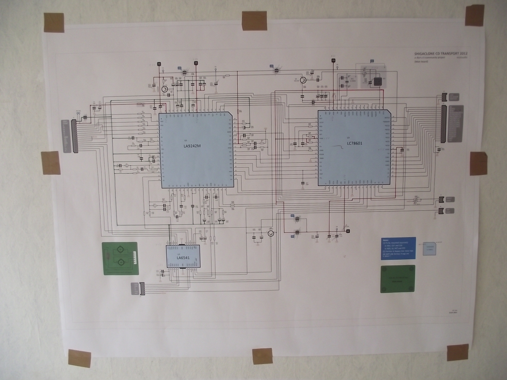

I have printed out the clone circuit as big as possible (A0) for study purpose. I see that Q2 feed pin 18 of connector J4 and pin 3 of connector J3.
I will give that pins a separete 78lo5 reg, this means Q2 is unnecessary
and can be omit.
Mine questions, is this worth full, if yes, what to do whit the pins 11 and 12 of LA6541, they too become unnecessary.
This to separete the power supply as much as possible.
Regards

Hi zjaakco,
Q2 also power entire Shiga trough L4 bead.
Q2 is part of internal LA6541 regulator which is quite good.
J4 pin 18 is for infrared receiver and J3 is for CD switch door. Changing this to a separate power supply bring no sound improvement.
Trough Q2 a system reset is made by LA6541 at very power on. This is the main reason why this regulator is included in this driver.
Tibi

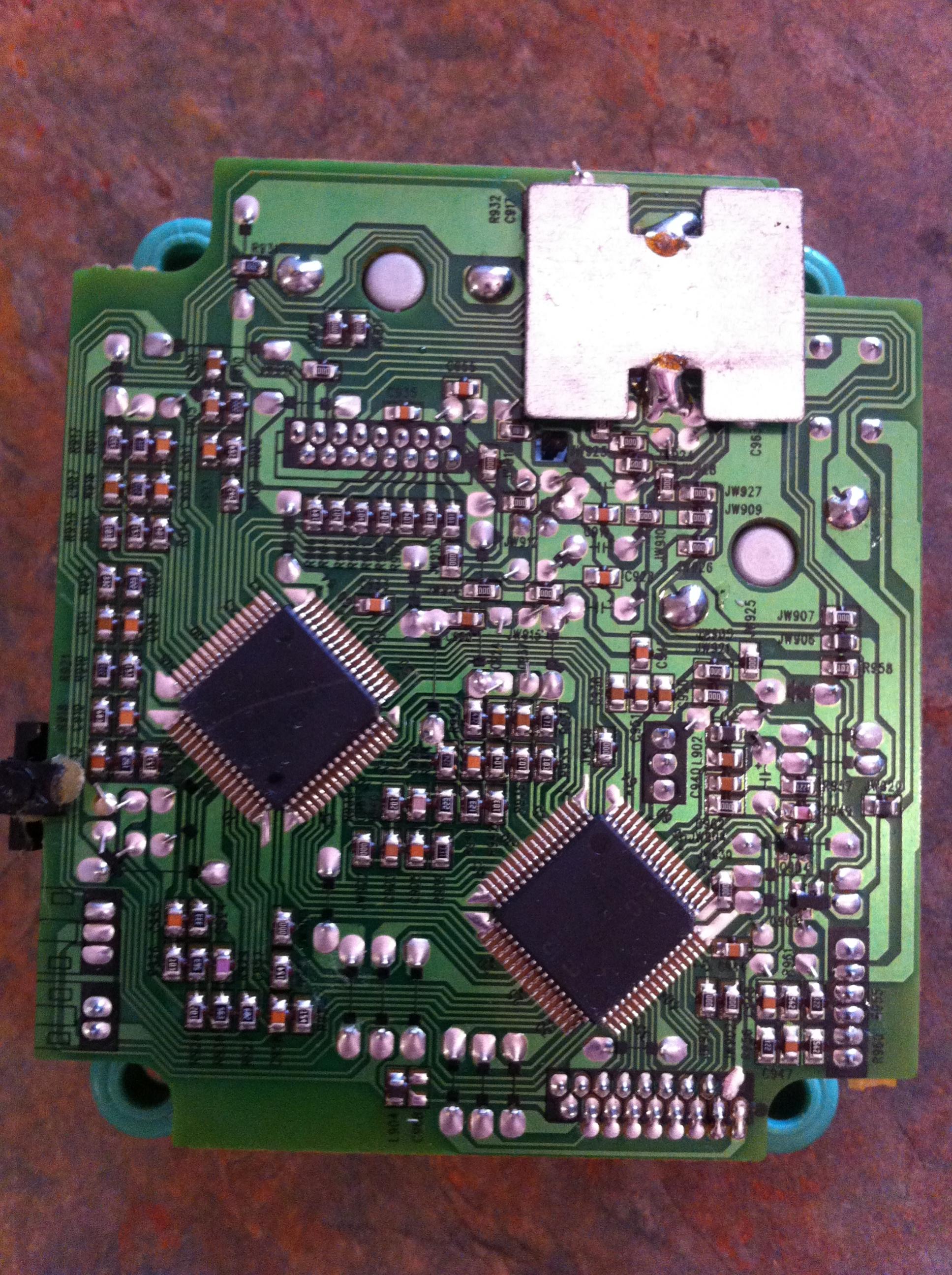

I'm still banging my head against the wall on my second board. First board works fine. Second one I built with the chip set and my passive components still won't read the index track. It seaks for a while, then speeds up the spindle and displays "00".
I tried the mod of moving Q3 and C50 but it had no effect.
Any other suggestions?
I also rotated the transistor on the remote and now it works fine.
Hi The Gimp,
I would look for a cracked ceramic capacitor, these often crack when soldered with iron.
Tibi

I looked for cracks using the Leica GZ4 at 30X and didn't find anything so I replaced all the ceramic chip caps smaller than 100nF.
Hopefully it will work tonight when I take it home.
Bingo!
I probably had a wrong cap somewhere. Unfortunatly it is virtually impossible to measure them in-circuit without special equipment ,so the easiet thing to do is shotgun them.
