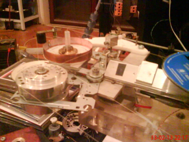

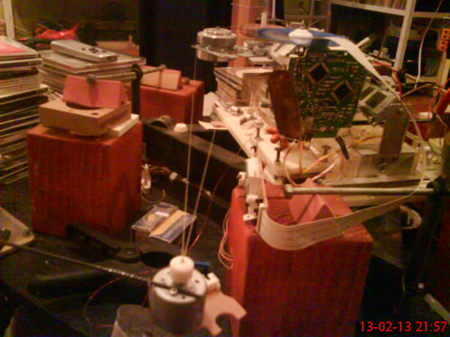

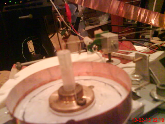

I can't offer you any drawings because it is project without the project ,only execution from imagination. Because of belt drive you have freedom to place motor anywhere and connect the laser to it restlessly without the need of micrometer precision but I will try to clarify the concept if somebody want to try something similar.Most important point is giving the laser all the time it needs to read the data without going back to pick what is missed in first attempt by optimally synchronizing sled motor and laser motion. If I am not mistaken this is the point of hard drive Linux systems ,ripping the music several times to pick up lost data during one of previous unsuccessful attempts.There is much more music on 16bit disc that can be extracted this way ,in real time ,not multiple 48x or 52x.

This is semi-analog device now because track skipping for example ,if automatically operated ,would last few minutes.So for shorten the seek time I help find track manually ,like analog turntable.I have optimized actuating speed so that the sled motor is constantly running and the lens is reading data effortlessly.Just like analog TT do.The whole CD project problem in my opinion is in the wrong designing in 80' because of ongoing consumerism world ideas ,fast ,fast ,fast.They forgotten that the music must be enjoyed slowly most of the time except if you are not in the car or jogging. The sound can't be characterized nor as digital or analog.It is very similar to 24bit computer audio (HD tracks for example) reproduced on Linux system and first class converter and what is most important you listen to the music as an analog LP instead to constantly skip from track to track with cell phone as my friends with such Linux systems do.I didn't have the chance to listen to even one of many song that we heard from beginning till the end since there is always huge music collection that attempt the user to listen whole quantity in one breath since music software is immaterial ,all in the hard drive chosen instantly by cell phone in the pocket.This is silicon thread driven system.Motor pulley 0,3mm in diameter is driving two video heads.On the second video head there is a needle 0,15mm ''thick'' which winch thread ,connected to disc placed over fixed lens which is damped with paraffin to kill unwanted energy which is produced by focusing.The disc is floating on air bearing and motor is paraffin treated too.The sled motor is decoupled from transport chassis by carbon stick tip.The whole transport is hooked on three springs.The transport is quiet as analog turntable now.
There is no more digital signature evidence left ,no jitter ,you can't tell if it is analog or digital ,it have best of both not the worst as can be heard on some ,so to say hi-end players with unnatural wannabe vinyl smoothness 🙂.

When I was testing with standard mechanism the best result was carbon fiber tube with metal screw inside the tube.If you want you can than add some nylon ,rubber , or other material washers between the screew-carbon-mechanism assembly to fine tune the sound of the transport.

How do you control the sled and the spindle? Have you bypassed the controller entirely?
Not at all.Both motors are still controlled by original PCB.I just wired controller with longer wire.If you make long run of wire for sled motor you must twist two wires together otherwise you get strange sounding music ,somehow distorted.When it is twisted the sound is clean as no extension wire is used.Spindle wire it's not contributing to overall sound.I just reduced sled motor motion ratio.Now it is installed pulley of 0,3mm instead of gear so the motor is constantly running and that way don't disturb the lens reading as with original mechanism where gear always go back and forward stressing the reading by constantly correcting lens position under desired pit.The motion of the sled is smooth as hydraulic arm movement and that result in outstanding sound quality without digititis disease 😎.It is still automated player but way slower in it's functions ,for example ,track skipping last few minutes but this can be done manually like on analog turntable arm.That is not the problem because I simply forgotten remote and I enjoy discs from beginning till the end like when I listen to LP-s.
Reading and play starting are slower too.That is lasting 5-10sec but player don't refuse non perfect discs anymore.It reads a burned disc that I stored on the shelf for 5 years and the reading was impossible for any player which I tried.Execution of that design is tricky to do but it is the best mode I have done to that transport.
The CD machine is even more sensitive to vibrations than analog TT ,not in identical way.With elimination of vibrations around the laser I got the sound which confused many persons who entered listening room.The question was: ''Is this TT or CD ,I don't see vinyl spinning.Why the sound isn't digital?'' The music breathe more like analog disc ,it fullfill the room ,it have more 3D presence which is obviously missed by wrong concept started by S/P many years ago.
