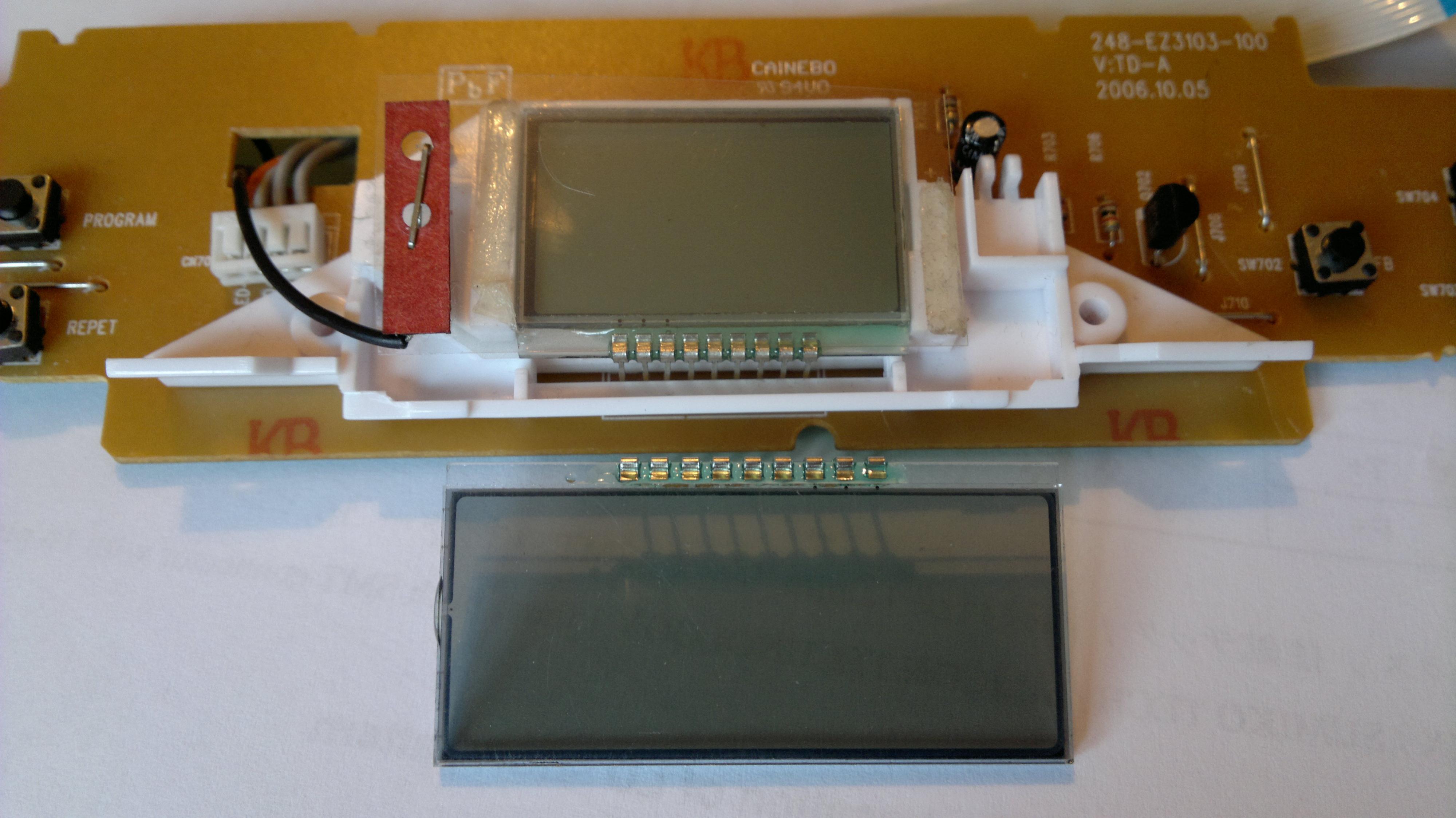

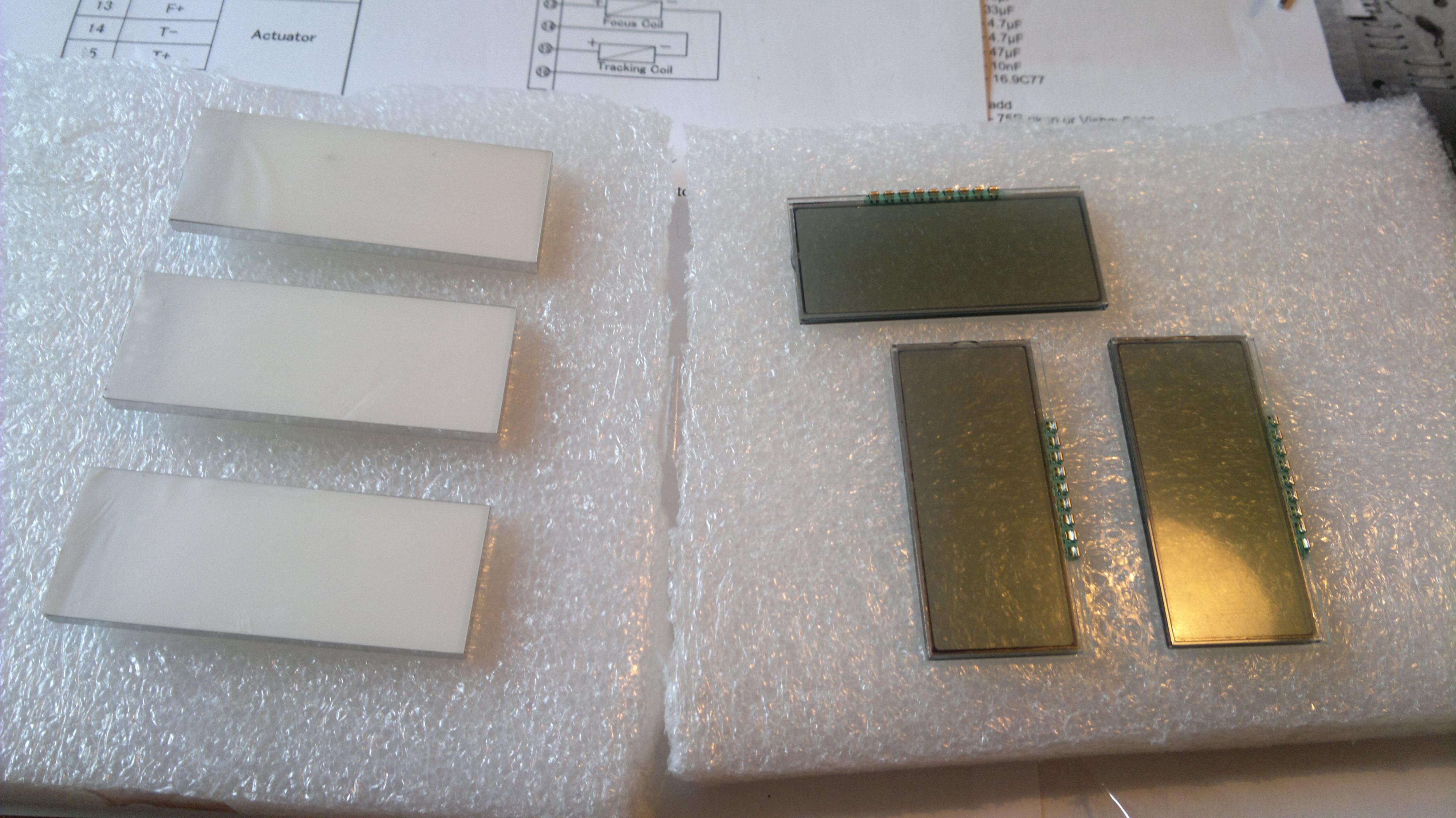

Multiplexed LCD was the bottleneck of this project. It is the most hard to find component and we had to design and produce a new one from scratch. This have delayed project a lot, but I'm very statisfied to see we have passed this "test".
I would also like to confirm that the final price for LCD is 6euro.
Tibi

Take a bow. Solving the LCD puzzle was a real accomplishment. You and your team should be very proud.
