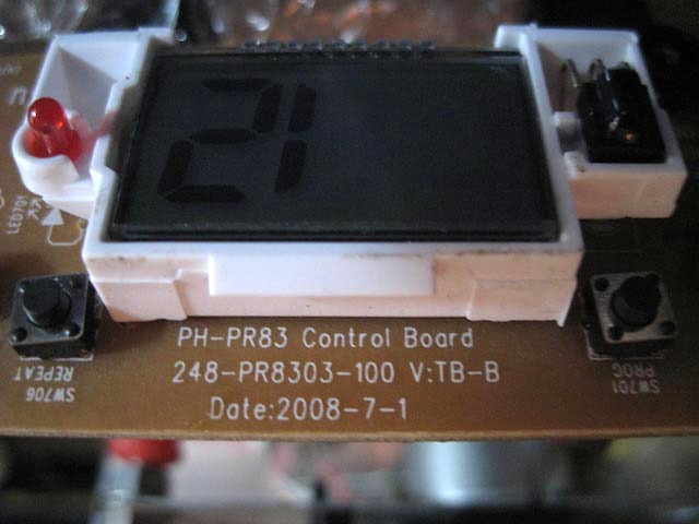

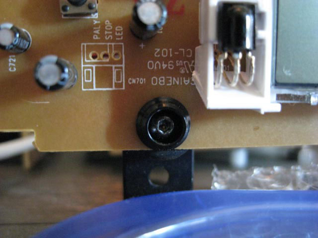

This is the display from the Sanyo donor unit PH-PR83(now discontinued).
The board is made by Cainebo out of Hong Kong. I am guessing the remote is bundled with it. The remote is the same as the JVC one (physically) This display has no backlight.

Can't imagine they would sell boards/displays in small qty... maybe they just made the pcb....
Just posting in case this is of any conceivable use to anyone.

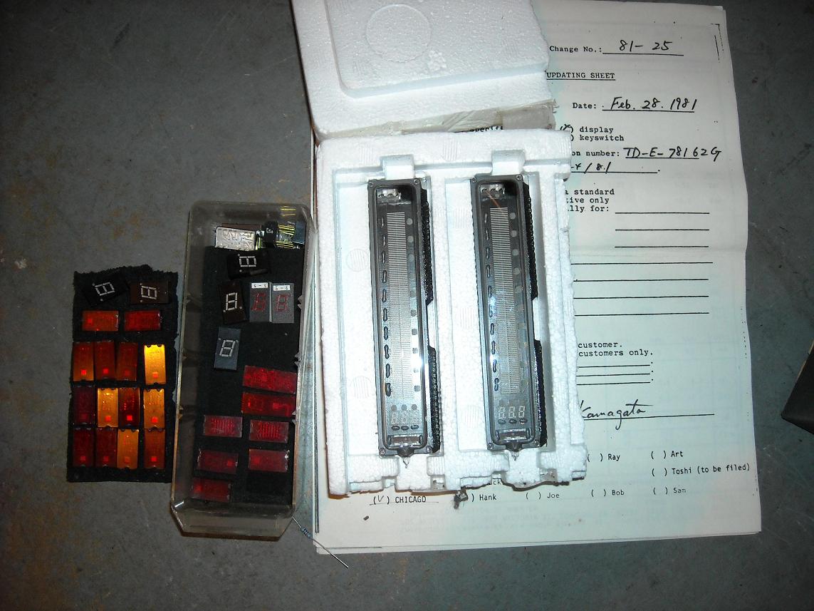

As slow as LED displays are refreshed, it should be possible to monitor the display output with a modern micro,and capture the segment drive, then use a look-up table to translate to another display output. I may finally have a use for some of these.
