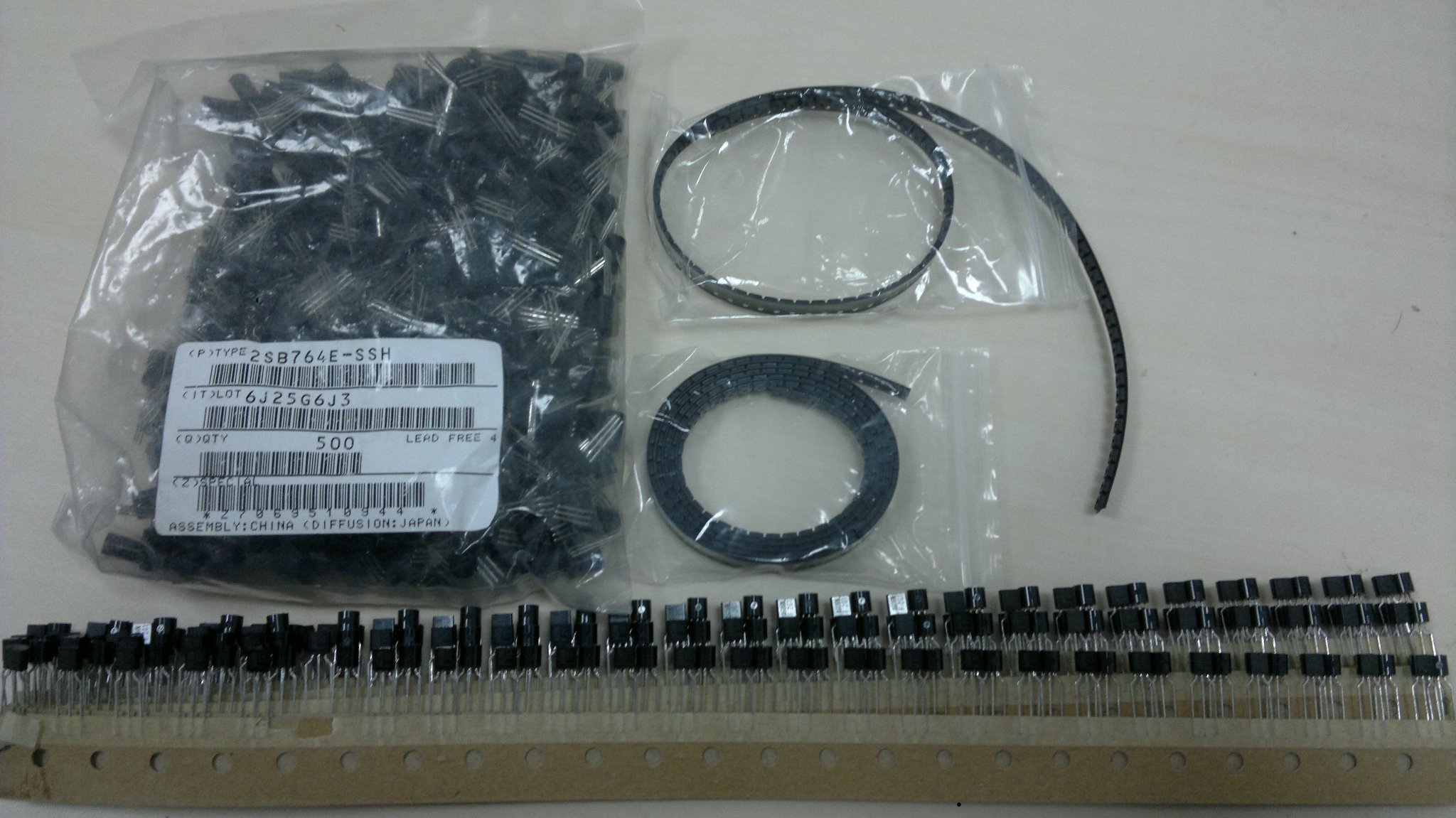

Transistors and low noise 2,5V reference regulator arrived today.
Prices are as follow:
2SA608NF - $0.88 or 0.66euro
2SB764E - $0.84 or 0.64euro
2SA1342 - $0.66 or 0.45euro
ADP151AUJZ-2.5-R7 - $1.00 or 0.76euro
Tibi
