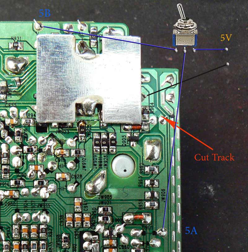

The 5v regulator layout for the shigaclone, is it possible you have it.
What voltage trafo do I need? 12-0-12? 16-0-16?
I can see peter did the one for his Nos Dac, and same was used on shigaclone.

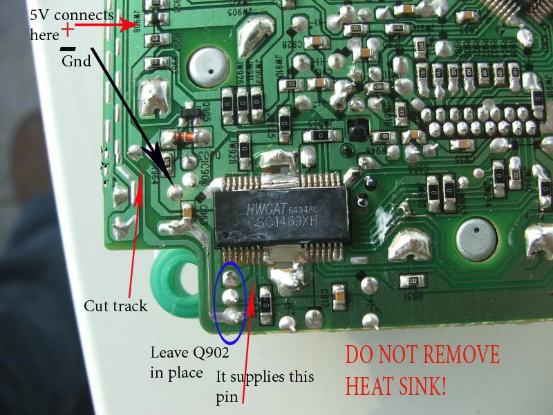

I'm in need of partlist and layout. I want to ad the 5v to the shiga. Also need some clue how to add it:) (somewhere I noticed it explained)
happy newyear.
Sorry, I missed your post - please see attached pictures regarding 5V connection. (search thread function is your friend)
You simply need a trafo that will provide enough spare room for the regulator drop-out... 12VAC (0-12 or 12-0-12) is a reasonable choice for most 8V regulators, you could probably use slightly lower voltage for the 5V reg.
The regulator Peter uses (the "Bobken regulator") is a rather tricky and highly-strung design - it's easy to mess up and parts are expensive or hard to get. If you are looking for something that can be put together easily, this is not for you, I'm afraid... :( You could try building other, more user-friendly super-regulators, or buying a ready-made one, such as Belleson super-reg.

Just tried building another shig.after successfully building one. brand new ec51 transport from the boombox, same minor mods, connected up to my black box 50 dac and there is a horrible noise (coming from the spkrs) like someone dropping thousands of ballbearings on a metal sheet!! the music output is still there underneath the noise.
I have scoped it and its about 1khz random(ish) sawtooth.....any ideas anybody?
