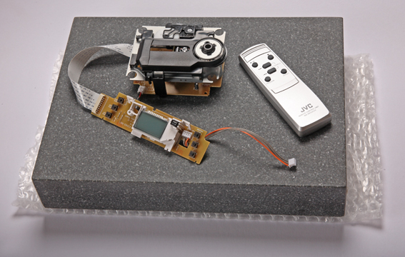

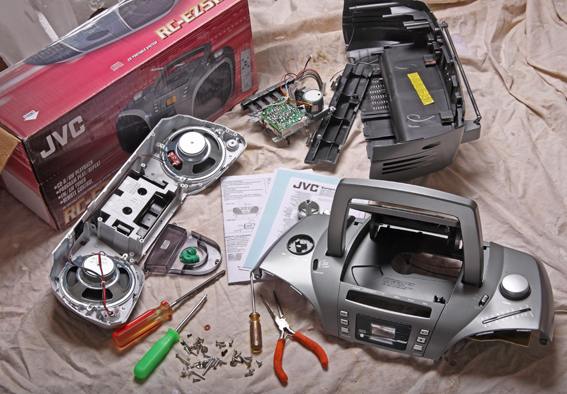

My nice new JVC EZ51H arrived this morning. It actually sounded pretty good as it came I thought:innocent: but hey, why am I here? Took me a while to find my tools and scrub the rust off the screwdrivers which have been dormant for much too long.
It took just over an hour to get this! aaah!

A bit like you I think, due to lack of high finance! (well any finance really).The Blackgate Caps are rare to non existent, due I think to the company no longer being in business? I am probably going to go for Nichocon FG or maybe the Elna Starget as an alternative to the caps. From what I read so far, (now up to page 195), the Peter Daniels mods are the core to a very good transport anyway and in terms of results for cash spent are probably some of the best in the DIY community for return on investment! I already have a solid base for mounting, in the form of a small granite surface plate. I will make a heavy wood base for the player chassis and have this positioned on the granite with three spikes, (the surface plate needs to remain usable, so no mods to this). I ordered an LM7808 yesterday. I am having a bit of trouble finding an MSR860 from a reliable source. One builder from England used an MUR860 but Peter replied to the effect that these are a different animal even though they do the same job. The recommended transformer was a Hammond but these are not available in 220v primary here in England, it looks like my best bet on price and availability could be a Toroid from RS Components although better would be what goes by the name of an E I Core but I can't find these. A better, separate regulator may come later for the 8V line. Another for the 5V is used by some with its own trans but I think I will stick to just the one unless I find some very positive comments. Peter also built a NOS DAC which works very well apparently as a replacement for the onboard. I will probably add this at a later date (if I can get my overdraft down enough🙂
What I need then and hopefully by the time the deck is finished will be something decent on which to listen to the music!
