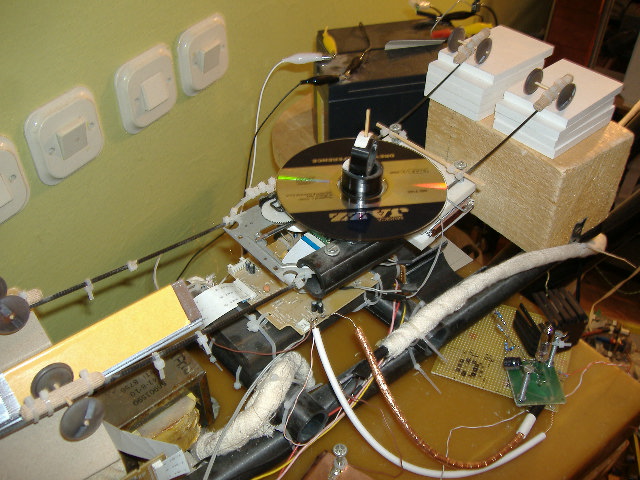

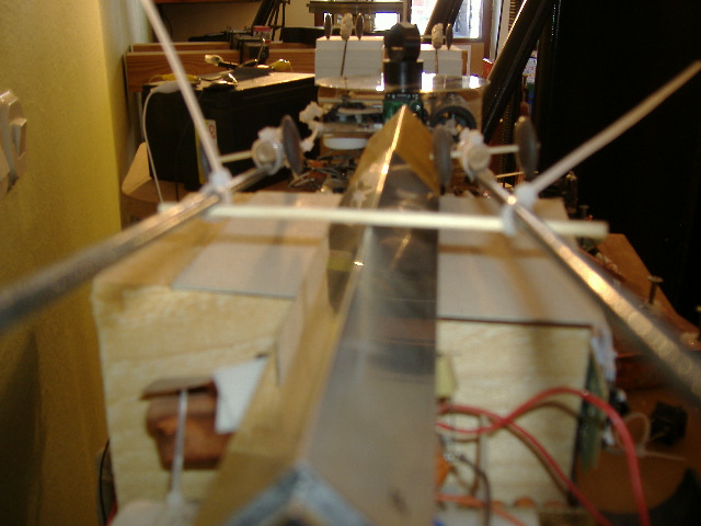

The two left wheels are not used.That side is placed on air cushion.
Ingenious and original. I like it! What is considered the "air cushion", the fact that the transport is suspended from the rods or there is a place on the left side (that I don't see) where there are no contact.

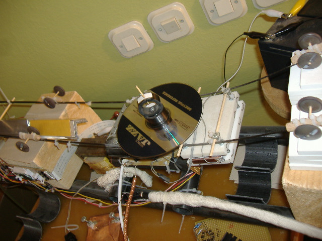

Thanks, I am glad that you like it.That aluminium angle on the left side is the air cushion but the air holes can't be seen because I have covered unused part with tape to make cushion more effective.Search for Terminator arm to see what kind of cushion it is.Decoupling is made through the rods but vibrations are compensated with wheels and cushion.Don't have plans to isolate motor because I have bonded both with thick layer of teflon tape with good sonic result,but who knows....The metal frame is clamped with two halves of carbon tubes attached together with screws.This is an infinite prototype since the new changes are coming often and I hate boxes because of sound degradation.Most of my system is without boxes.

This is a screw puck.It is made of carbon too.The mas of the puck is little bit less than one cd disc.I have removed the metal part on the plastic cd holder and inserted a carbon ring to make holder as rigid as possible.Puck can be made easy.Just cut one 12mm and one 15mm peace of tube and then make a 6mm thread on 12mm part so it can clamp that horizontal 15 mm part.The diameter of the tube is 28mm.You just have to insert a 6mm screw in the plastic holder hole.When you screw it you center it but you can miss some mm because it so light that it can't cause extra vibrations.It sounds better than plexy and magnet that I tried.I think that lower mass is what that transport need.I have tried hi mass transport configuration but I didn't liked it at all.That rod-air version is correct version to me.We can not eliminate vibrations completly so why don't control them here and there to find some intersinergy instead to kill them completly and some music by the way.
