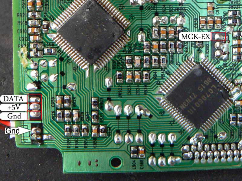

So, I guess your just using the door switch to power the unit on/off?
The door switch is used to read table of content (TOC). It needs to be permanently shorted and opens only to read TOC. You can do without it, but the number of tracks won't match when you change CD. Of course TOC resets itself each time you power on the unit.

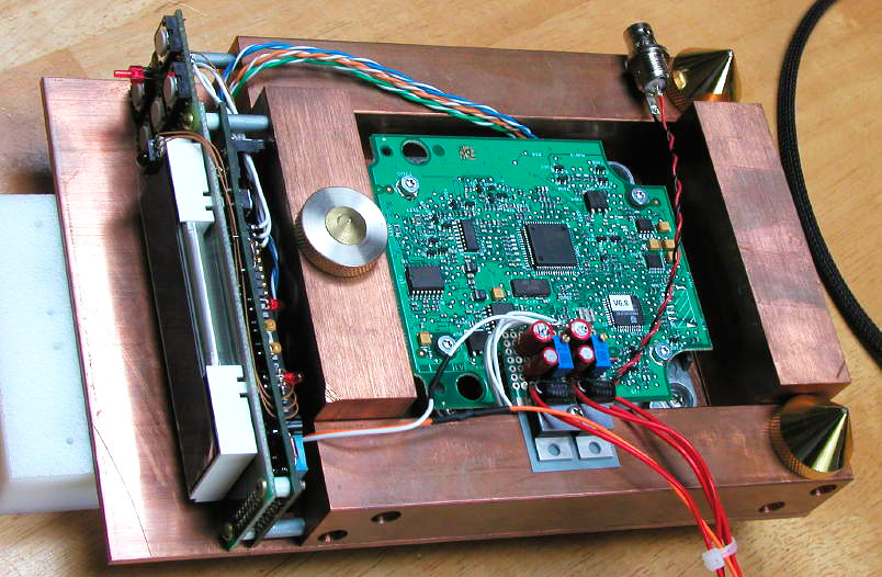

Just wondering, can mechanics/mounting/chassis be too stiff/rigid if mounting CD mechanism with 2 bolt like suggested here? Is there overkill in this (that kills the sound)? I have >12kg of copper to start.. and enough lead and sand. 😀
Having a screw on clamp is nice, but this is not critical to the sound of the transport, it certainly provides some improvement but there are so many other, more efficient, ways to improve it as well.
One way to try how much elimination of magnetic clamp improves the sound is mounting CD without it, using only a piece of paper to secure it: http://www.diyaudio.com/forums/digi...transport-shigaclone-story-9.html#post1477918

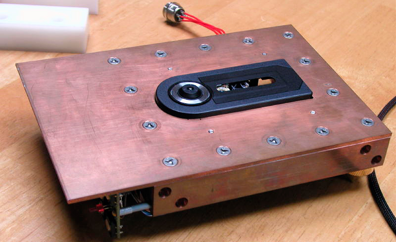

If you are asking if it can be overbuilt, I'd say yes. I've built this chassis: http://www.diyaudio.com/forums/digi...d-transport-shigaclone-story.html#post1468060 attaching mechanism's frame and motors directly and it sounded rather disappointing.
That's why I asked.. but what if it's mounted only with two standoffs? Would that be ok, no matter how stiff rest of the chassis is?
I use a single standoff. I made some tests in the past with 4-3-2-1 standoffs and a single one was clearly the best in my stiff wooden enclosure, but you have to try with your specific enclosure. To avoid frame bending I use other two standoffs with one nut and a washer as stops. In normal condition the frame doesn't touch the washer.
What corner you use? Did you tried all of them? 🙂
I think I will try 1 & 2, thanks..
I'm sorry I don't remember. I'll try next week.
I beg to differ Peter.🙂
My experience is the opposite.
When mounting the weak and rather resonant platform on a sturdy base I experienced a lot of ease and quietness in my cd's presenting things with more resolution and more ...uhh..."foundation" 😛, meaning also very good results in the bass-department😎.
More specific advice a touch of ebony with all this "overkill" copper works as well.......giving the instruments more colour/timbre.
To avoid any voodoo reactions here, you can read stuff when you google for Mpingo ebony or Tone wood and decide for yourself if you want to explore this any further.
My point is not to disagree with Peter but more to encourage the really curious people to try everything out with this contraption..THE POTENTION is there...!!!
You beg to differ that this particular chassis sounded disappointing to me? How can you explain it? 😉
Here you have the advantage of me conversing in english being a dutch speaking dude...hahahaha 😀
Ofcourse you most definitely are right on your statement.......but you must admit it stays a funny phenomenon that people experience things different...😉
To show what I did with copper and ebony with the results mentioned (in my situation) 😉
I did similar things in a past, and so what; it just didn't produce results I was looking for. Don't get me wrong, I'm not discouraging people from going into extremes, but it's not easy to find successful combination of materials and structure that works really well; simple overbuilding does not guarantee success, at least not in my experience.

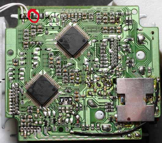

I have lifted this pad. Can anybody suggest a good place to pick up a connection?
Door switch Ground.
Door switch Ground.
That's what I tried but I still have a problem. It must come from something else so I'll just have to keep looking. Thanks anyway.
