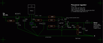

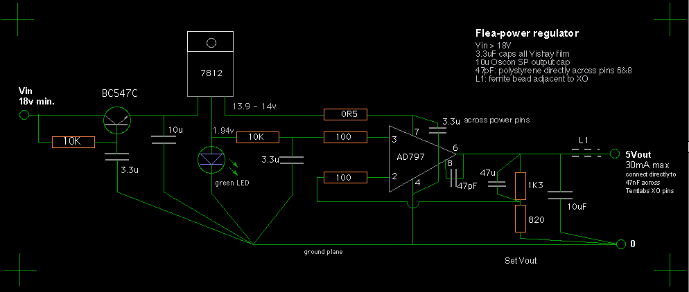

IMHO no clock is better than the power supply feeding it! Check out the "Pink Fish Media Fly" Ultra clean with almost undetectable noise floor, this is what you need to feed your clock.
Shame on you audiojoy was that a racist remark!
hotiron said:IMHO no clock is better than the power supply feeding it! Check out the "Pink Fish Media Fly" Ultra clean with almost undetectable noise floor, this is what you need to feed your clock.
Link?
Dan
hotiron said:My apologies its called the" Pink fish media flea" You need to join to get access
Schematic here
Believe me I have checked this **** out and it rocks!![]()
