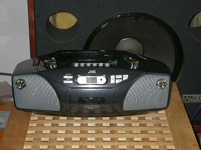

Can anybody check the current consumption?
I only get the 7808 in 1A, Peter´s 7808ct is the 1,5A model.
THX, Carsten
PS: in whole Europe/EU you can get the EZ31 here: http://www.schlecker.com/
PPS: my boombox just arrived:
THX, Carsten
