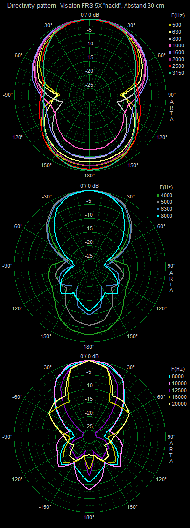

So no back radiation for HF at all? That is, dipole up to 'X' kHz ?
Back radiation rolling off above 4 kHz. No competition for the Neo3 of course, but only 12 % of its price in Germany.So no back radiation for HF at all? That is, dipole up to 'X' kHz ?
Off topic, but I wonder if you could add a Dayton or similar tweeter in the back to help the back radiation of the Visaton - since both drivers wouldn't interact very much at 4kHz?

Usually back to back tweeters are a mess, worse than a single tweeter. I would try using a backfiring tweeter, say 5kHz and up, and not placed close to the forward tweeter. That might work well...

I have to ask you guys a question: Does equal front and back radiation through the tweeter range sound natural to you?

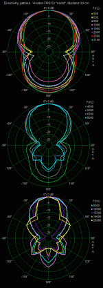

I have two Daytons (but I haven't built them to play at simultaniously yet) and their back to back config seems to require a notch to tame the polar bulge anyway - as Rudolf kindly showed in his measruements.
The Dayton-Visaton combination might be smoother. 🙂

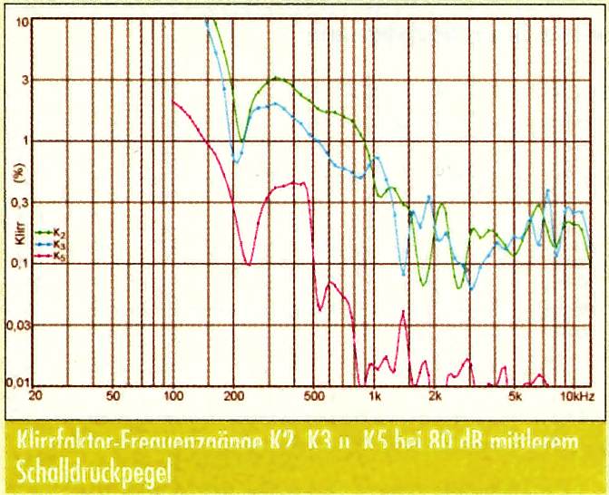

I haven't done own distortion measurements yet, but the attached distortion diagram is for the standard FRS5 driver, done at 80 dB. My interpretation is "no lower than 1.5 kHz".How low can the Visaton be crossed?

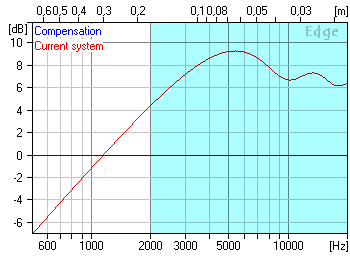

When I simulate the dimensions of a naked FRS5X in EDGE, the response looks like the second diagram. It reflects my experience, that when crossing at 2 kHz I don't need to push the lower end of the response - just EQ the dipole peak itself. There is added EQ to straighten the response above 8 kHz.
If done right, yes. But you should not try it with a separate tweeter on either side of the baffle. That will easily result in the infamous Klingon battleship polar response. Perhaps the smoothness of the polar pattern is more important than the balance between front and back.
I asked because I tried the Neo8s and it felt like there was too much sound radiating to the back... just did not seem natural. Sometimes, it is good take a step back and understand whether what we are trying to do is actually a better solution.
I've never noticed a problem with the neo 8's. I guess it depends on distance to front wall, baffle width, etc., to compare apples to apples. I'm currently running 2 per side, with a medium narrow baffle six feet into the room.
